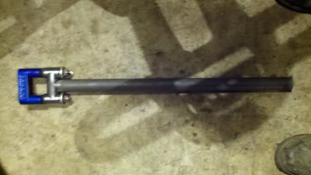

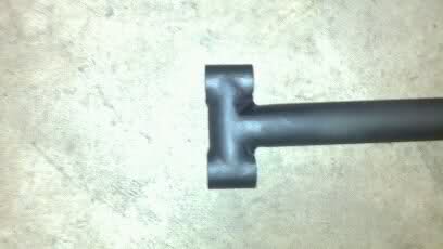

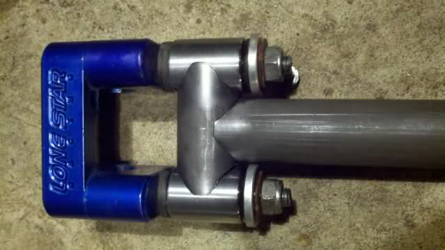

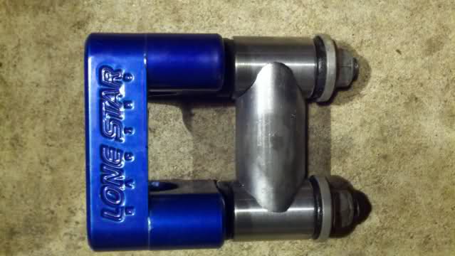

got home today and had some goodies come in the mail, got the pieces from lonestar and got the chromoly tubing in so i got right to work when i got home and this is what i have gotten done so far. a tubing notcher would make this hella easier. if i had a welder it would be done tonight so maybe tomorrow. what do yall think?
Most tubing notchers wouldn't be able to grab that short a piece of tubing to notch it. You could make your own clamp if you were trying to cut only 90" pieces that short but the stock configuration cuts pieces about 5" long. ;-)
For not having a notcher, the grinder notches look really good and fit nice and tight. Shouldn't have any problems with those joints. Who's going to do the welding and how are they going to do it?
well could u leave the tubing longer and make your marks and notch the very end and then just slide the pipe in further to your next mark and just cut into the pipe for the next side? ive never used a notcher so im just guessing on that but it seemed like it would work. its a pain in the arse grinding those and actually keeping em straight but they came out pretty tight i think
ill be doing the welding SUPERVISED by a buddy of mine that is a pipeliner by trade, i really want to do all the work myself or atleast all that i think im capable of. to keep it all square well will tack it all together and then tack it down on a piece of metal to help keep it from warping and most likely wont be welding much at a time to keep it from heating up too much. u got a better way?
thanks!! its a pain using the grinder to notch but it gets the job done
yea but you got a nice good tight fit and i looks good too, real good job, id say it was worth the time in grinding!I:I
and it looks almost just like my SMS +2 stem i had on my blaster
if i didnt know this was homebuilt, id say it was aftermarket quality
