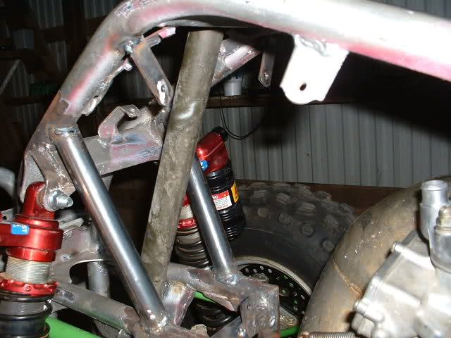

got a 2001 yz 250 for my blaster

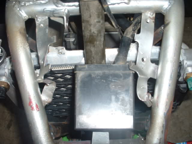

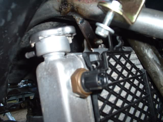

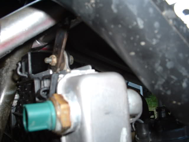

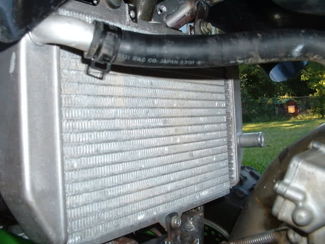

FINALLY!!!!! got the radiator in the mail today and the guy wasnt joking it looks practically new i dont think it had one fin bent, so i got right to work on the mounts and got er mounted in. but im gonna have a problem with the lower rad hose its gonna have to be a hard 90 to clear the pipe. it also clears my fenders everywhere so no rubbing.

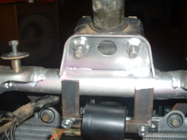

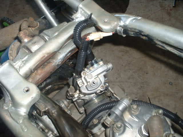

made the coil brackets today and wired up the whole harness to make sure i didnt have to shorten any wires but they all fit good so im gonna leave the harness the way it is. i found the kill switch off the dirtbike so im not gonna try and use a key. i still have to make a front plate for the brain. i still have to cut all those front brackets out because im not gonna be using any of em
