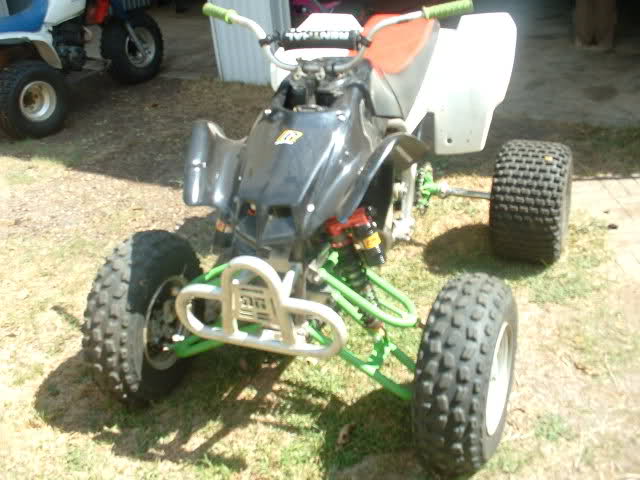

got a 2001 yz 250 for my blaster

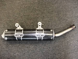

i just won this silencer off ebay for cheap, so now once it comes in i can finish up everything and all i need is a rebuild. its a dpm silencer never heard of it but it will work for now until i can buy a complete exhaust for it.

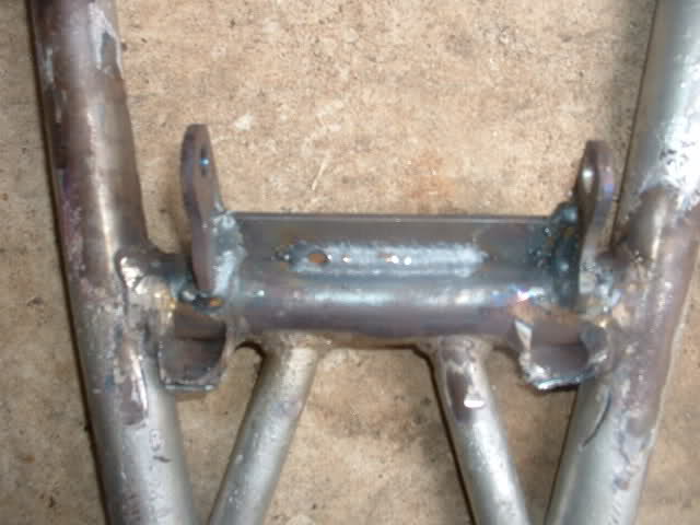

im ready to be done but i cant seem to get any friend that owns a welder to take a little time out of there day to let me roll over and just tack the rails up. been 2 or 3 weeks now since ive had all the rails made up so hopefully soon i can get some welding done

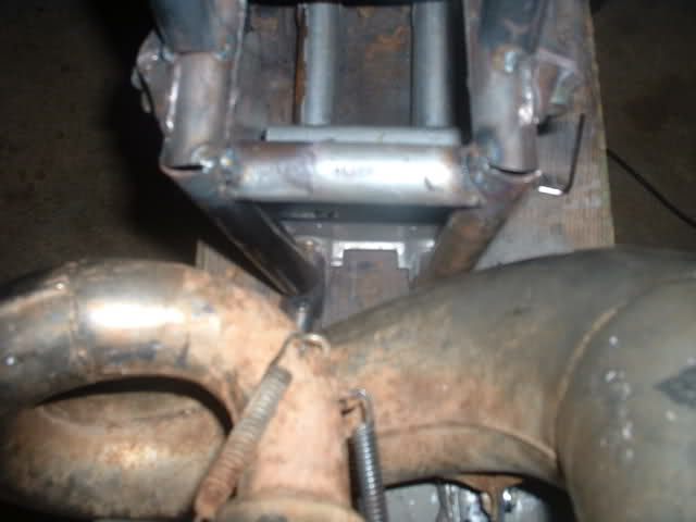

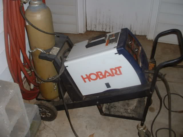

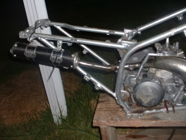

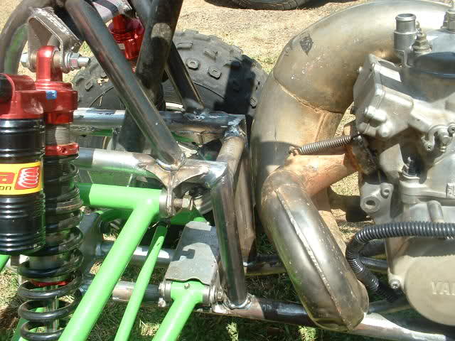

i got some goodies in the mail this week. i got the dpm silencer and the front pivot tubes from jj and a for the swingarm and im still waiting on the radiator i picked up this week. also my dad came through this week he got a helluva deal on a hobart 175 welder needless to say its sitting in my shop for now lol. finally got some welding done late this evening just tacked it up for now i want to make sure everything fits just right before i weld it up solid. put the silencer in and zip tied it up close to where it needs to be i wont have to do much modifying to the pipes to get it to fit....here's a few pics

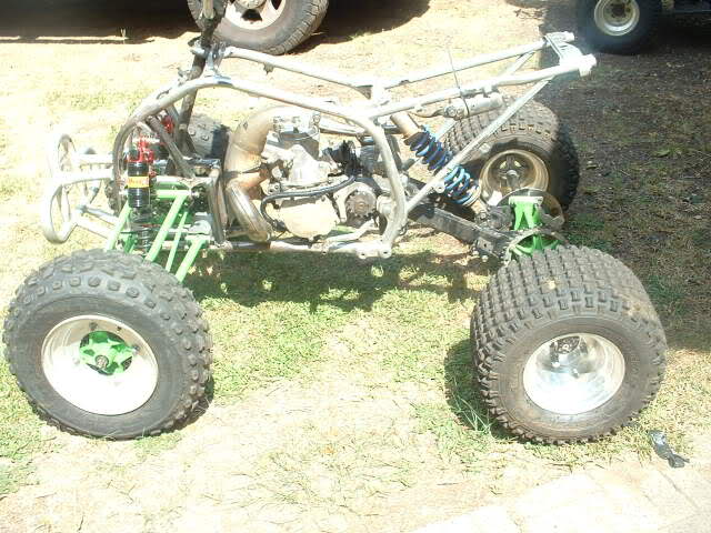

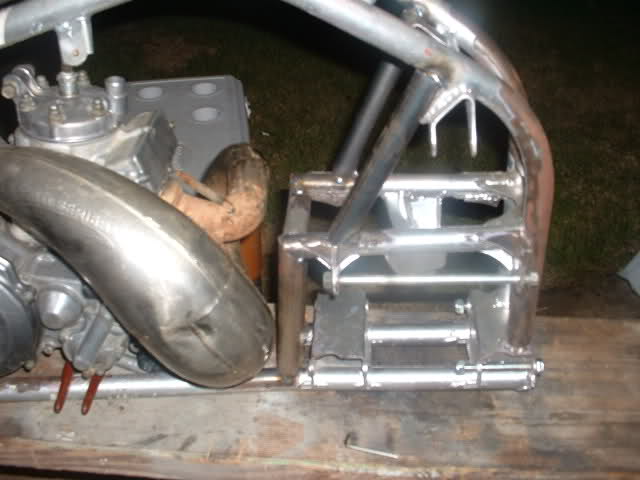

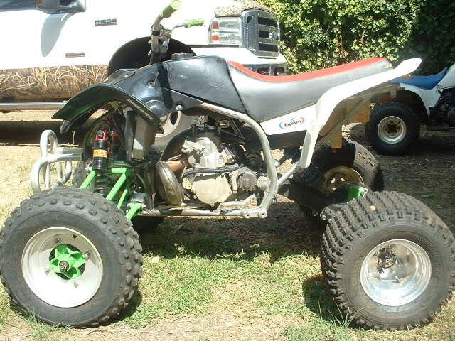

i have a rolling chasis now. welded up the rails and welded in the lower motor mounts and test fitted everything and it fits really good. im still waiting on the radiator in the mail but that can come later. gonna try and get some work done to the exhaust today to make the silencer fit. im thinking ill be putting on the yfz style rear fenders in black later on i think it will set the bike off really well

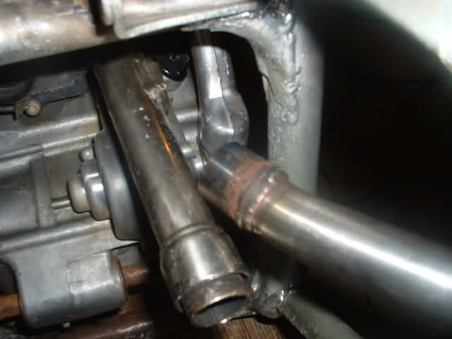

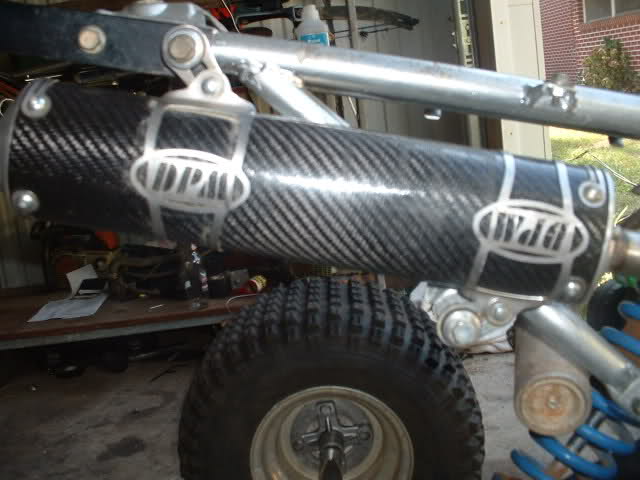

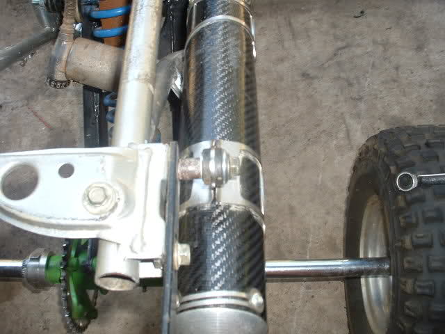

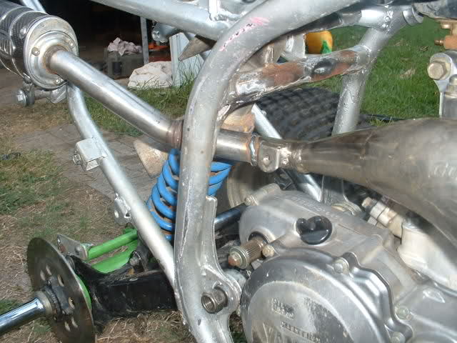

man did i buy the perfect silencer to fit, this sucker fits on the stock mounts. i loosed up the mounts on the silencer and they will slide up and down for different mounts so i got it to line up just right with a couple spacers man its getting real close. u can see in the second pic the spacers i used to get it away from the frame. i had to flip the front bracket upside down to get it to mount up to the front silencer mount

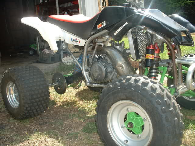

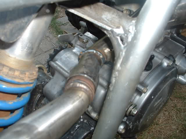

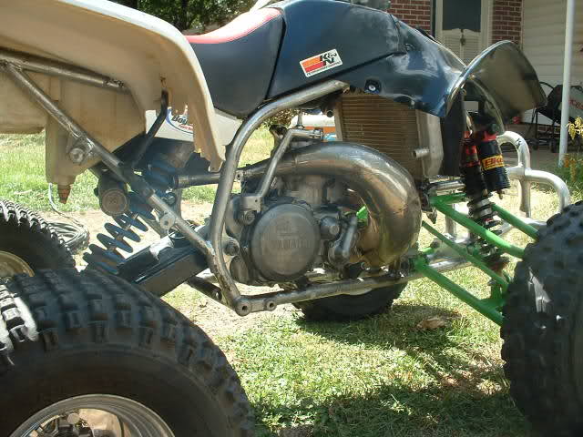

got the exhaust done, only had to make one angle cut to make it fit all i have left is one more motor mount and radiator mount and then all i will need is to get the motor built and she will be ready to rip.
