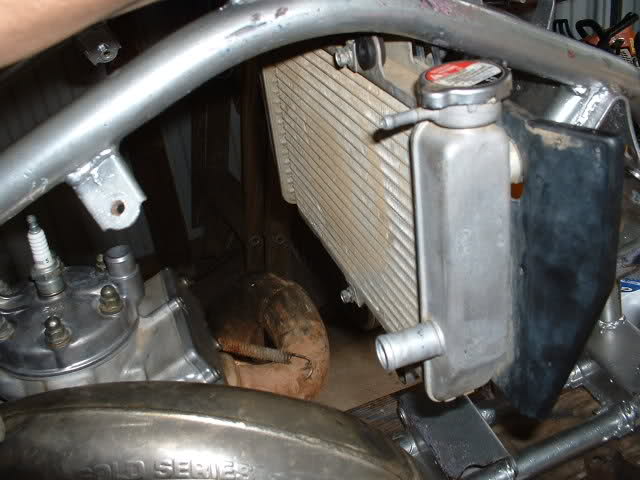

well i was getting rid of all my blaster stuff but ive decided im gonna keep all the aftermarket parts and finish this build. it still gonna be a long project because im building the yfz too unless i win the lotto lol. anyway i got to messing with it again and all the mounts i have made so far im just gonna scrap em. i ended up cutting the frame rails out and i am gonna make some changes so i can fit my pipe in without modifying it, i dont want to change any characteristics of the head pipe although i will have to make some changes to accomodate the silencer but no biggie. as far as the motor mounts i think im gonna try and make some that have a little rubber in them to try and help out the vibration and gonna see if i can get anyone around here to machine my case and make me a rear motor/swingarm mount out of rubber like yz otis's motor, gonna have alot of time to do it so i might as well do it right the first time. i also took the radiator off the yfz and im gonna make some mounts for it. i think its a little bigger than the other radiators being used so it might help with cooling a little better. im also gonna be building a extended roundhouse swinger kinda like the one callmej built and a long travel rear end with a little help from the godfather lol. its kinda went from just a motor swap to a full rebuild. anyways here is some pics of what i been tinkering with this weekend. hopefully next weekend ill get to get some rails cut, fitted and welded in.

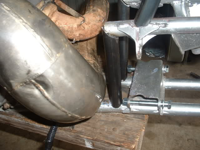

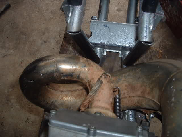

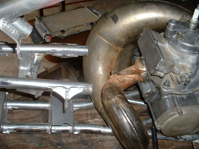

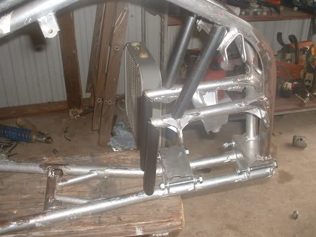

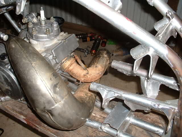

made a little more progress today, i got the front rails cut and shaped to be welded in just gotta make it over to dads and use his welder. i have to invest in some tools its hells making mounts with a hacksaw and a grinder lol anyway here is a pic of the front rails they are just laying up there and fit a little better than they look
