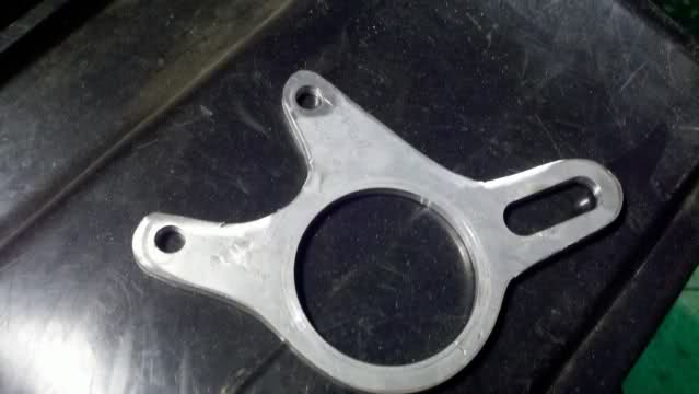

cut out my brake plate from the piece of aluminum today and now my yfz 450 caliper fits just great, no extra brackets or spacers. also got my 2.5" piece of aluminum pipe in today so i got my cfm airbox to work. angle took me awhile to get but it will definetly fit right now, now i just have to get it to an aluminum welder to finish it up.
brake plate i built, cut it out with a cut of wheel and a grinder. i still have a little bit of shaping to do on it then its gonna get a good polish
went from this
to this

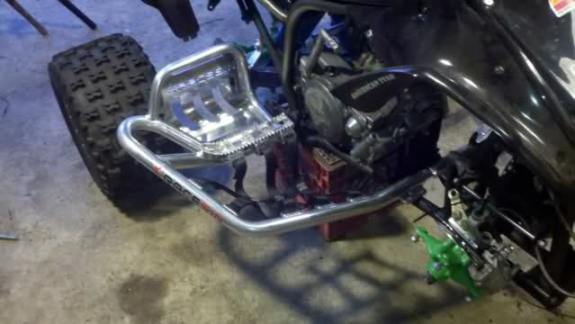

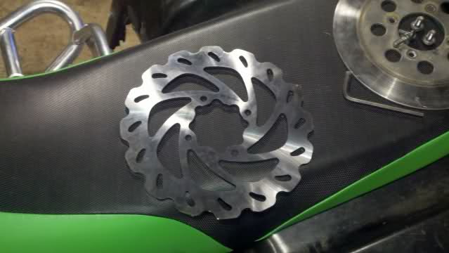

got a few parts in the mail today, racesin nerfs with integrated heels guards, brake clamps and a rear rotor. wouldnt you know it the nerfs are gonna have to be modded up to fit right because the bars come into the frame right where the pipe is. im gonna have to cut some of the nerfs off and weld a tube on the frame for the nerfs to slide on and then just put a bolt through it. gonna have to shorten up my kicker because it hits the heel guard
nerfs look sweet, too bad they dont fit right
yeah its sucks, they would fit perfect if i didnt swap the motor. it will be an easy mod tho. just cut the end off the nerf and weld a small piece of pipe on the frame. hopefully my a arms come in tomorrow or saturday.
