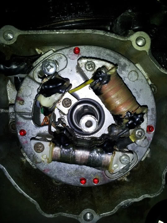

i really need to figure out a stator so i can run a cooling fan and some lights....anybody have any ideas or who i could contact to help me figure it out??

I'm going to try rewinding my WR light coil for more power. I can make a template of the metal plates & maybe you can make your own. The mounting bosses should already be on your stator plate.
They're gettin hard to find & spendy on ebay
Yam 94' wr250 stator [b-60] | eBay
here is what my stator plate looks like otis. do i need to buy the whole wr stator plate thats in that link? i have a radiator fan off a 06 yfz 450 that i would like to use because it has the mounts for it already on the radiator and it will be super easy to use. wonder if there is a way to use the wr stator and use a small battery to help out with lights and the cooling fan. cant you float the ground or something like that and use the sator to charge the battery?

here's a pic & some dimensions if you're considering switching to the older system. (Ya, the LED's don't belong there. Just one of my adventures) :)
wr250 stator info
stator plate dia. : 110mm
hole pattern dia. : 94mm
center hole dia. : 28mm
flywheel dia. : 100mm x 44mm tall (including shaft & rivet heads)
flywheel nut : 10mm
Trouble with photobucket ... pic is upsidedown now but may change ... lol
thanks otis, im looking into trying to locate some parts from a newer wr to try and make something work. keep seeing people talking about e-line accesories make a stator kit and runs 100watts but i cant find it anywhere. every link that people connect to the thread doesnt come up to anything not even sure they make it anymore.

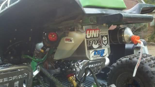

been having some cooling issues so i added a overflow bottle to help catch it because coolant aint cheap lol.....anyway bought a brand new radiator cap and added the tank and now its not leaking at all so i think i got it figured out. finally got around to cutting off one of the nerf mounts that didnt fit quite right and welded it back on in the right spot.
