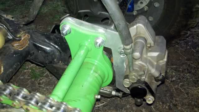

took it out for the first ride today and its a f'n beast....i could pull my buddies 450r pretty good. ran like a bat out of hell until it cracked the radiator. im a dumbass and made the lower radiator mount solid and it cracked right above that mount. so i made some new mounts for the rubber bushings and welded them in today and installed my spare radiator and will try it again tomorrow. also made a bracket to fit the yfz caliper on the stock carrier for now until i get a roundhouse swinger.

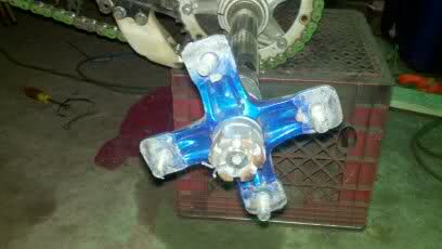

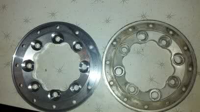

took it out for a ride last weekend and had a little carnage....been riding down the pipeline to our little track in the woods and everything was great until i got on the track. the is a little sweeping corner that i was hauling ass in sideways and apparently the left side lugnut had already worked off besides one and when i straightened up the tire went to wobbling like hell. before i could come all the way to a stop it had already wollered out the holes in the rim and bent 2 of the studs on the hub. walked back through the trail and ended up finding one lugnut.. hand tightened that one along with the one that was still barely on and limped it back in. thanks goodness that i can replace the aluminum center on the wheel or it would have been a disaster. got the replacement from hiper today and got that fixed now im waiting on another hub to get here....ended up getting one off ebay about as cheap to replace the studs. heres a couple pics. kinda hard to tell but you can see where the holes got wollered out and the studs got bent. other than that little mishap the motor is sooooo strong and feels like its getting stronger. ken did one hell of a job on the motor.
