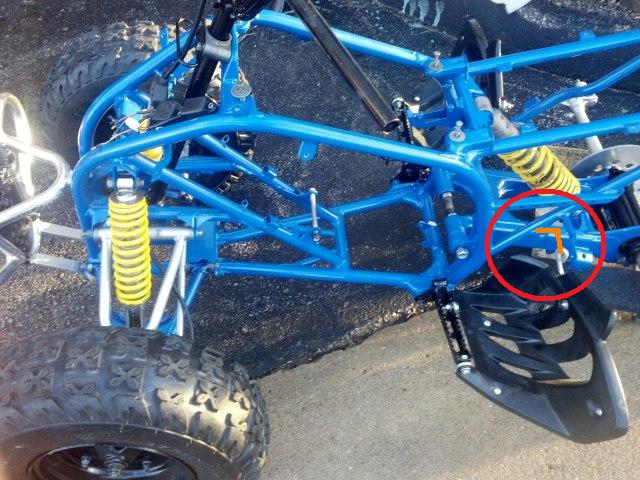

have you figured out about the L shaped brackets needed to connect the heels to the frame mounts ?
i've found the other side holds up better to the downward force of the kicker by going to the higher fender mount on the frame versus sideways to the stock heel mount.
and 3/4"w x 3/16" steel is the way to go, aluminum didn't hold up very long.

explain ? i'm tired of typing today, how bout i show ya instead :)
shifter side....
kicker side....
the fender bracket goes on top of that /\ mount, it and the bolt are missing from this pic.
it gives more lateral support from above for the force of your foot when starting the bike.
and you'll have to get used to kicking with just the heel of your foot, as these yfz/rappy heelgaurds lack the cutback of the stockers for space while kicking.

Ohhhhh I understand. Sorry about that.
