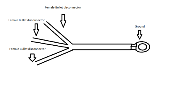

That what i do with all my grounds i connect them to a bigger gauge wire and ground it so i dont have 50 million grounds terminals to ground

I redid all the ground so each ground has its of ring terminal. Geting power from red/blk, red/yellow and red/white. But nothing from orange or anything after the cdi any other ways to check and narrow them down. Im not good at reading the manual on how to diagnose. Sorry.. learning disability.So it would be nice if you could explain how else I could or would narrow it down
