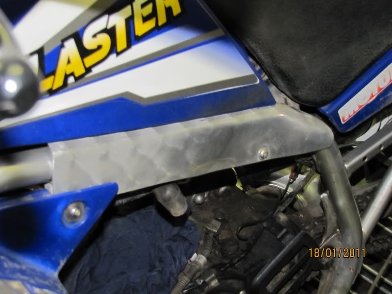

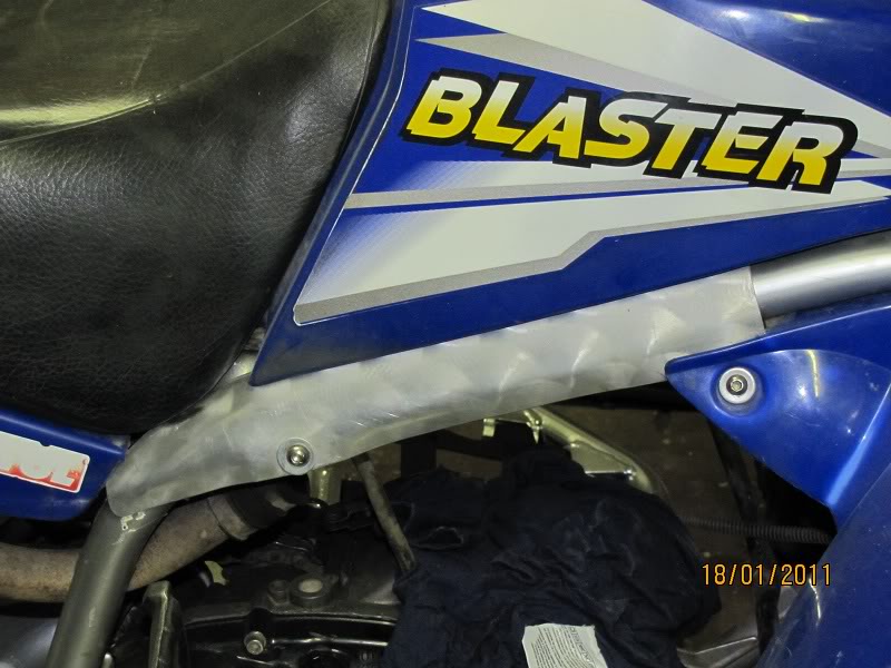

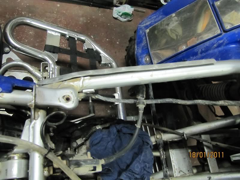

Hey! i got tired of my boots chowing through my paint on my frame, i even ate through duct tape over the paint as well as the paint underneath on one ride! it seems to be a flaw on the blasters design, the yfz450 for eg has the plastics cover the frame.

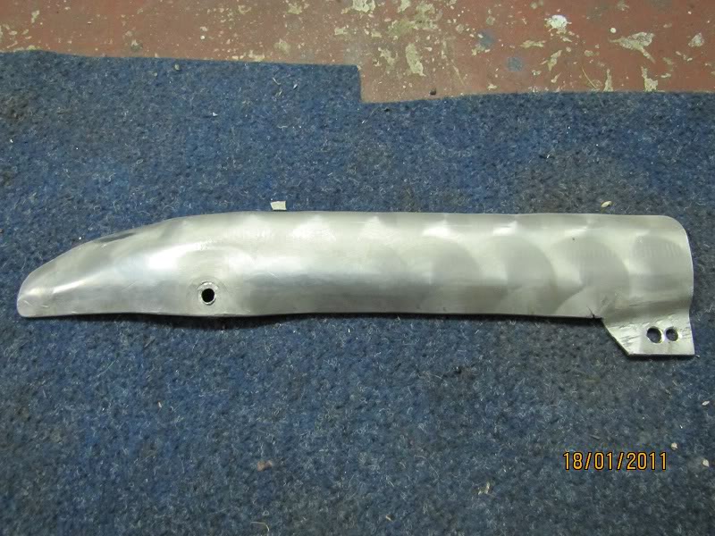

So, i made these quick quick... agreed, they could be a bit neater etc but i just wanted a quick fix, i may redo them to get a better fit at some time but they working!

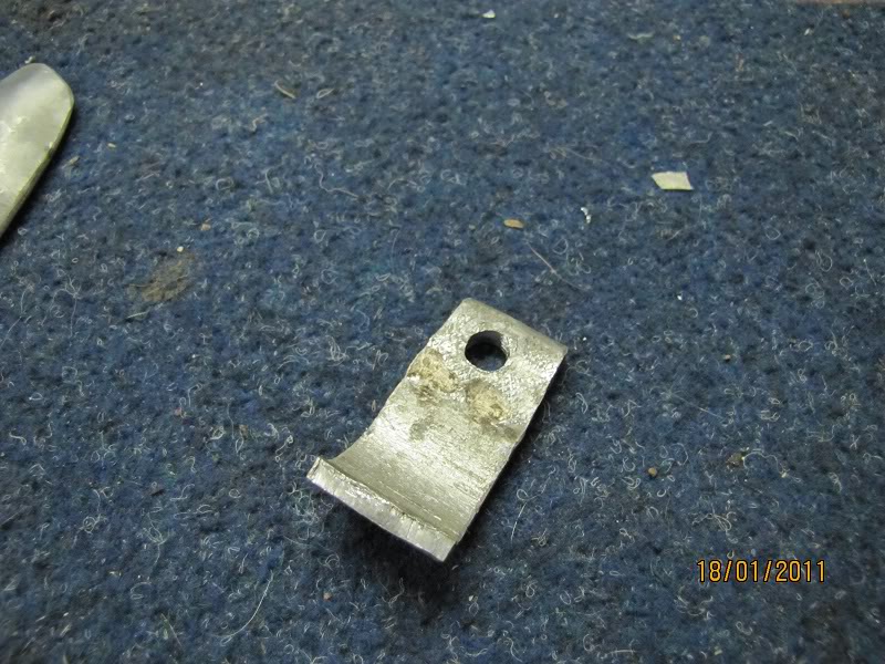

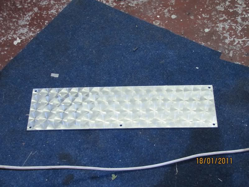

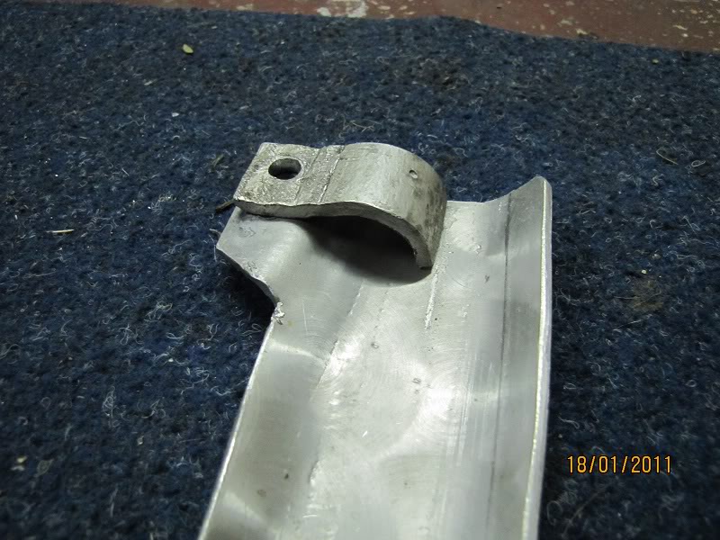

I made these little goodies out of flat aluminiun plate, i bent it around a bar of the same diameter as the frame tube.
This is what i used.

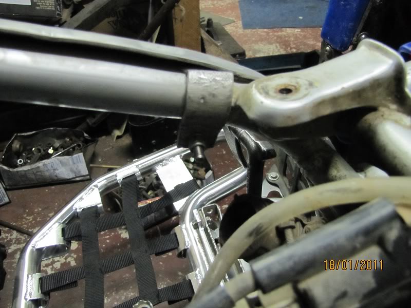

I used the mounting point of the front fenders as the front mount. the back ones needed to be thought out so i used the idea from the yfz450 GYTR a arms guards. I dont really like how the allen key head is right where my boot is but its not causing any damage. i put it there beacuse the frame has a joined in piece right behind it and it was most convinient for the mounting.
They arent perfect and could do with some rethinking but they work and hopefully spark off a few ideas with guys having the same problem! ;)
