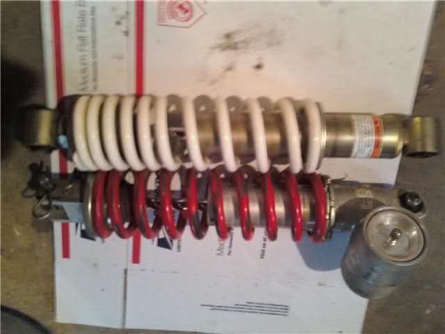

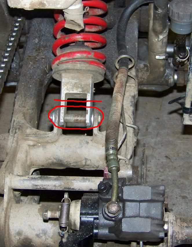

here ya go man, i couldnt figure out how to send pics thru a pm.... if you need any how to tips just give me a shout, but its pretty easy. I:I

you should cut the bottom mount down a little and it damn near the same length as stock
here is my 400ex shock with the bottom mount cut down and new hole drilled, next to a stock rear....they are the same length
Reactions: super noober
never occured to me to trim it down, nice job! although i like the slightly raised look so for me i like it as is but thats a great tip for those who dont. +rep 4 u!!
thats the same way I did it, I just welded the right thread/size nut on there and screwed it in! fits perfect and has held up fine so far. Its ghetto but there wont be any play
we put a few correct size washers in the middle to close up the space then welded the nut to the outside. so im 400ex shock for life lol, if i ever upgrade ill need a works shock for a 400ex. I:I
