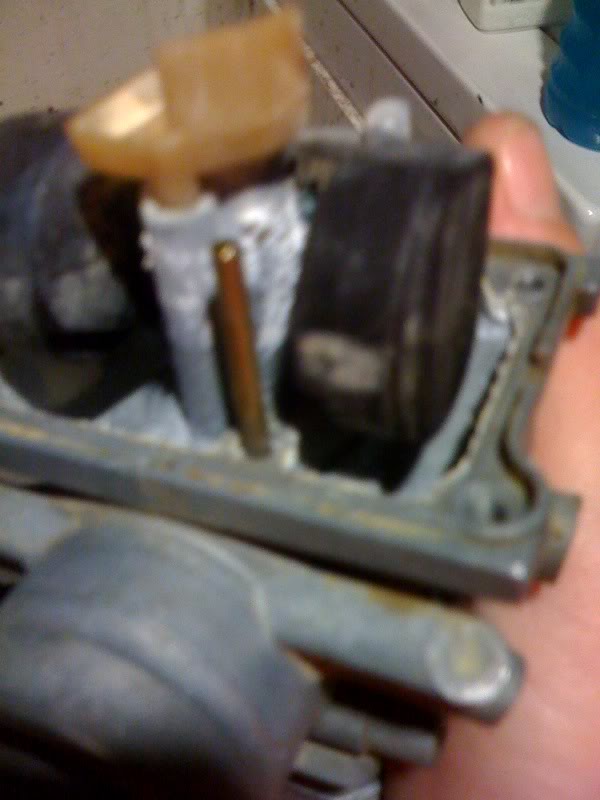

Is there a trick to getting the float pin out. I took my carb apart today to clean it and it was a mess so I ordered a rebuild kit. I just cant seem to get the float pin out.

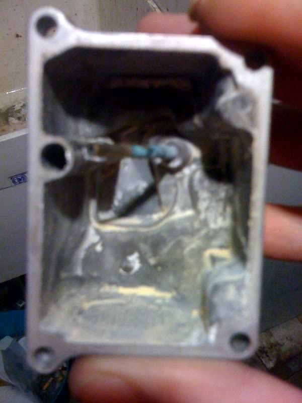

I did that here is what it looked like.
damn bro.that doesn't look pretty.Piston in backwards,carb junked up,what next.lol
I hear you bro. It just seems like one thing or another LOL. But I am not going to let it beat me LOL.
I dont know how long this thing sat before the decide to sell it. Its all good thought its getting there. LOL
Its going to be getting a nice couple days in a gas bath....
Try leaving the carb. body in some Berryman's Chem-Dip. It comes in a paint can and can be bought at the local auto parts store. This stuff works wonders on nasty carb's left submerged for a few days!
ive used tiny finishing nails to CAREFULLY tap the pin out. take extreme care when doing this though because you can easily break the arm that holds the pin, also i think it only goes in one way due to one side being flattened out.
Yah I got the pin out with a punch and some tapping came out just fine nothing broke. Noob are you sure it only goes in one way.
