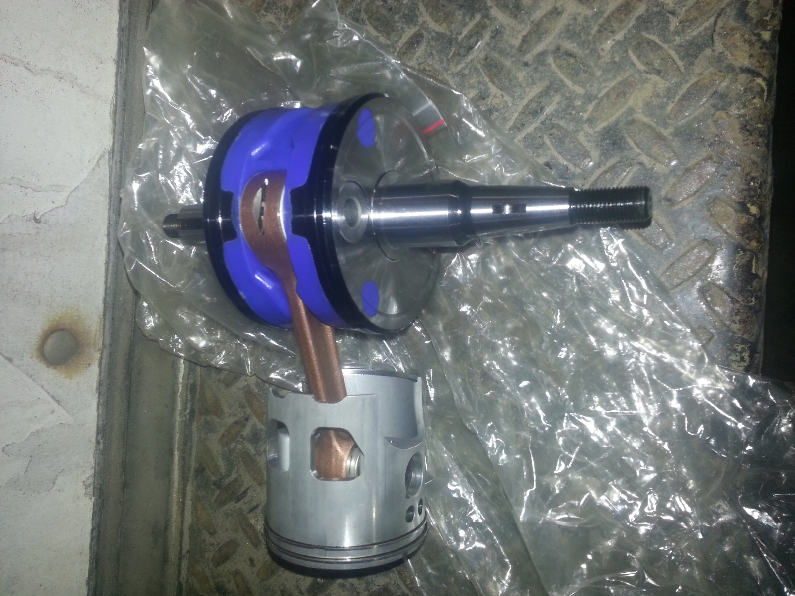

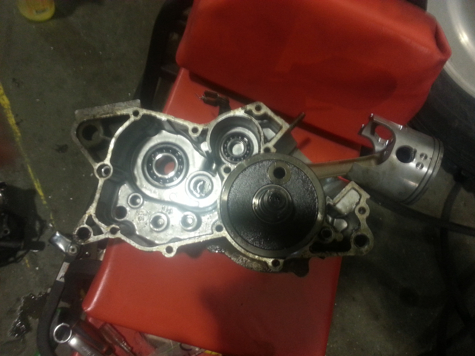

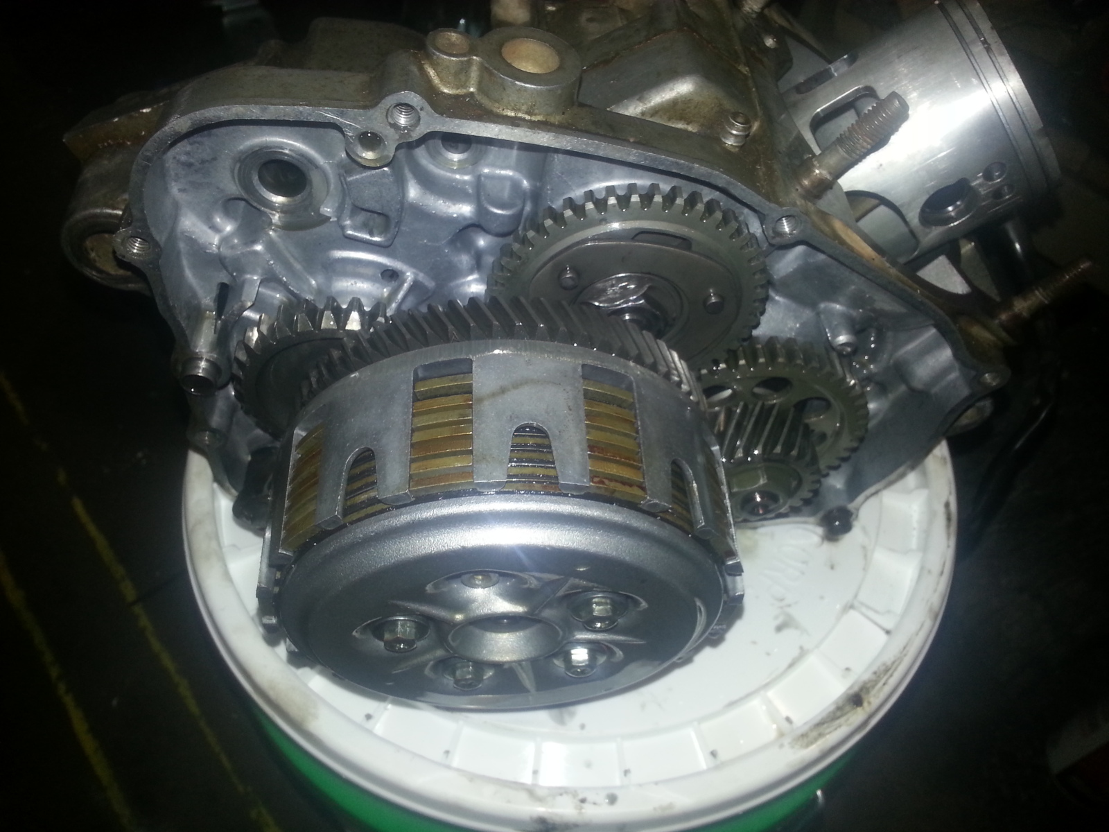

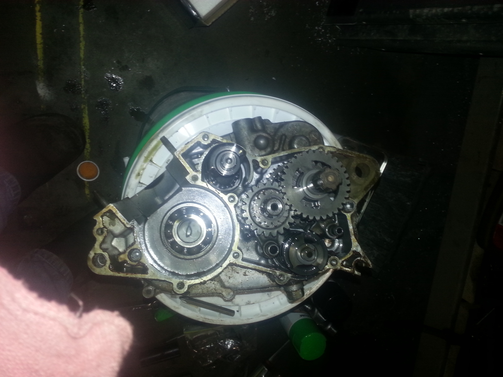

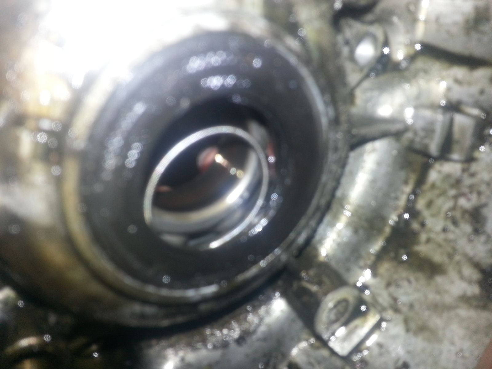

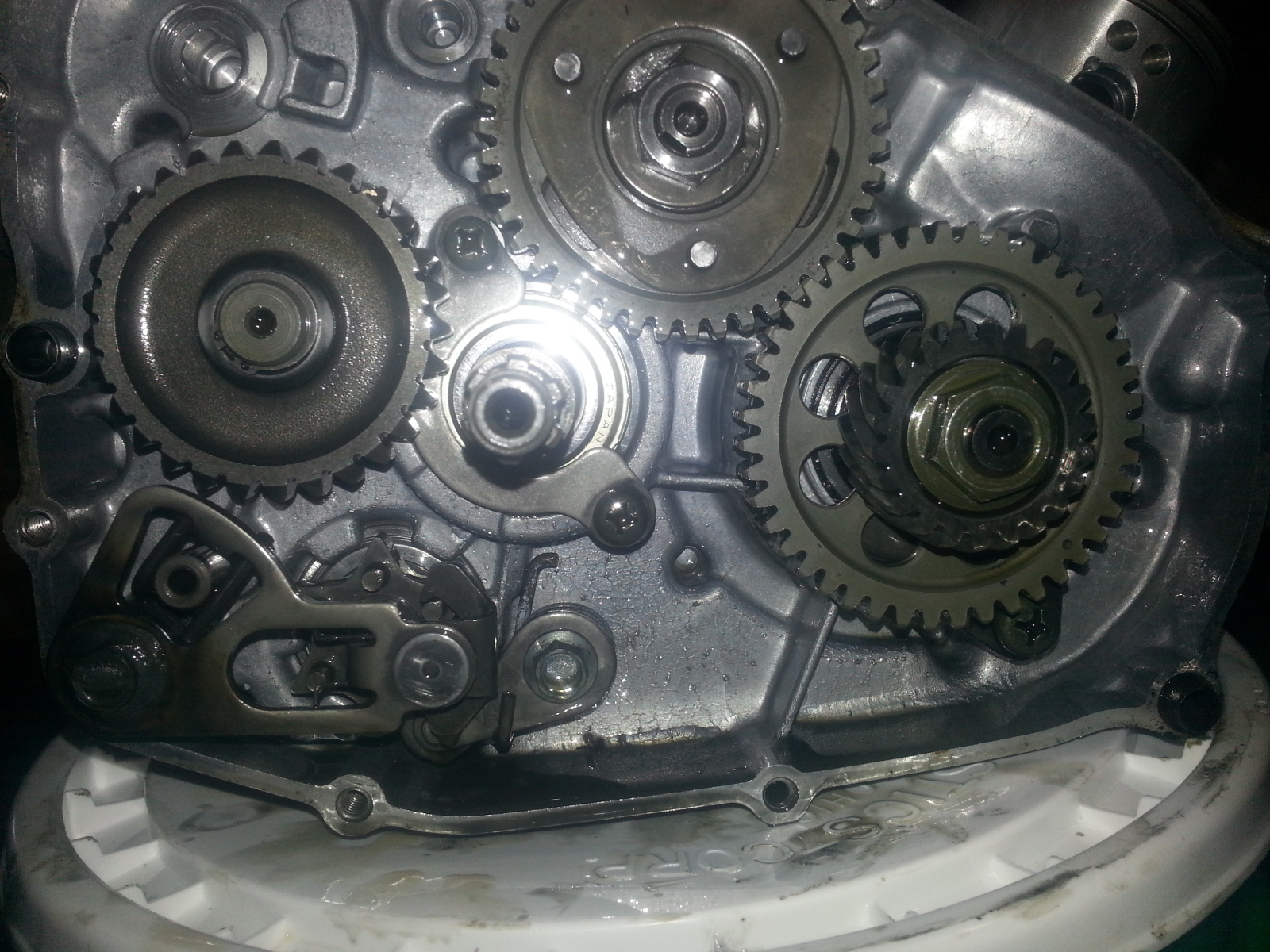

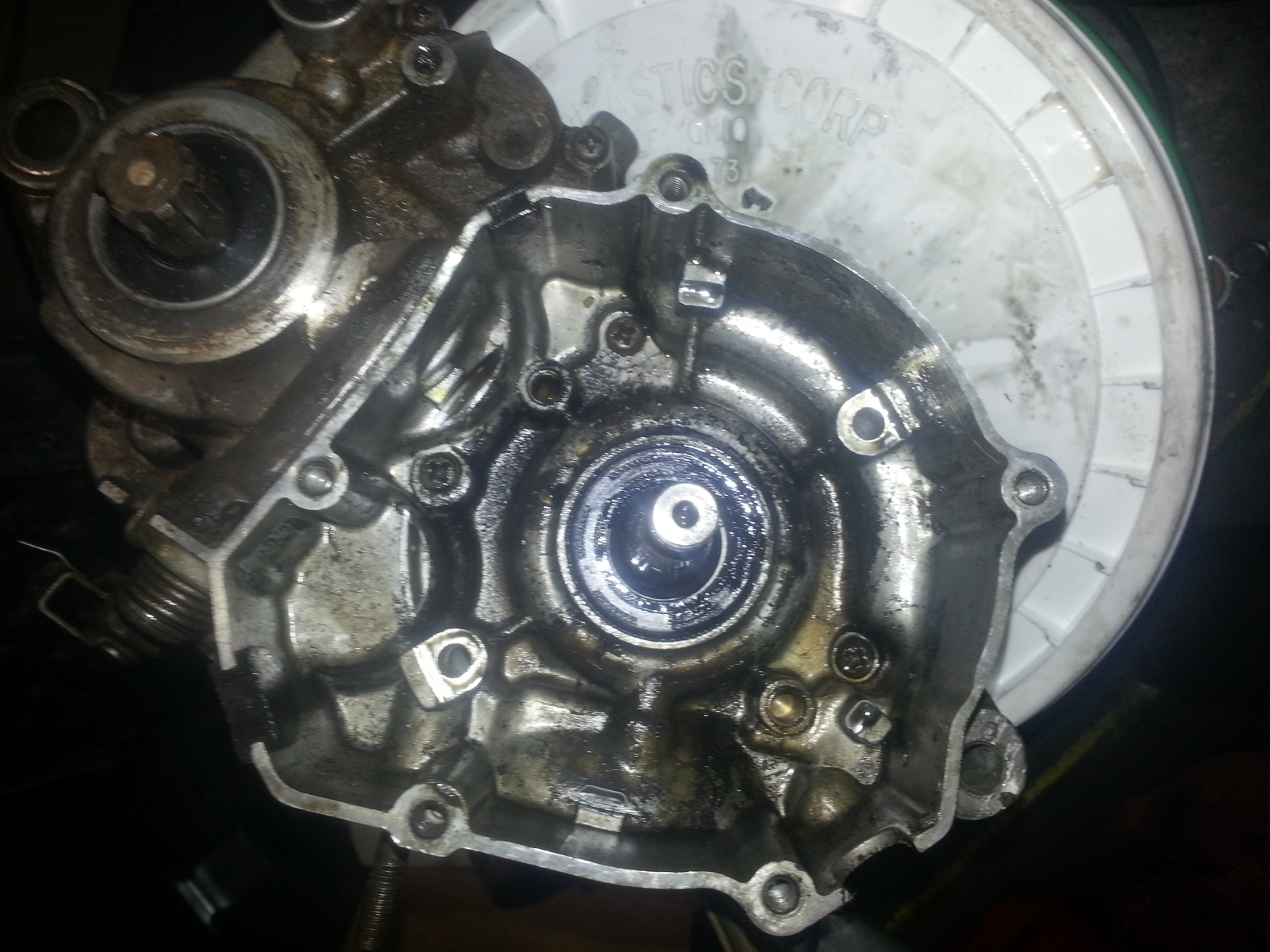

alrighty got the case sepperated everything is just about out. only thing left is a snap ring that holds the transmission in. the only tool in this damn shop we dont here lol.
o and does anyone have so spare bolts layin around
