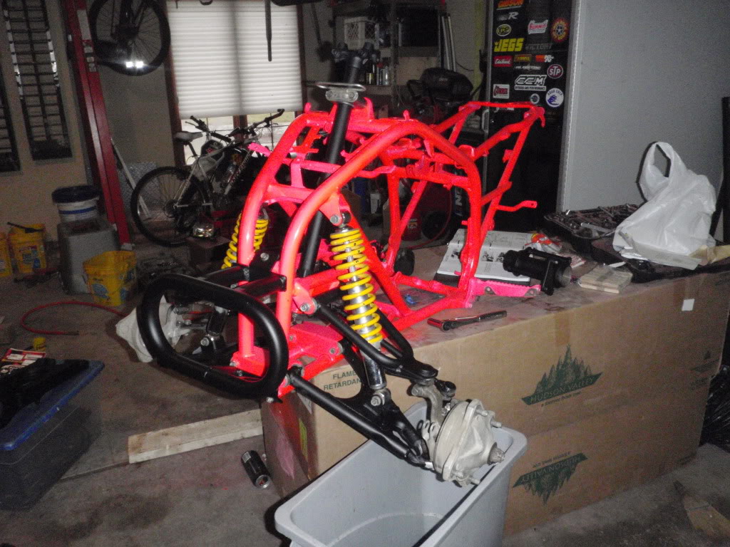

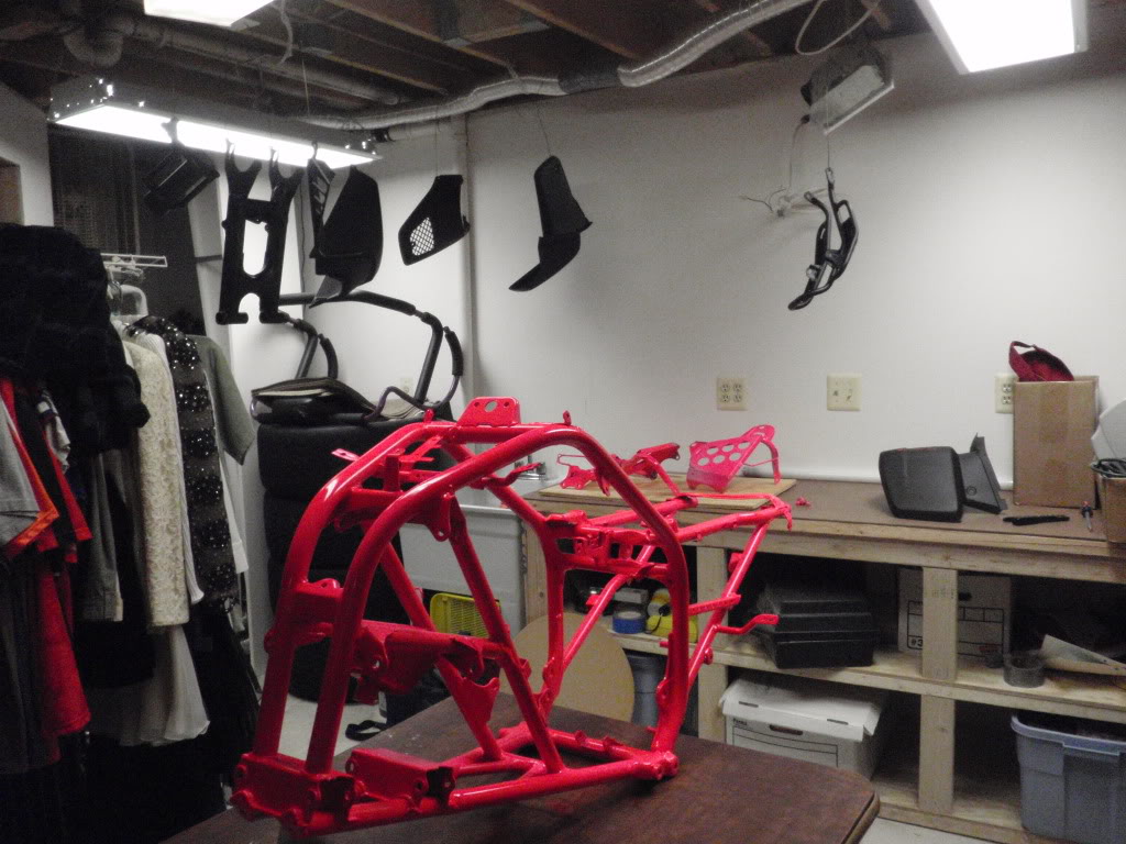

The plastics just got 3-4 coats of Kyrlon fusion paint... specifically for plastics. We just degreased the plastic and sprayed, no sanding or primer.
The frame was sprayed via a gun, House of Kolor neon pink. 2 coats of white rattle can primer 3-4 coats of pink and 3 coats of clear.

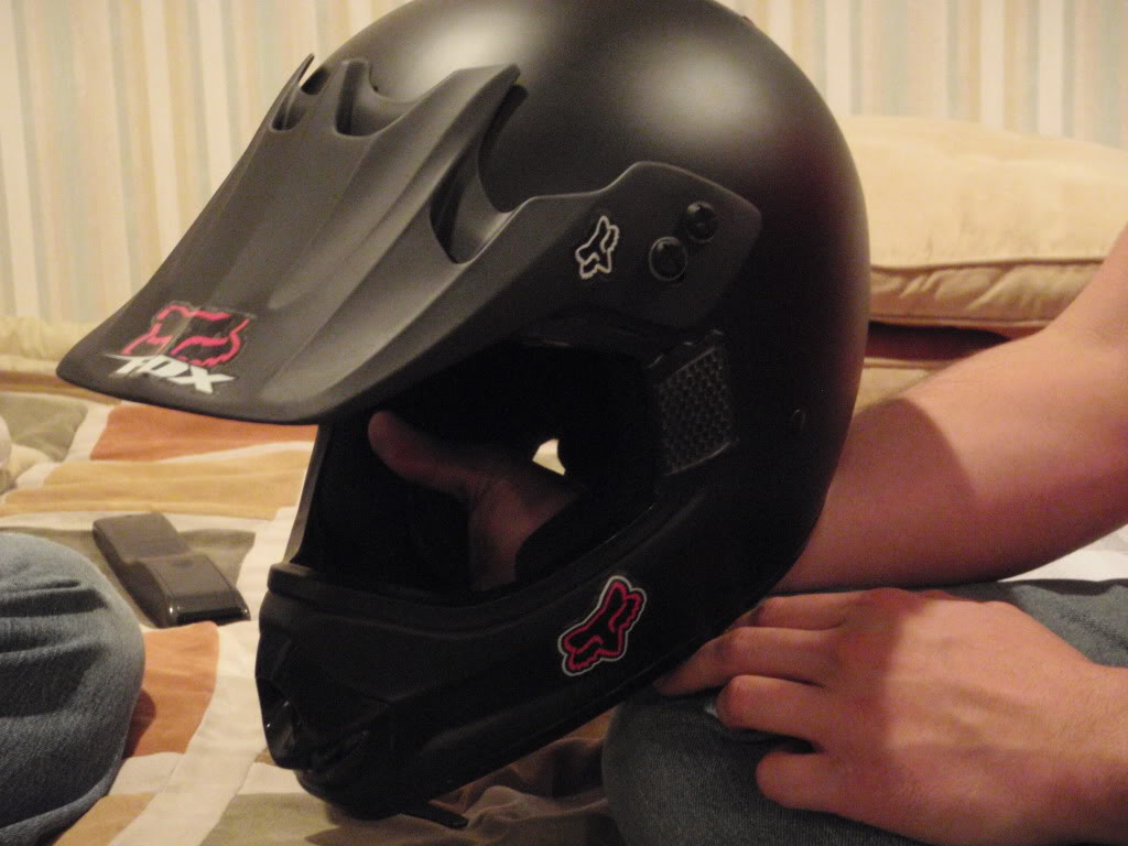

All of the other parts are going to be flat black, using 2 coats of rattle can primer and 2 coats of rattle can flat black.
Well get more pics up soon... We decided to do the helmet too lol
wow, helmet too would just look awesome, like perfect match for the ride... no way u lost her on the dunes xD my gf also crying for a pink set...

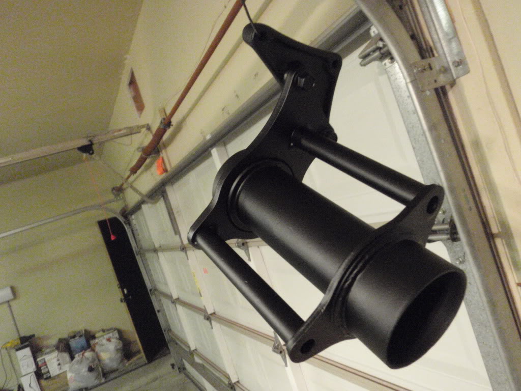

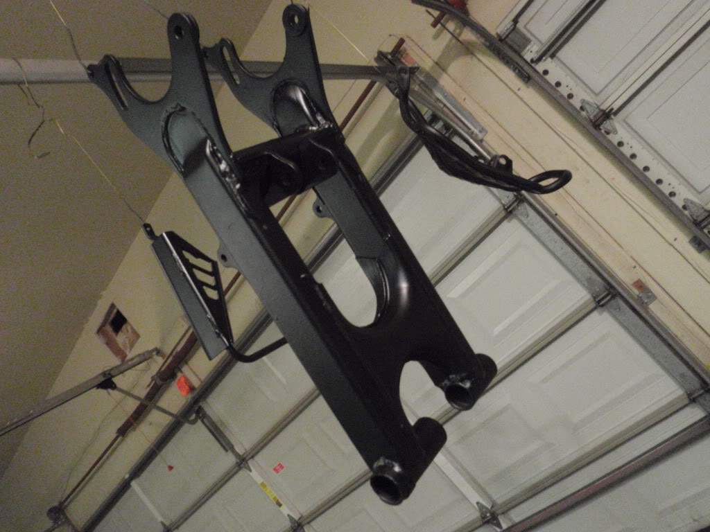

Now to the pics!
Start
Finish
omg! that black painted parts looks so good finished... very sharp
i would put some tribes or a small detail on the helmet, btw... not to ruin or anything, blackhelmet will absorm more the sun rays... her head is gonna burn if theres to much sun -.-"
but is better look good and this is looking really good! =)
cheers
Haha Thanks guys... and nice find on the seat cover. If it was black with pink stripes it would be a perfect fit. lol

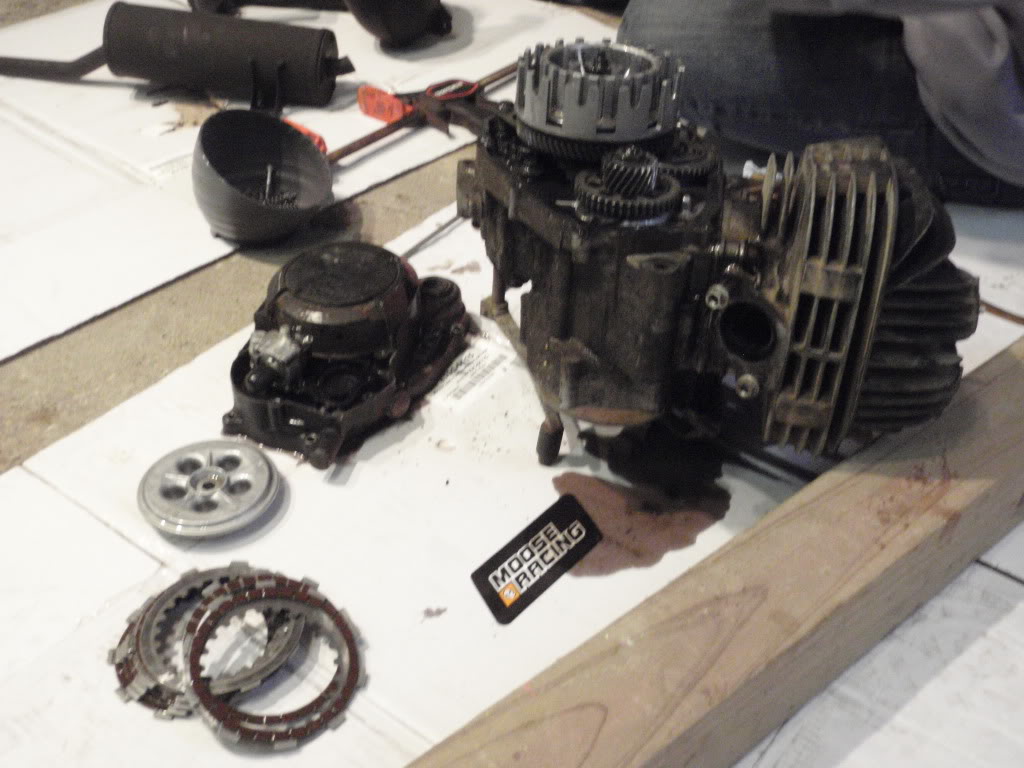

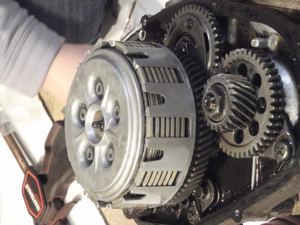

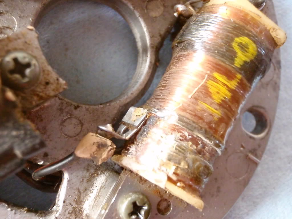

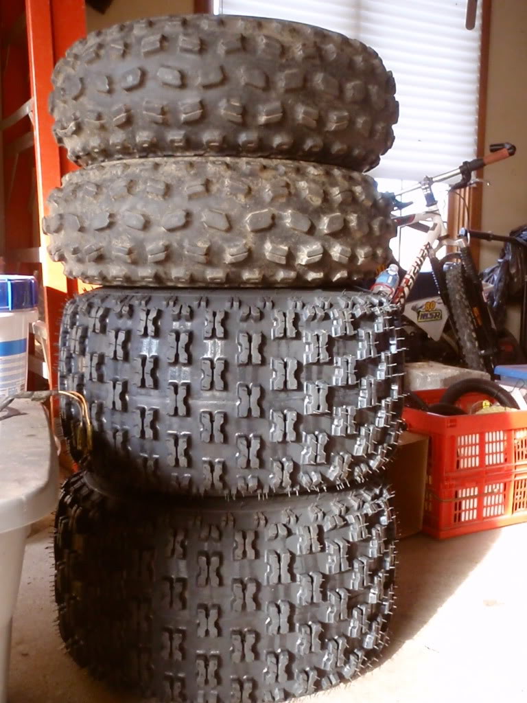

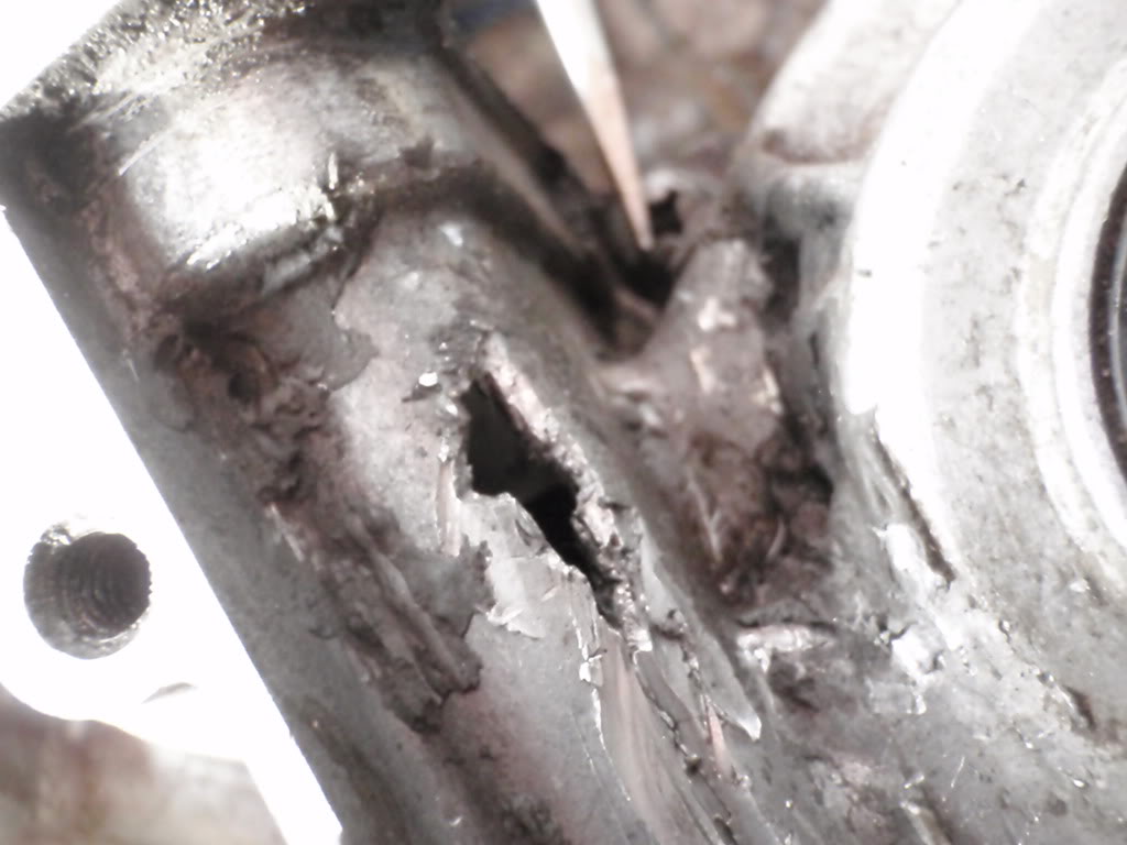

Well we made a little progress this weekend, however hit some additional roadblocks. While cleaning the block found a few layers of JB weld covering a crack/hole in the block, from where the chain popped off. We've cleaned up the area and are going to weld a patch over it soon. Also found two loose screws inside of the magneto, had it pulled and in the process the shop destroyed one of the coils. Come to find out the two screws were holding the smaller of the two coils in place, so the wiring was destroyed when it was torn off. We dropped in a new clutch and picked up some new ITP Holeshots.
And were gonna be painting the hubs soon and get it rolling again.
