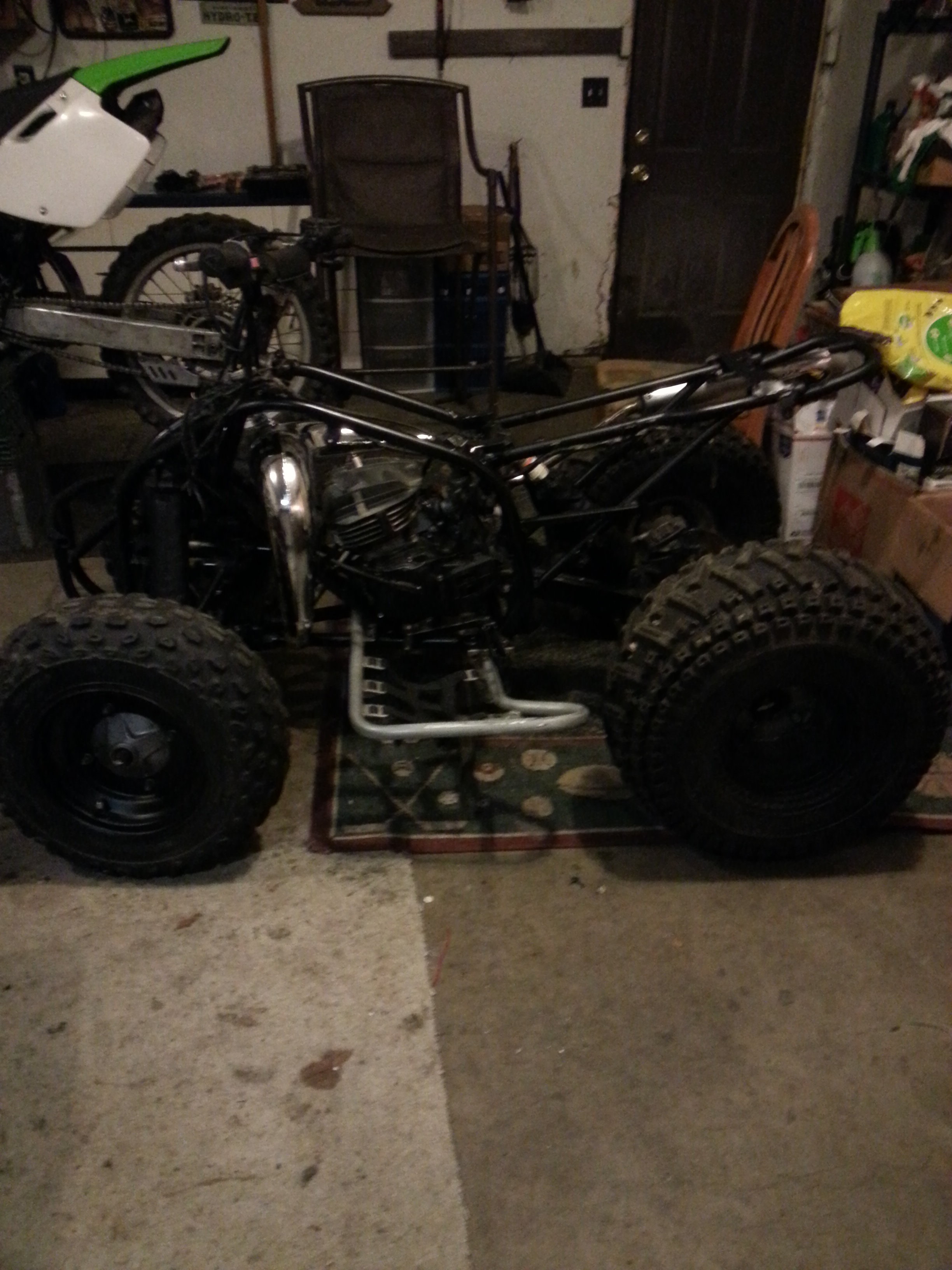

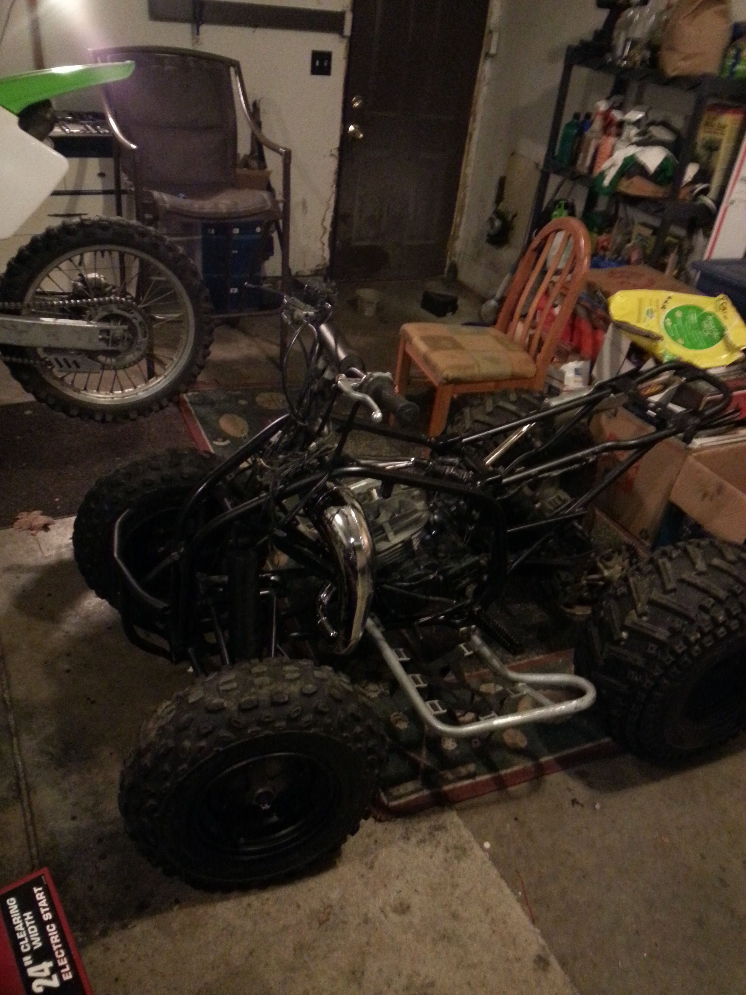

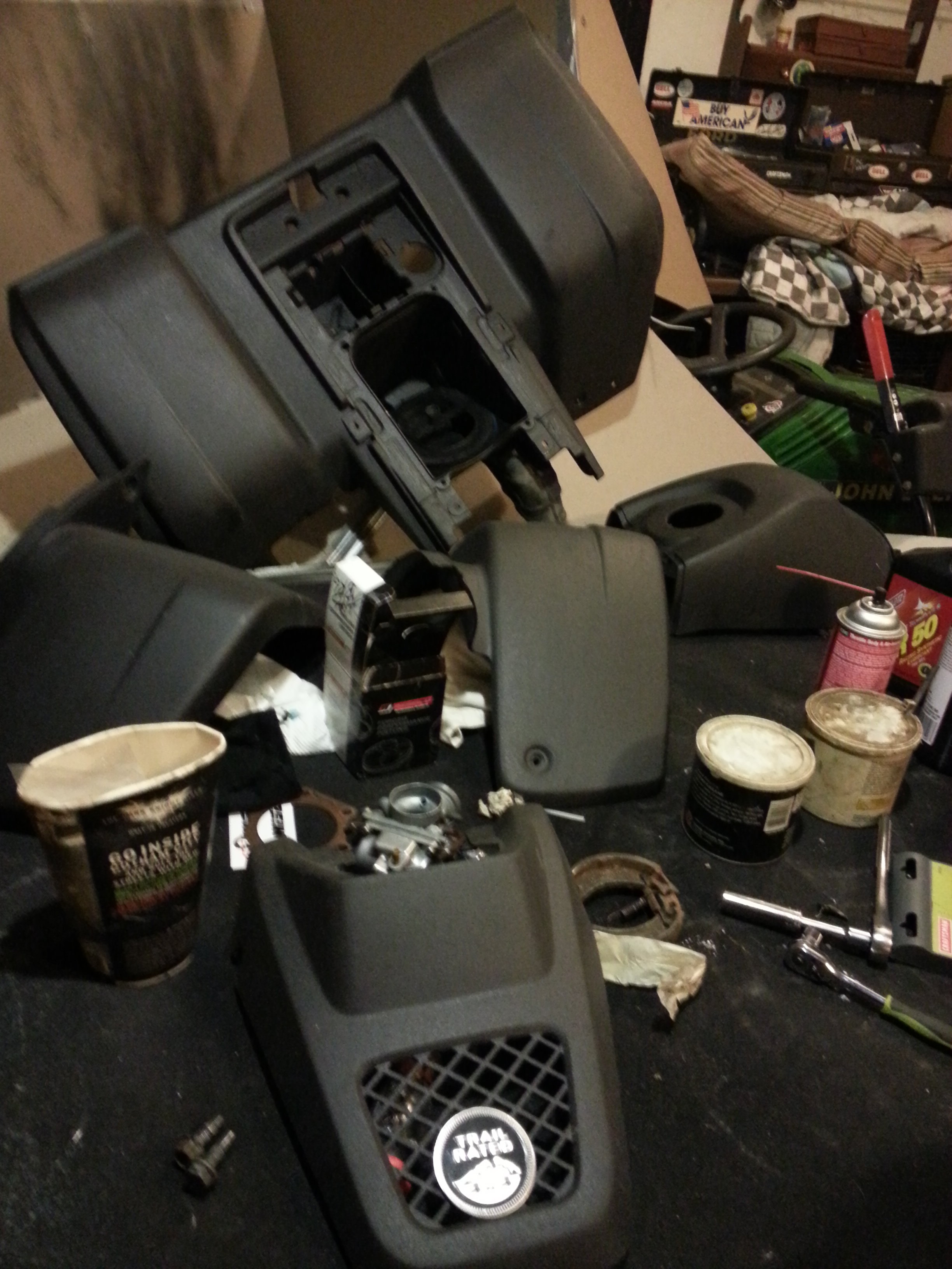

Brand new to the forum ive referenced here too many times to count and finally joined tonight. Bought a 91 blaster last fall for 400 bucks from a buddy. He blew the top end and took the cylinder off jammed a rag around the crank n let it sit outside uncovered for almost a year before I got to it. The bottom was froze up needless to say and one piston skirt broke off in the cylinder (clean break) half ass black paint job on the frame and on the blue plastics. In other words it was terrible. But im now in the process of putting it all back together and wanted to share what ive done to it and hear what people have to say and give any knowledge I can to anyone here and learn ofcourse.any ways sanded all plastics down sprayed all of them with black plasti dip (looks great) sprayed the front rims and frame in satin rustoleum. Bramd new wisecocrank shaft, bearings, seals, had top end professionally bored with new piston and rings I also got all new hardware for the case and top end. New boyeson power reeds fmf fatty pipe. Q series fmf muffler. New sprockets and chain. New drum brakes up front & a few other things im sure I forgot to mention but dont want to ramble more than I already have I will upload pics if its possible from my phone
Here we go
20140317_035047-jpg.9052
20140317_035226-jpg.9053
20140317_010948-jpg.9055
20140317_011317-jpg.9056

looks good man.
choose "full size" next time while uploading and the pics will show full, instead of just a clickable thumbnail
