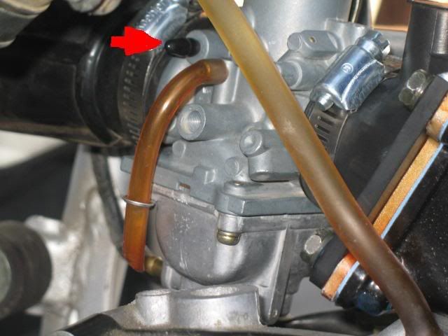

It's on the airbox pictured, with the clamps you recommended.
