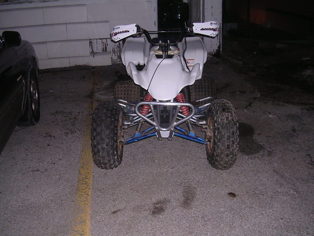

aight, had to take of the rear fenders, the wheels, and the handlebars but its outside and now loaded into the truck. the tires look smaller than they are but they've got no air in them lol.
and here's where she's been sitting for the past couple months while she tortured me and i sat on her and mad engine noises....
yup...just need to hook up the cables again, and get the new clutch perch/lever tomorrow. hopefully i'll get my new chain adjusters and shee axle so i can put the rear brakes and stuff on.
