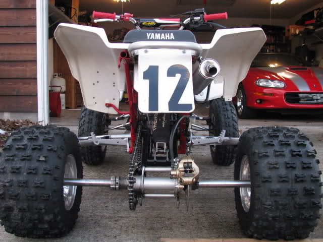

AWK: Ya I meant to call you this week but I got busy at work and had no time to check out the brakes. They seem to be working ok now I think they just need some more ride time. I think that the carrier itself is bent bc the ears look straight. I may need to do some more investigating. Here's a pic, if you look closely you can see how the bottom shock mount tube is not parallel with the carrier. The right rear is farther back than the left rear tire as well.
i can clearly see the tires are out of line, are both chain tensioners touching the carrier ??? maybe just slid one side forward ???
check the carrier long bolts too, make sure ya didn't snap one right behind the nut ?
keep me posted on the brakes, i'll walk you thru a re-bleed if necessary
