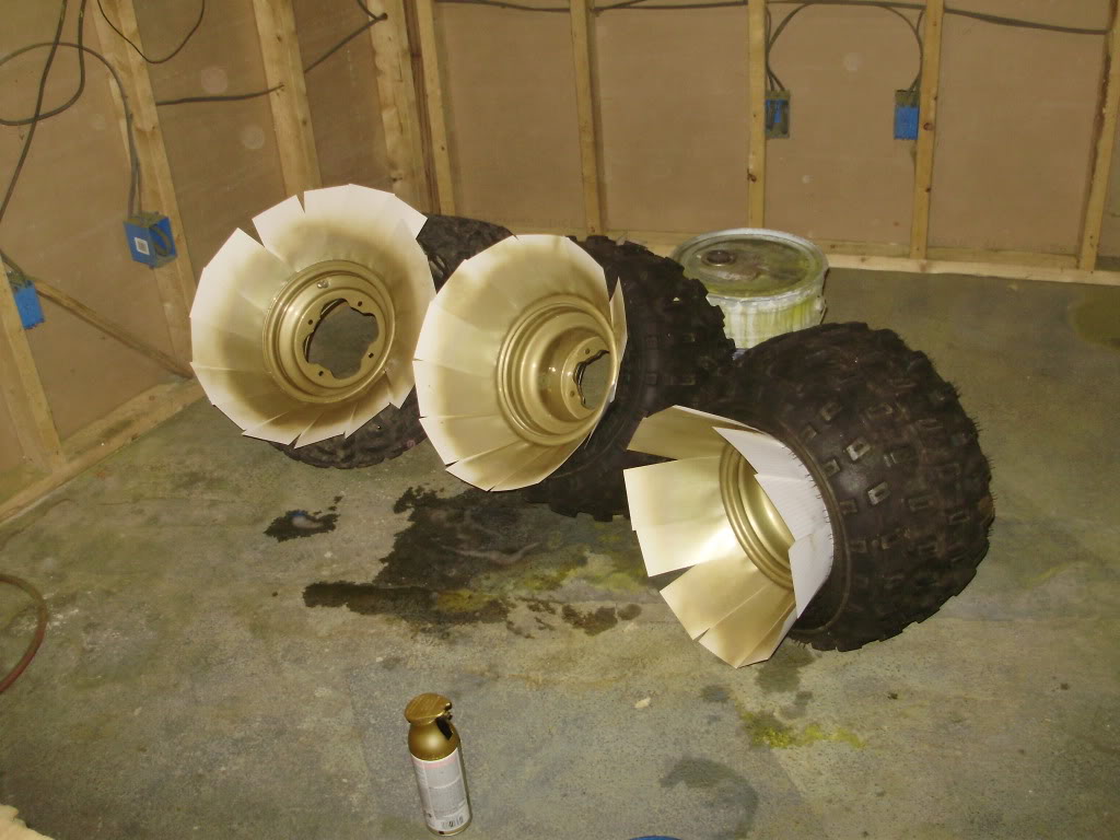

I'm not taking the tires off, I'm not spending hours masking them either.
Clean your rims BY HAND with soap, water, and a sponge,
then wipe them down with a wax, oil, grease, remover.
I like to use a sponge for that too since it leaves no lint.

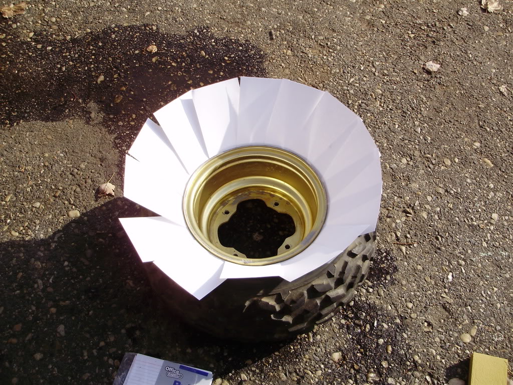

Let the air out of them, push down on the bead and run index cards around them.
Paint away with zero overspray.

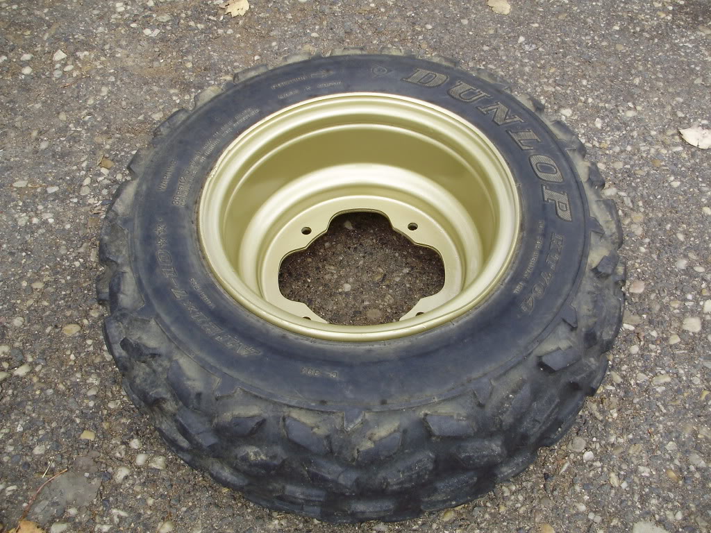

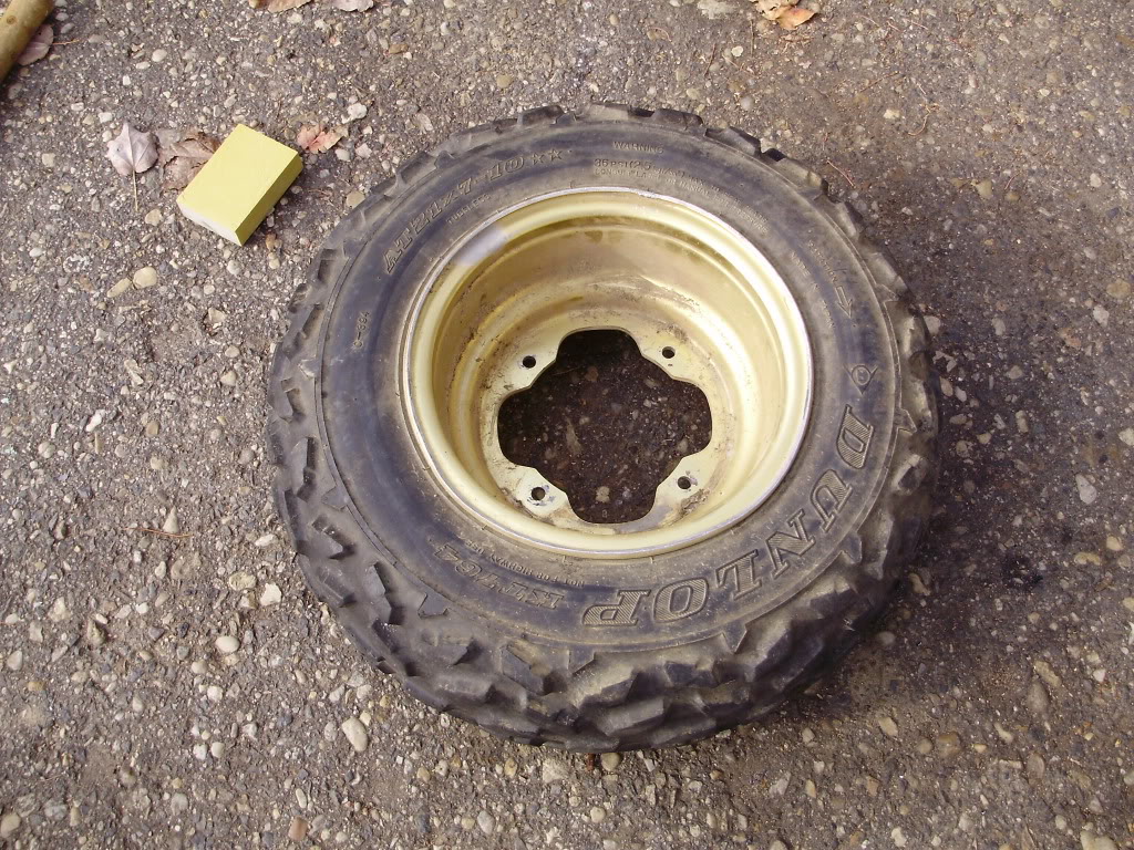

Stock gold fronts

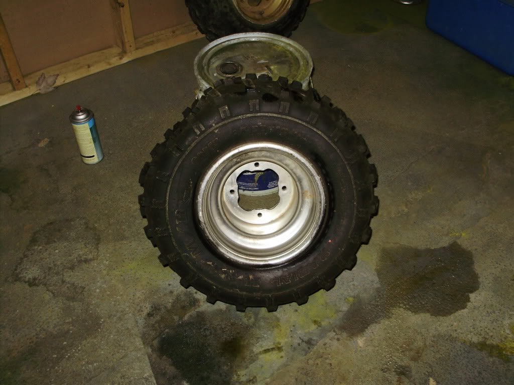

Stock silver rears
Clean and index cards put in
Sprayed

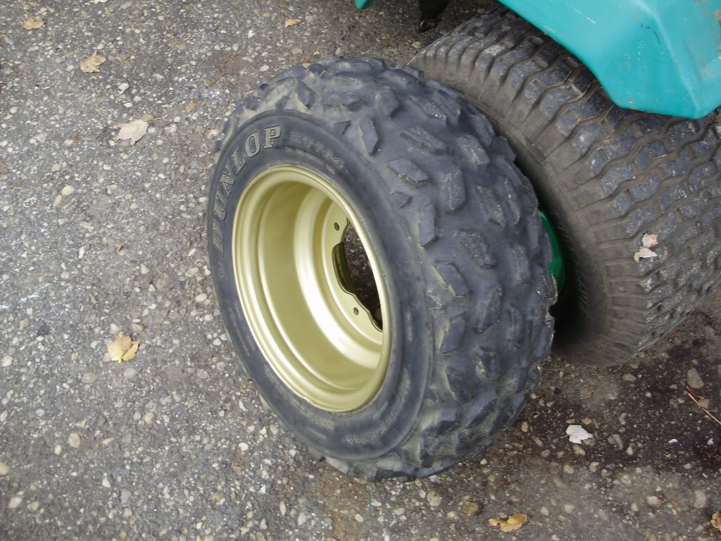

Dry and done!

Stock gold fronts
Stock silver rears
Sprayed
Dry and done!
