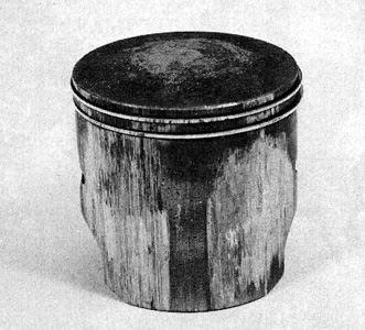

It has been said before and I'll say it again:
Wisecos are a tough piston, but need a careful warm up to prevent "4-square" seizures.
For the same reason they do not handle overheating all that well either.
If you go a cast piston it is important you keep the skirt clearance in specification.
With those caveats you can use any Blaster piston you desire.

The points of most expansion, in my days that problem was solved by barrell grinding and making the skirt oval.

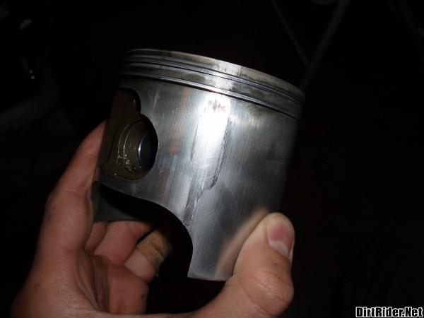

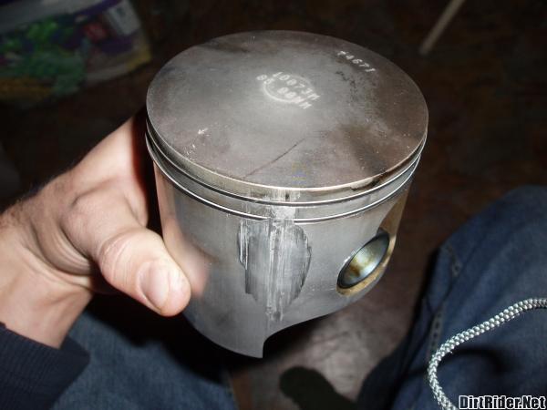

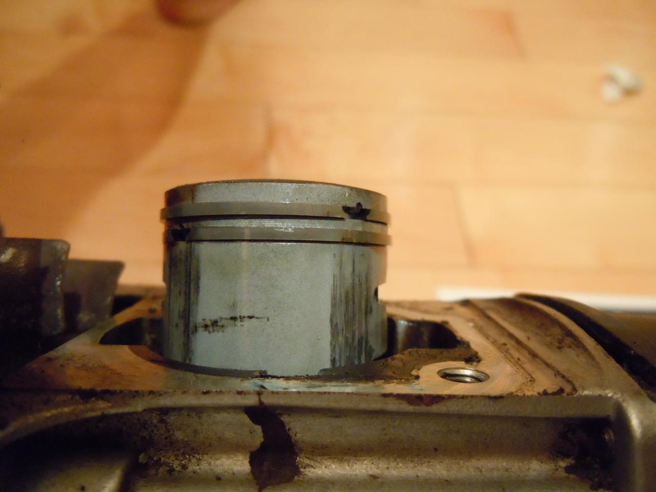

Wiseco's can fail too! Piston failure is not just for cast pistons like a few folks would like you to believe.
Failed wiseco pistons...
