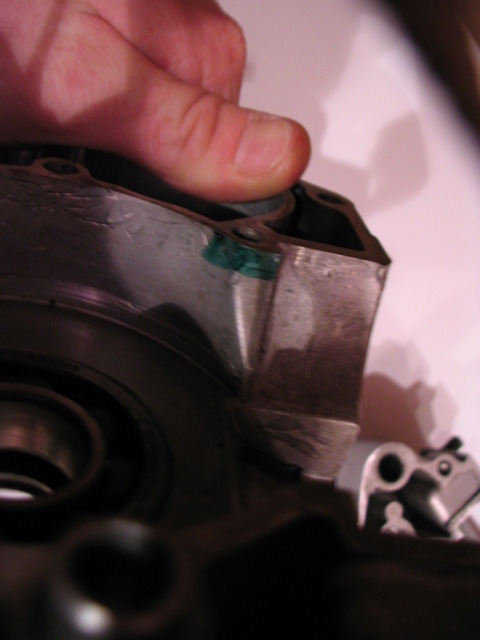

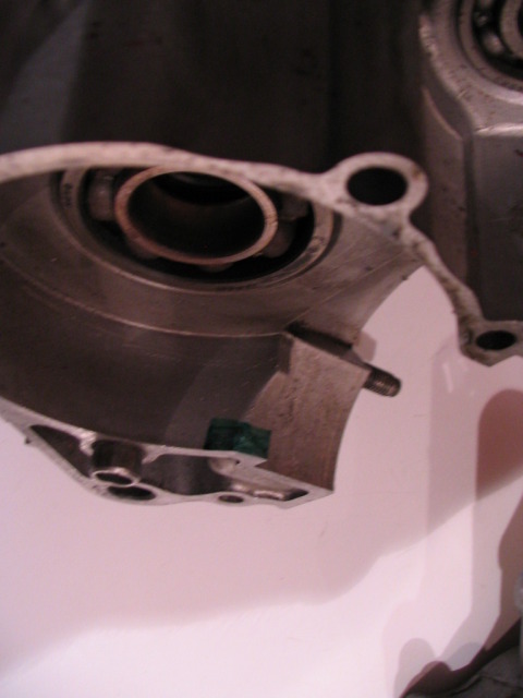

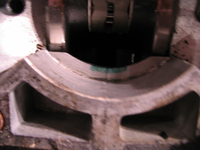

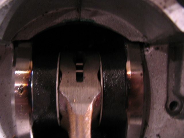

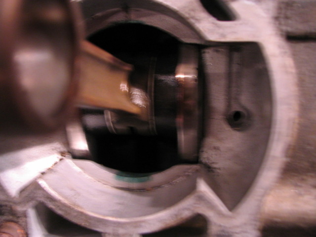

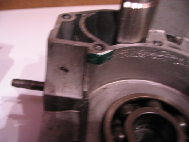

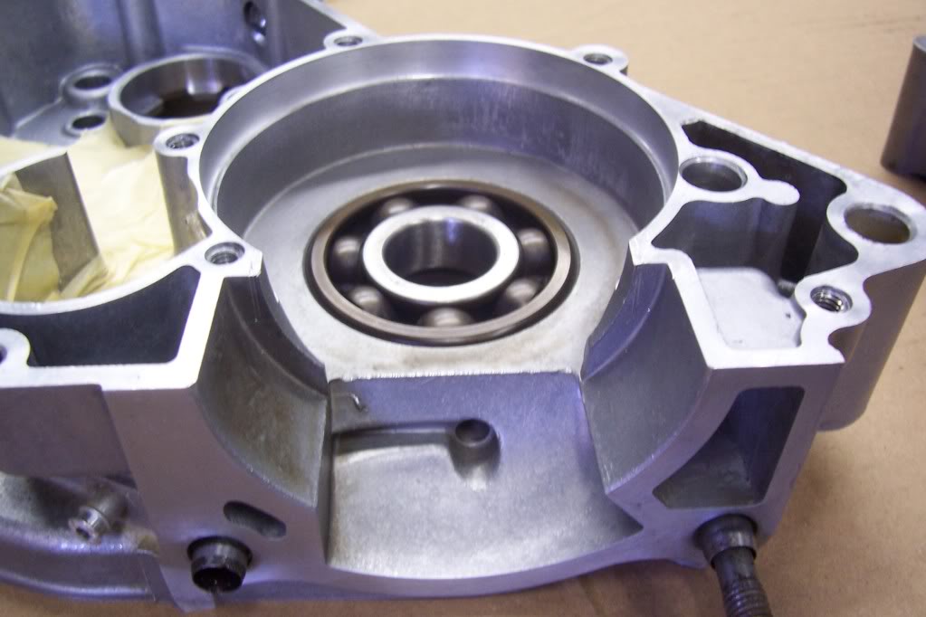

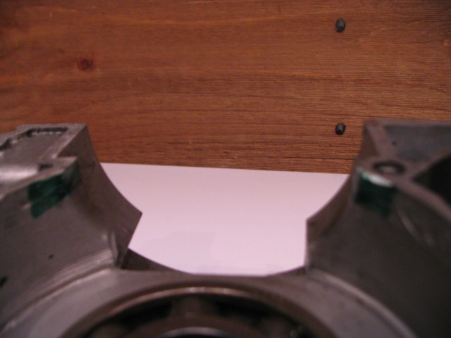

Glad to help. If you are going to go the stroker route just make sure you have the jug ported for the 3mm stroker.A 3mm stroker running stock port layout with the spacer plate is not ideal.In fact a stock stroke crank with stock jug will probably be better or atleast not much difference.Also there are 4mm cranks available also which require case trenching(machined) in order to fit and not just some hand grinding.Some of the 3mm cranks don't require any but more often than not the rod neeeds the clearance.It's just safe to do it rather than get it together and find out.I don't have any good cases that are split right now,but here are a few pics of where to grind.You will see I highlight it in green sharpie in the pics.You do not have to grind off all green that is shown,just trying to represent the best picture with the cases together.Sorry best I have for pics right now.

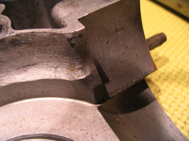

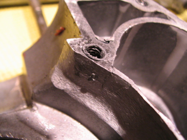

These pics will show you the cases apart and the area not seen in the above pics.These cases are junk.Someone used a die grinder and trenched them for a 4mm crank.Not the proper way and as seen in the pics it will crack the wall very easily.But these are the only set I have apart and to be honest they should be sent to the scrap yard.But you will get the idea.Keep us posted.

couldn't say for sure if that hand grinding caused the breakage or not. Point is that it needs to be done properlt so that the minimum is removed so to not increase crankcase volume any more than necessary.
Those hack job cases are a bad representation.It was all I had apart to try and show you.I was also just hinting on the +4 cause I knew you were going to see them when looking for a +3 and wanted to calrify it now rather than later.With that said I went down after work and took apart one of my parts motors just to take these pics for you so you can see where to grind for a +3.Again I have it highlited in green sharpie.You are looking to just remove that "hump in the center of the green and smooth it out accordingly.It just needs to clear the width of the rod.This is to be done to both cases as they are split directly center of the rod.
You are correct.The hand grinding didn't casue the breakage but if they were machine trenched and not a die grinder they most likely would have survived.There are a few more spots not seen in the pics that are broken through also.Along with many other points of failure.Not going to mention names directly cause we do not need any of that here.But I will say he offers a free $100 off a port job every time someone calls him out:o

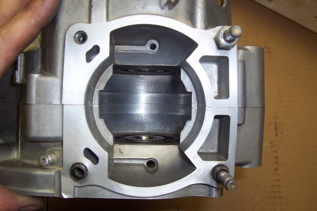

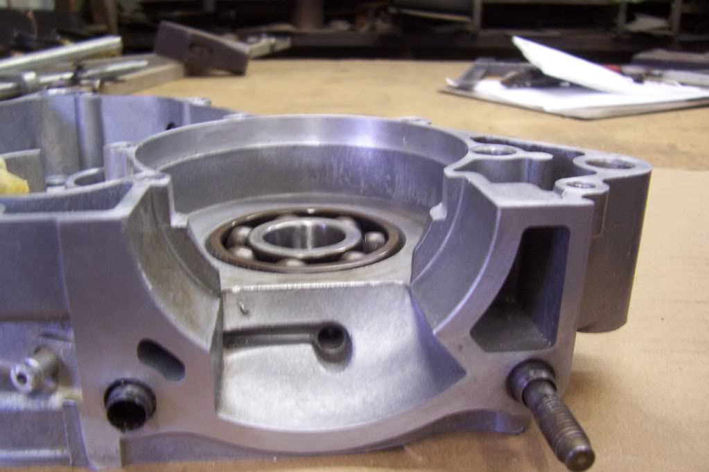

Nice pics DUALSTROKE!!! I wonder how long it took someone to hand grinding trench that case? lol

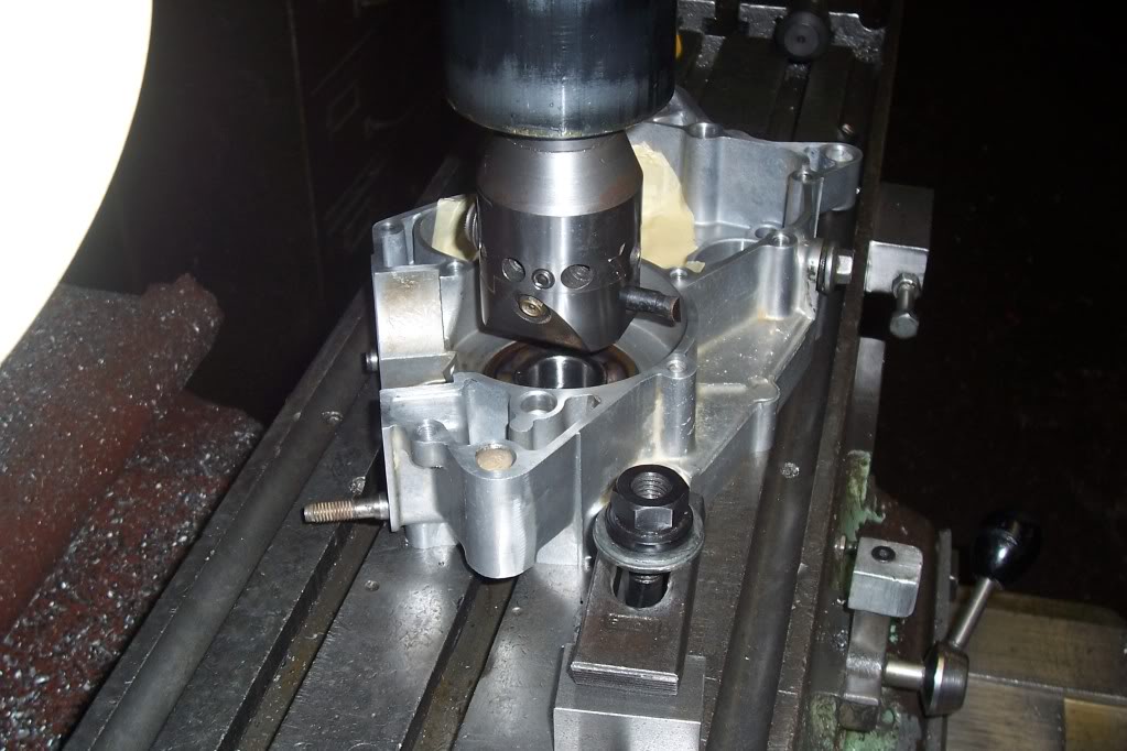

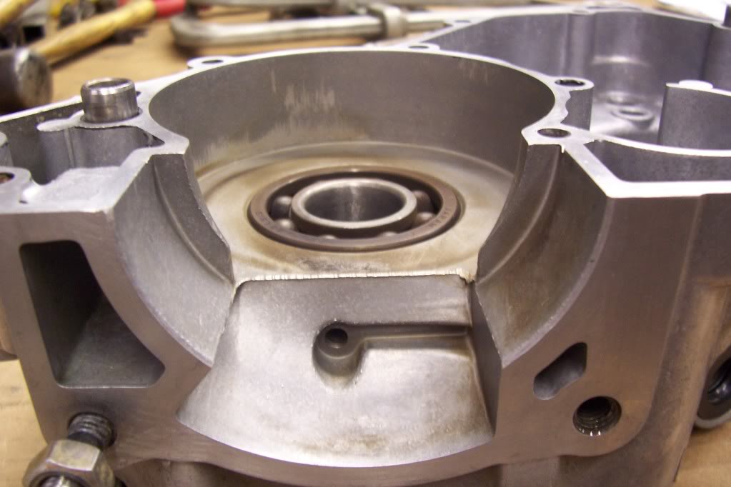

I will never trench a case again!!! I trenched my case, and didnt like it..
Before
