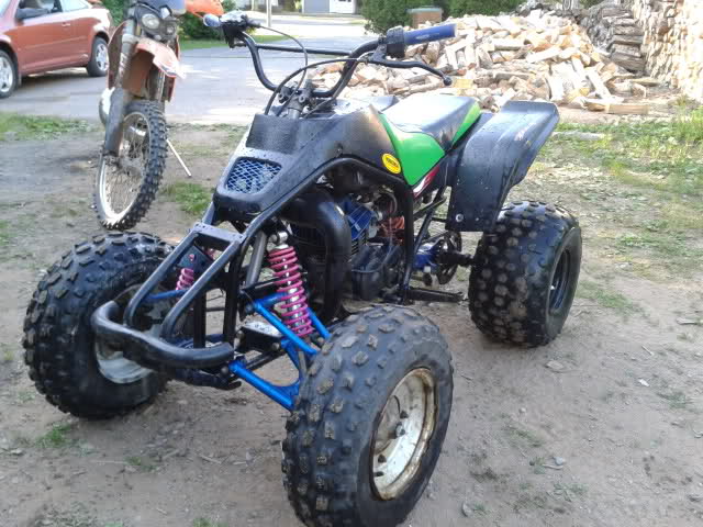

The ongoing project...
We actually got a new and improved seat in the bucket-o-parts for this old girl.

A day earlier this was all pieces in a box, a day later, Blasting down the trails!

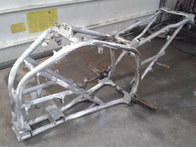

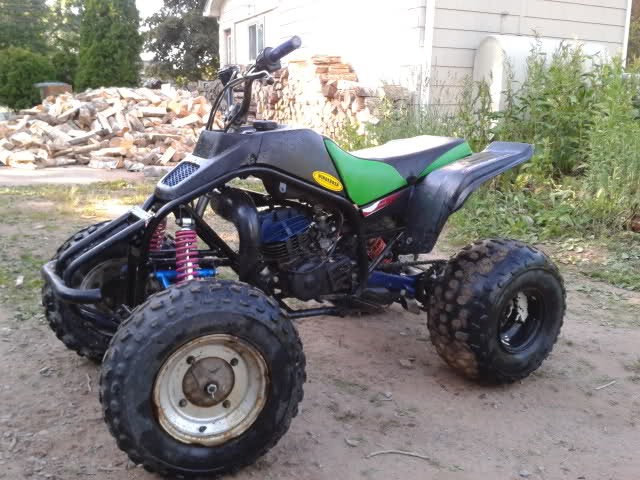

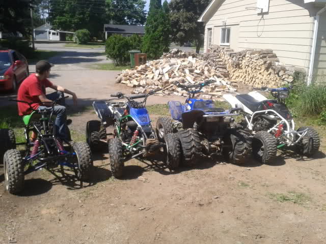

this picture was takin on the 6th of this month so 9 days ago we sanded down the frame for paint. keep in mind this is about 3 days before i even brought the engine onto the building bench. lol it was a wild 10 days but we had this bike out tonight and it worked AWSOMEEEE. it is crazy to think that 2 weeks ago this blaster was litrally a frame 1 A-arm a swingarm and a rear shock THATS IT. the guy in the pic BEST uploaded is the owner and he bought 1 by 1 every part he needed and i built it for him. this bike was a true goner as it was used and abused and we brought it back to life. :) feels good. i always seem to suck at getting before pics tho.
an example of the stuff i was dealin with

we have more frames ready for building why stop??

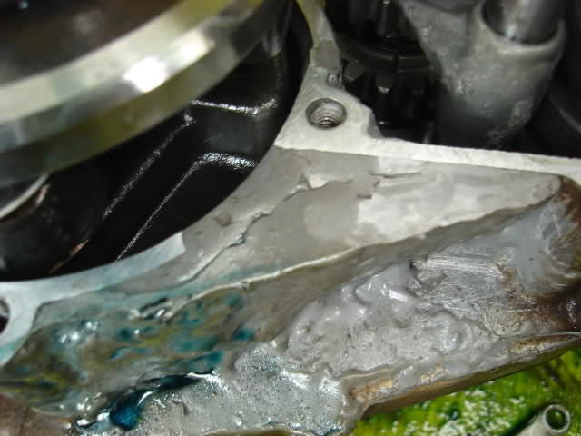

The case Neil is working with right now is his original from a couple years ago.
As received, it had major broken piston skirt damage, a 1" hole in the bottom, metal missing from both halves and a crack into the gearbox. We repaired it with Fiberglass and JB weld, building up about 1/4" of JB weld re-enforced with the fiberglass sheet. This was done with the engine apart and filed the part line smooth (not just a "plug up the hole" job) to seal.
Found the thread: http://www.blasterforum.com/engine-mods-swaps-129/jb-welding-holes-45887/
This has lasted a couple years of hard use now.
