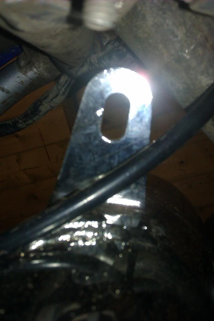

Hi guys i got my new dmc exhaust system today. i got the front pipe on but the silencer is about a inch off lining up to get bolt put on to hold silencer. the stock system lined up but this isn't? it is correct exhaust well i think as it came straight in a dmc box with dmc labels with blaster written on. pipe fits just silencer won't line up

thanks man! was abit worried when it wouldn't fit lol know on the stock exhaust how you have the tab thing that bolts up under the hood for extra holding strength? do i use the stock one as i didn't get one with exhaust.
this
yes use the stock hanger under the hood. you usually have to adjust the angle it is hanging to get it to bolt up right. just get everything loose, fit it all together then start tightning things
