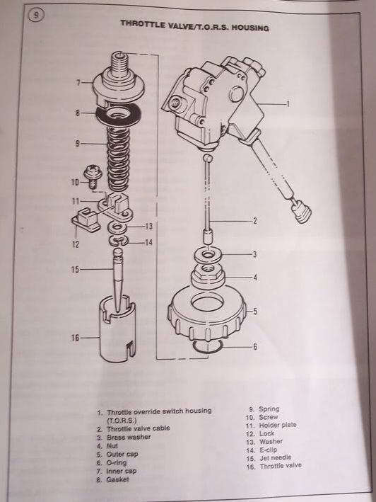

so i pulled the carb today to give it a cleaning and move the needle clip to the middle position. I made two discoveries, first upon cleaning the car my hand got covered in a gray sticky substance of some kind wonder what that could have been. Second on the needle there is what i call a plastic washer that sits on top of the c-clip, but there is none that sits down in the slide should there be one there and if so, is it essential or should i stop order the washer and wait..thanks for the help
i thought it took a plastic washer below and above the needle clip ? (been a while since i fooled with my stock carb)
but the diagram shows only 1, #13 above the clip......
