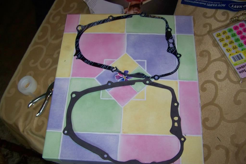

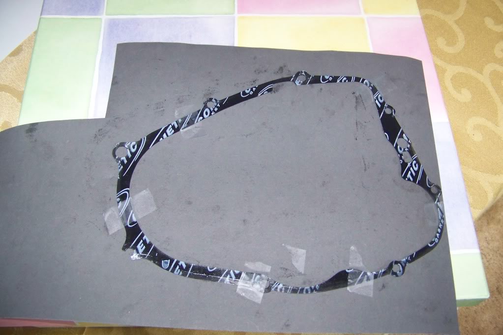

well nobody stocks a clutch cover gasket around here so i decided to make one. i have used this stuff numerous times for intake gaskets and i really like it, OBVIOUSLY you wouldnt want to use it as a head gasket or base gasket.

good job noober. i may have to start doing this wih the frequency that i've been tearing my stuff apart
When making gaskets here is a tip. Go to the gun range. pick up spent rounds. Use them as your punches for perfect holes. Thought i would add that.
sweet gasket bud, thats what i use for all my gaskets. good stuff. and for the holes i use a hole punch .
yeah me too, i bought one from walmart for .97 lol I:I im surprised to hear so many guys are using this stuff, i expected a bunch of people to hate on it lol
nice scooby, where does one get this stuff ????
yea we uses it alot, my dad has used it for his intake on his 250r, and for aloso the clutch cover AND we even used it to make gaskets for our pull, where you put the light in and the filters you have to have a gasket to go in between the part and the pool liner so my dad didnt want to buy so he made it so far its lasted the whole summer no leaks.
so i guess its a multi purpose kinda thing, lol
Good info Noob! I scan gaskets as I take'm from the pkg so I always got a template when I need to make one. Gotta keep different thicknesses of gasket material around when ya live outta town :)
thanks alot guys :D i got the roll at auto zone for $5.50 and so far i have made 6 intake gaskets and this clutch cover gasket. so i have saved a nice bit of loot :) and like otis said when noone stocks the right stuff and nothing is close its DIY time lol I:I I:I
Sweet bro, Definitely better than spending shipping cost from fleabay, but i do Like the cometic gaskets, they are like twice as thick as regular and they hold up 100% better!
