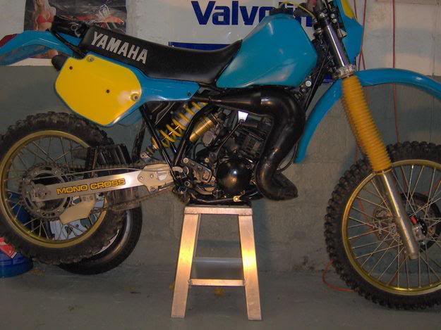

You could also pick up a head off the Yamaha IT200 dirtbike.
It looks to have less fins then the Blasters but I would just cut the ones you have.
