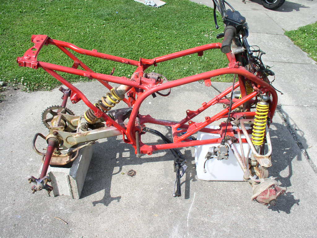

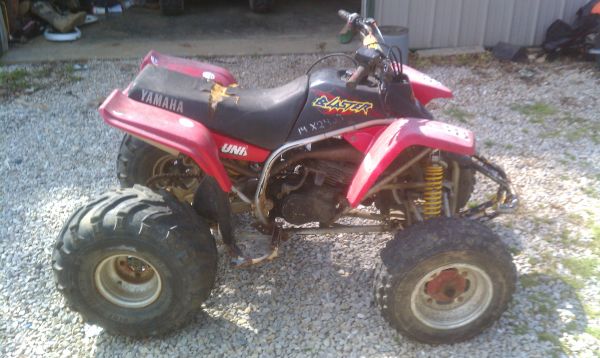

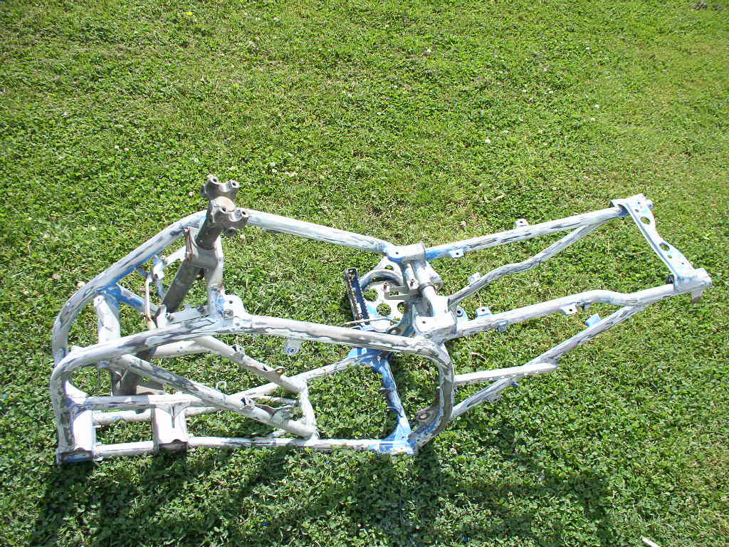

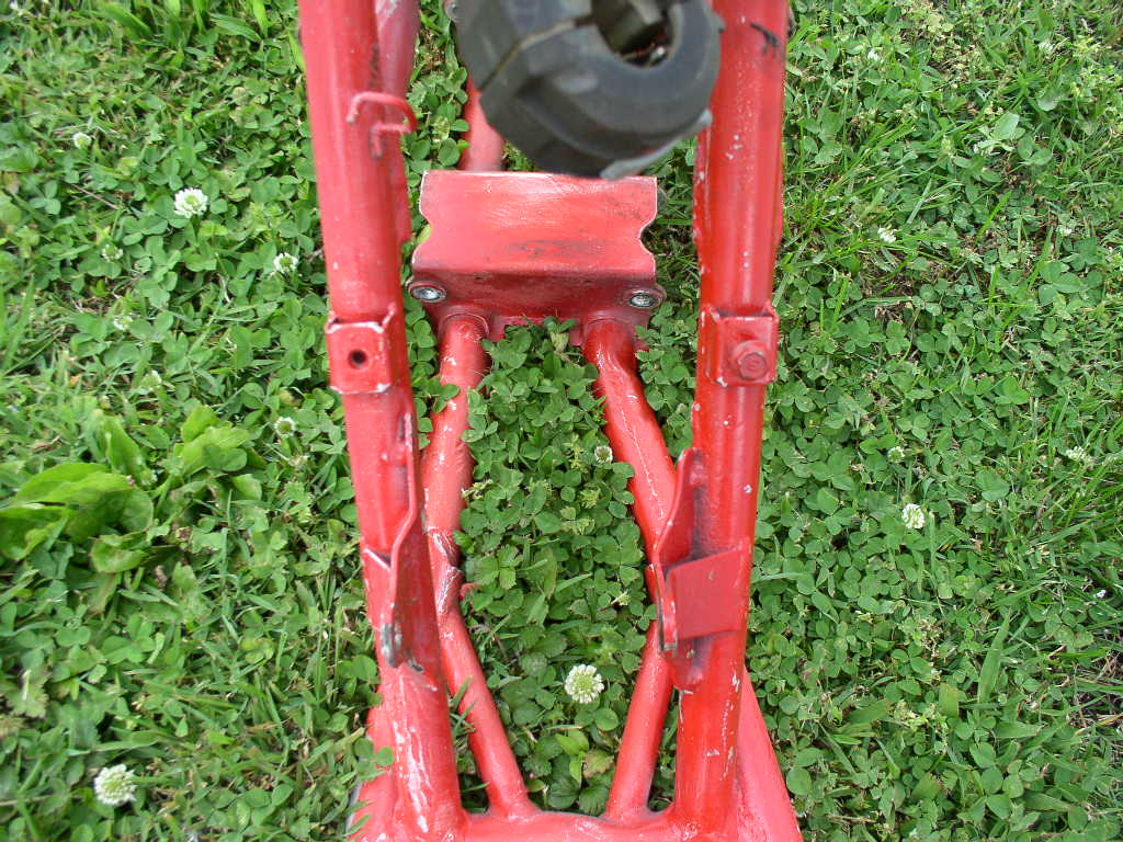

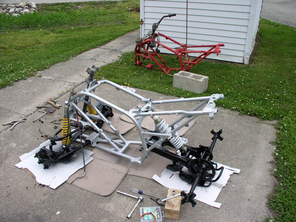

I bought this for my sons bday coming up with hopes of just repair a few things and have a rider, got a good deal on the thing I guess but I notices while prepping the frame for paint the frame was bent so it has became a full frame switch which is fine because it will be much nicer than it would have been otherwise.

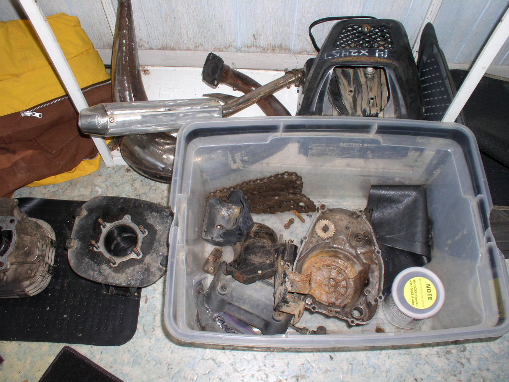

I bought it sight unseen with 2 additional frames, 2 additional rear tires on rims, 1 additional cylinder, a box of what I assumed were ALL the parts. (Not even close) It had 1 intact motor loosely mounted to the red frame. It was missing the entire rear brake system all I have is the lever.
Before I forget I have a spare cylinder I can part with I measured with my caliper and its 2 21/32- 67.4688 with some fair scratches. Give me a shout if anyone needs it, I will price it below Ebay pricing. Or possible trade...anyway I will be adding more pics later.

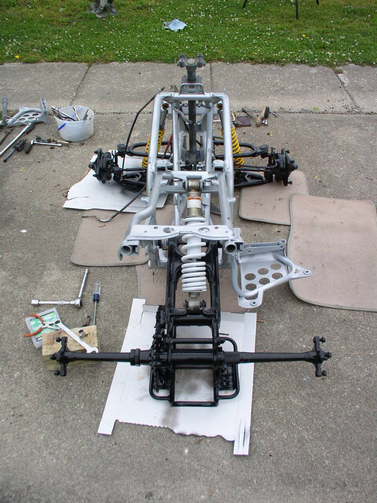

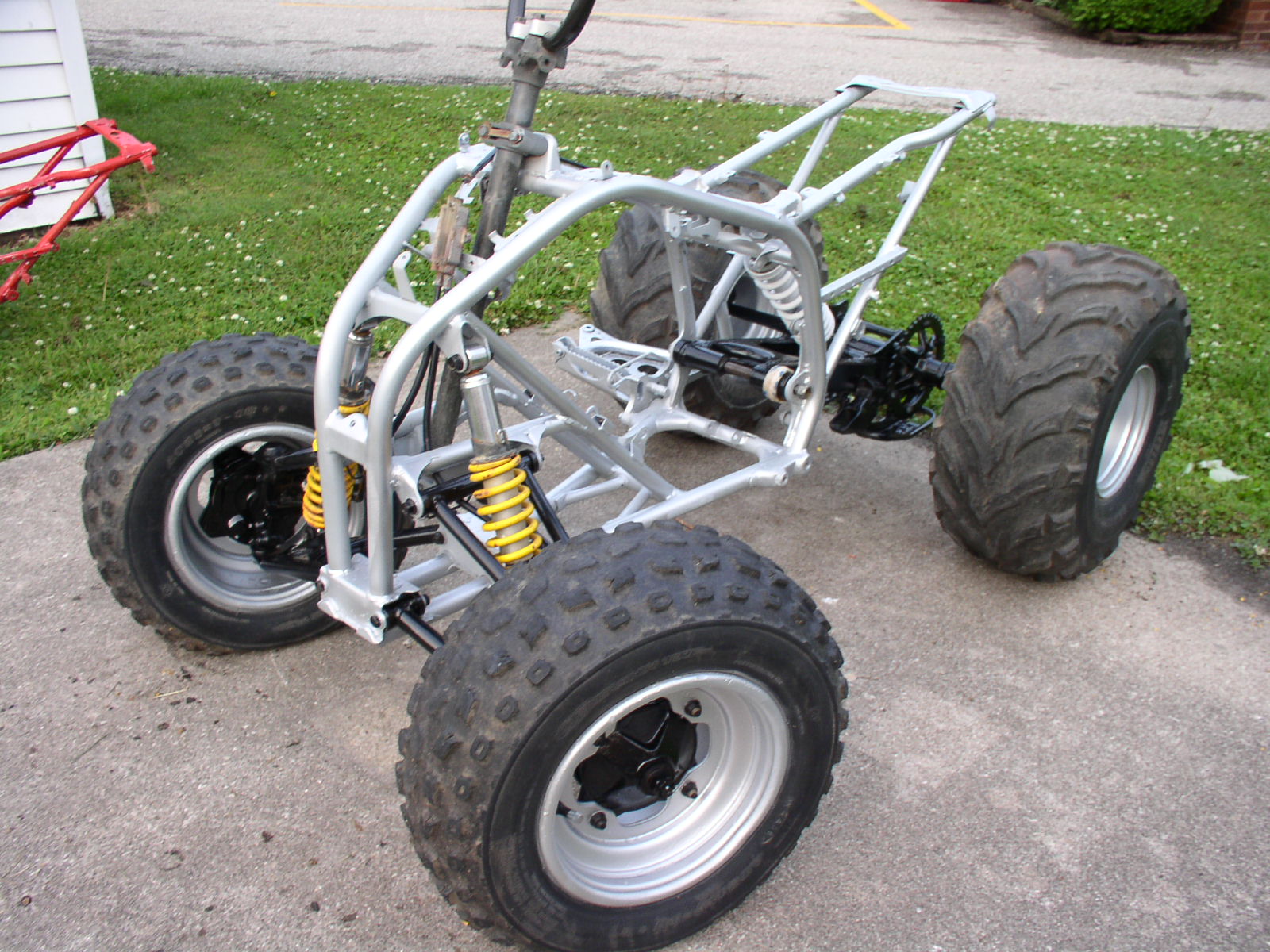

More pics to be added later, ideas welcomed.
Looking sweet! How is the condition of the motor? do you have one fully together?
i use this thread for both reasons.....welcome to BF
and lookin good on the build so far, glad ya found the bent frame before ya got too far, although i spotted it right away..... right behind the bottom right side a-arm bracket, after i've bent a few there myself, ya learn to look for them !!!!
keep them pics coming as it progresses, we're definately pic whores here, LOL

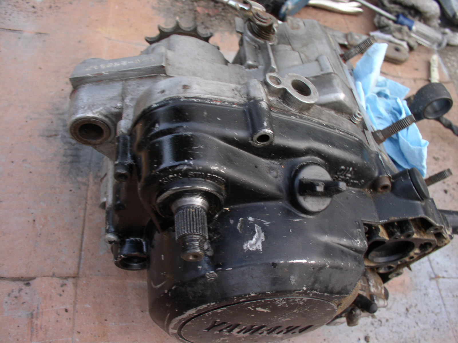

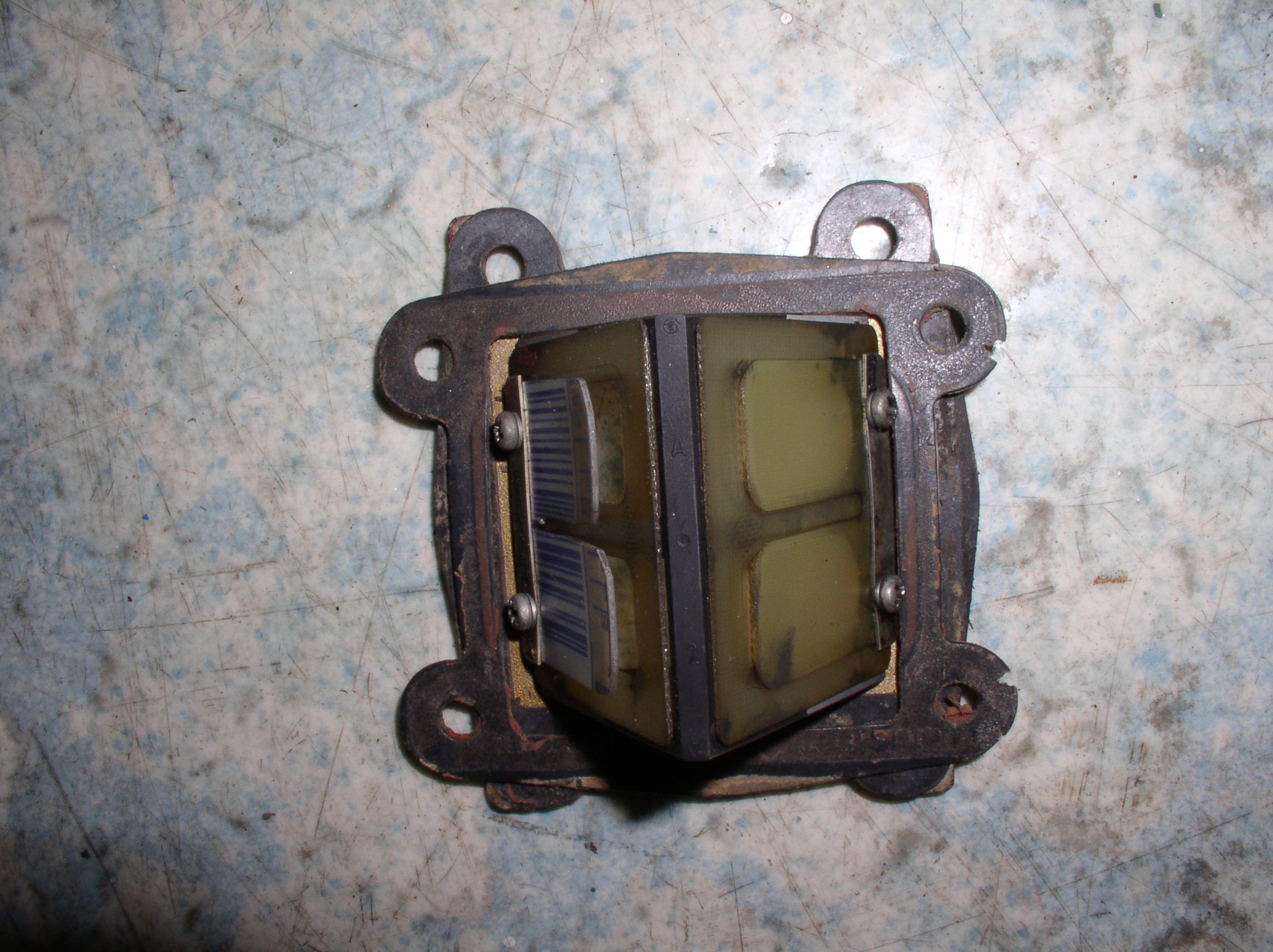

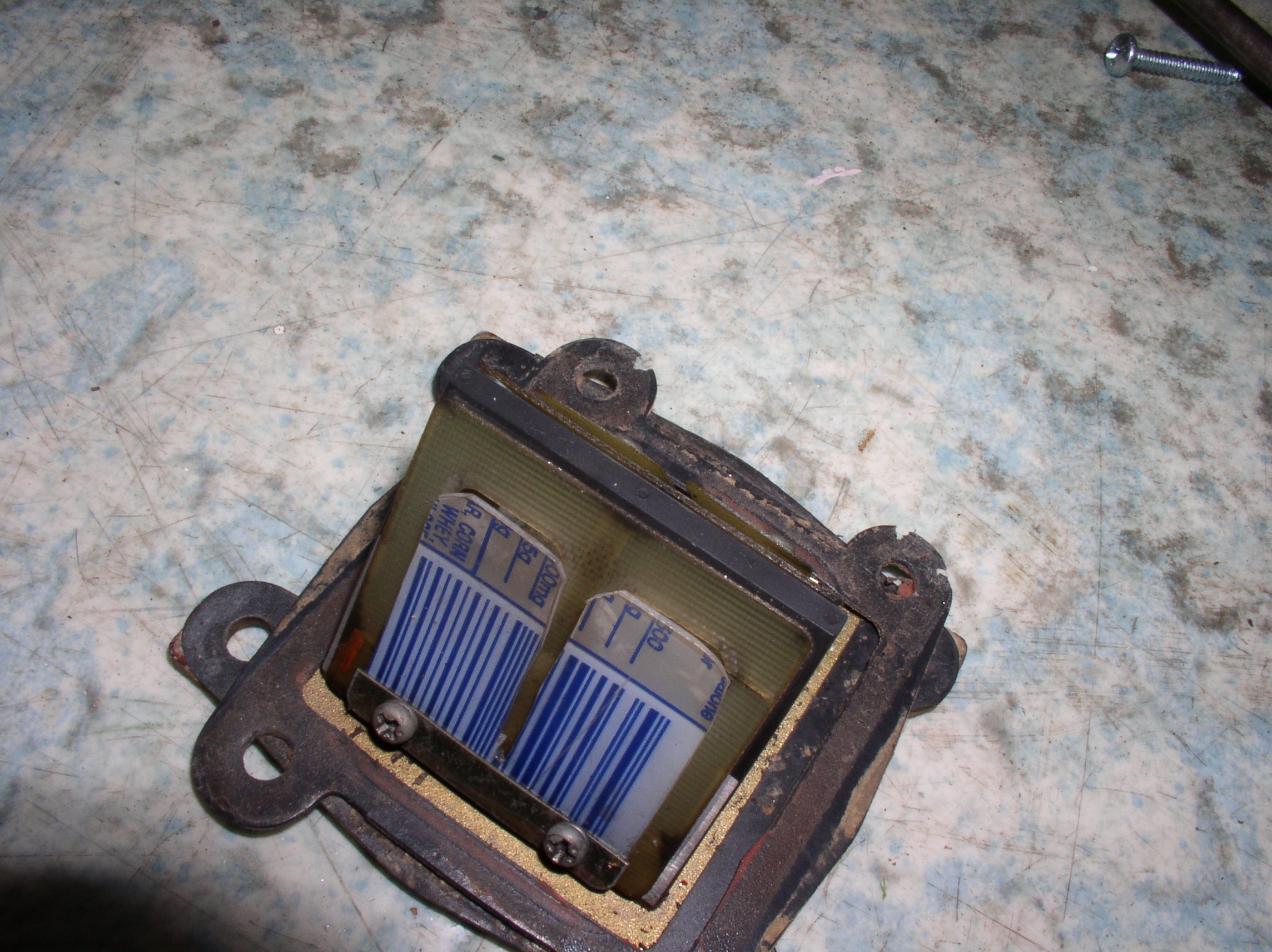

Check out these Ive Cream bucket brand TM. Reeds! Adds 5 horsies guaranteed! I am never surprised when I rip into a motor now days..removed alot of cast piston from the crankcase plus some aluminum was mashed into the connecting rods oil channel.
:o

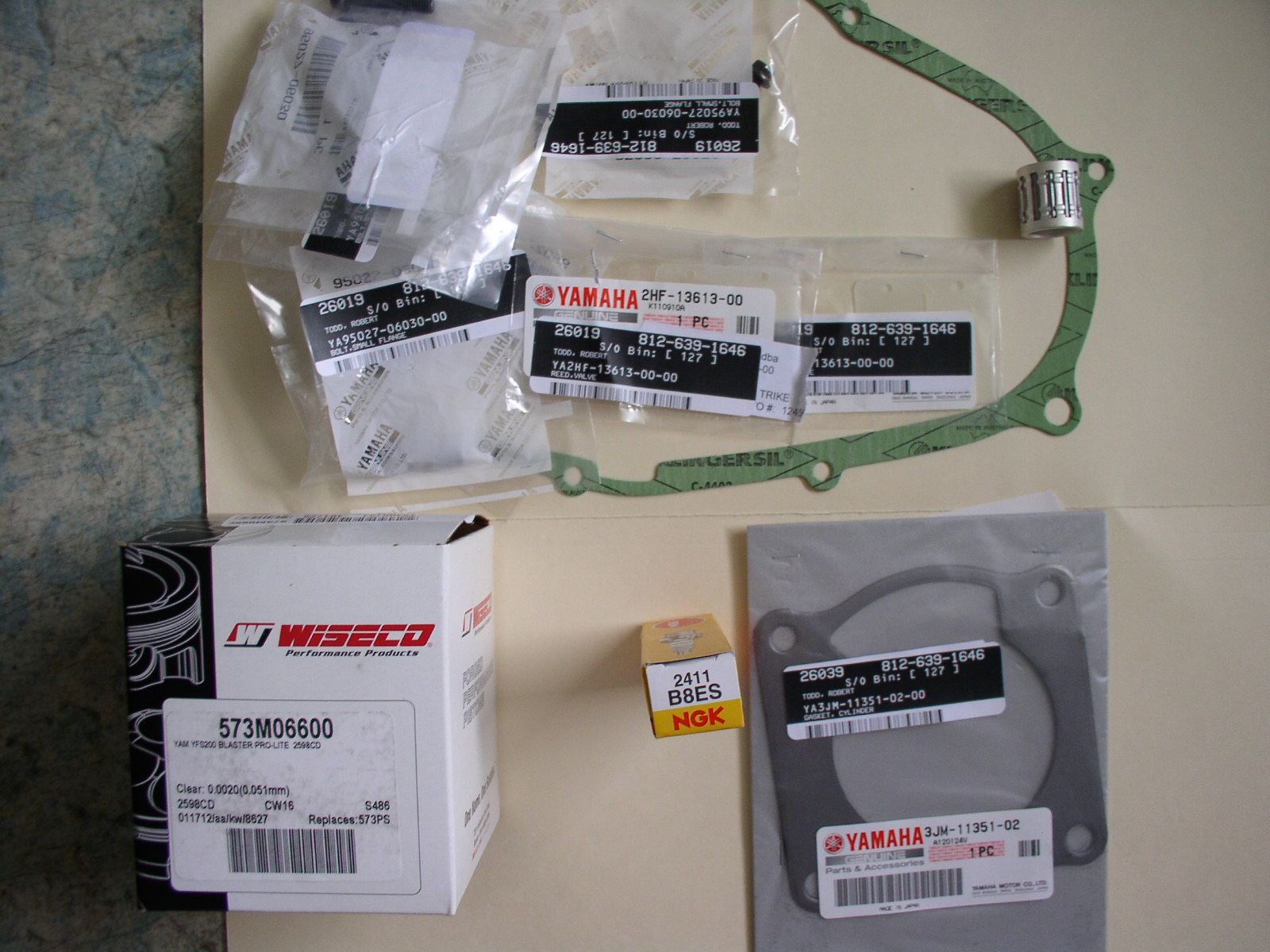

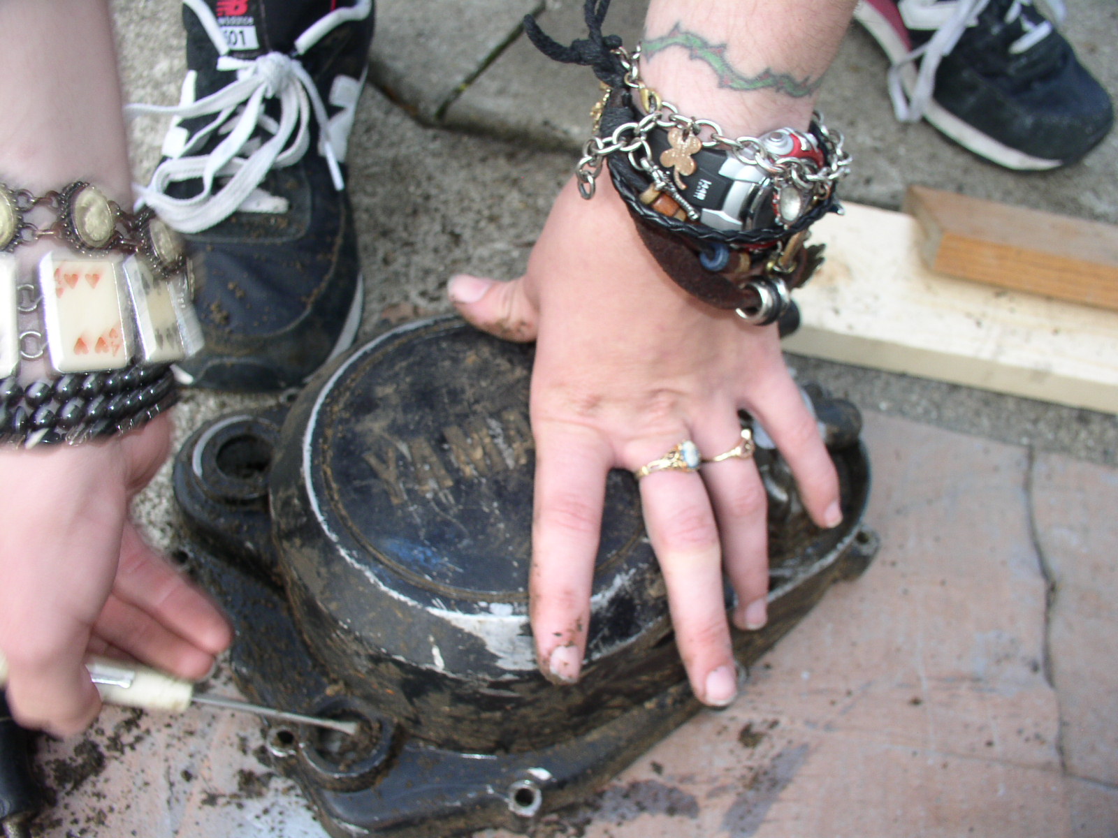

The motor had a cracked crankcase cover oil side luckily I had a good spare, Its apart getting new crank seals..the top end and paint. Had my GF helpin she's not afraid to get her hands dirty! I:I

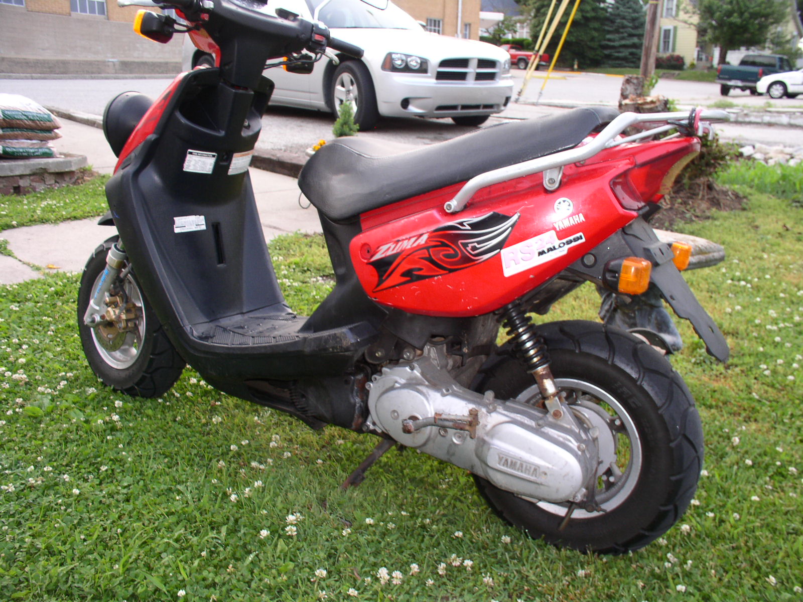

05 Zuma "Sleeper"
Malossi 72cc polished and ported
Malossi Delta clutch
Athena Variator and ramp
5g Rollers
84 main jet
46 Pilot
60 mph
Stock air box and pipe
hey, at least you can run a bar scanner over them reeds to figure out what make they are !!! LOL

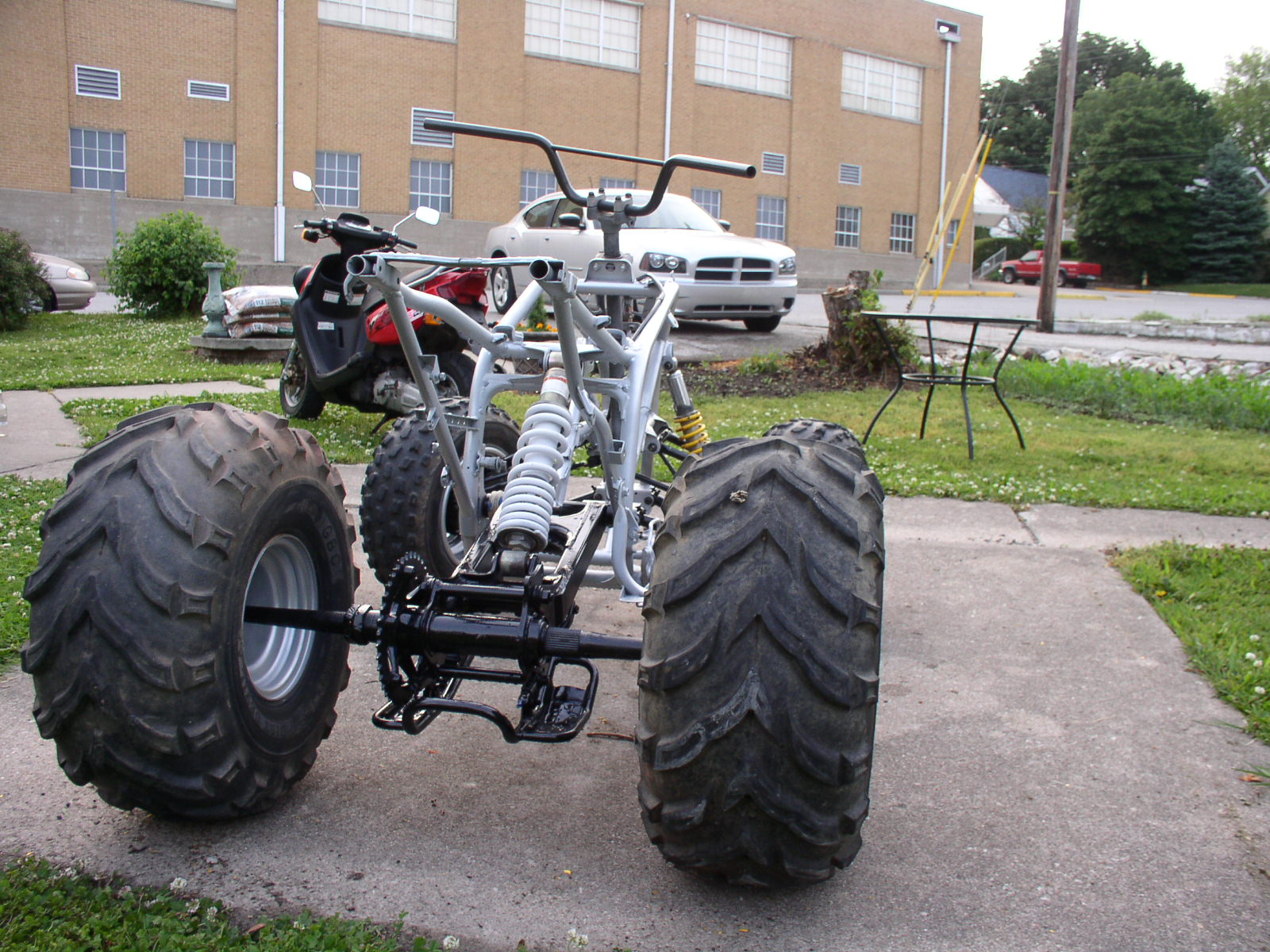

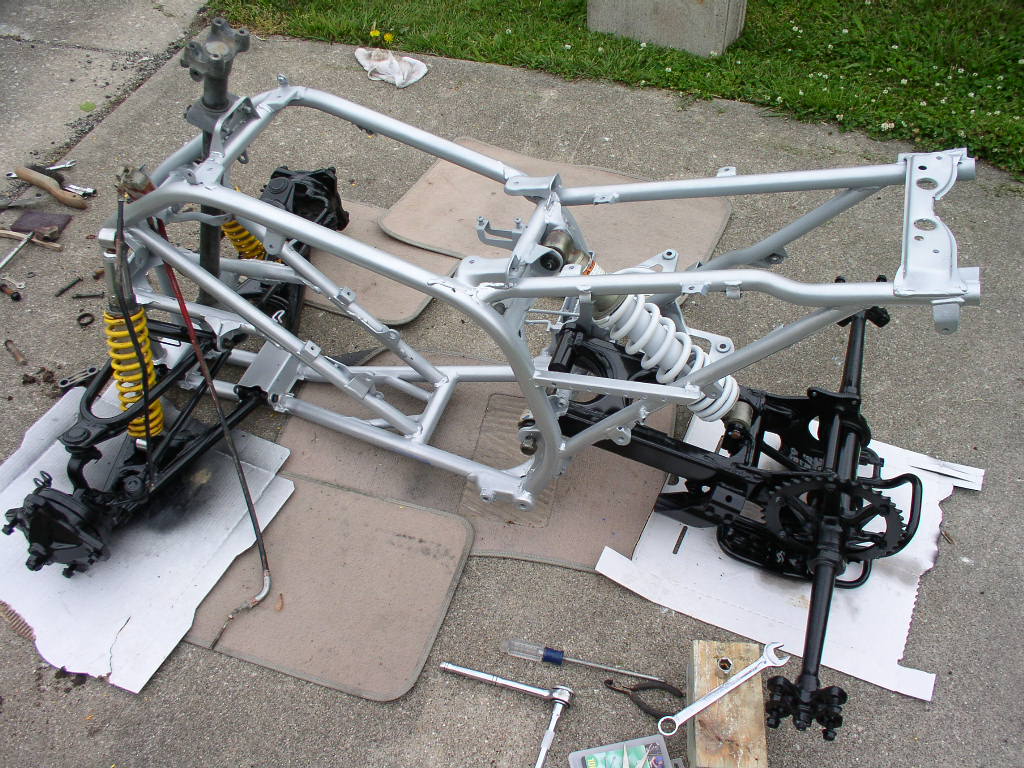

Your front shocks are upside down! haha I did the same thing once. Looking great though!
