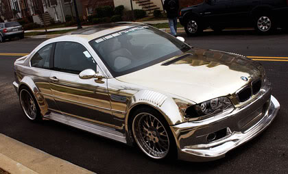

Ok anyone know what paint comes out chrome, i know there is a lot of chrome paints out there but they don't look chrome almost but a shiny gray that's not what i want.
