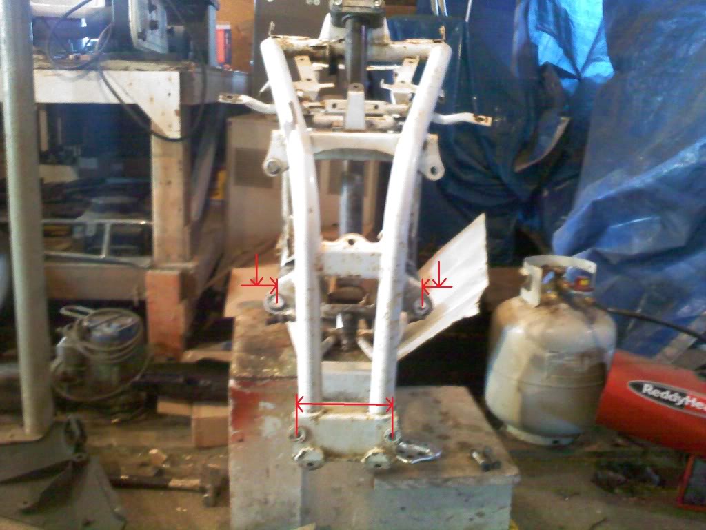

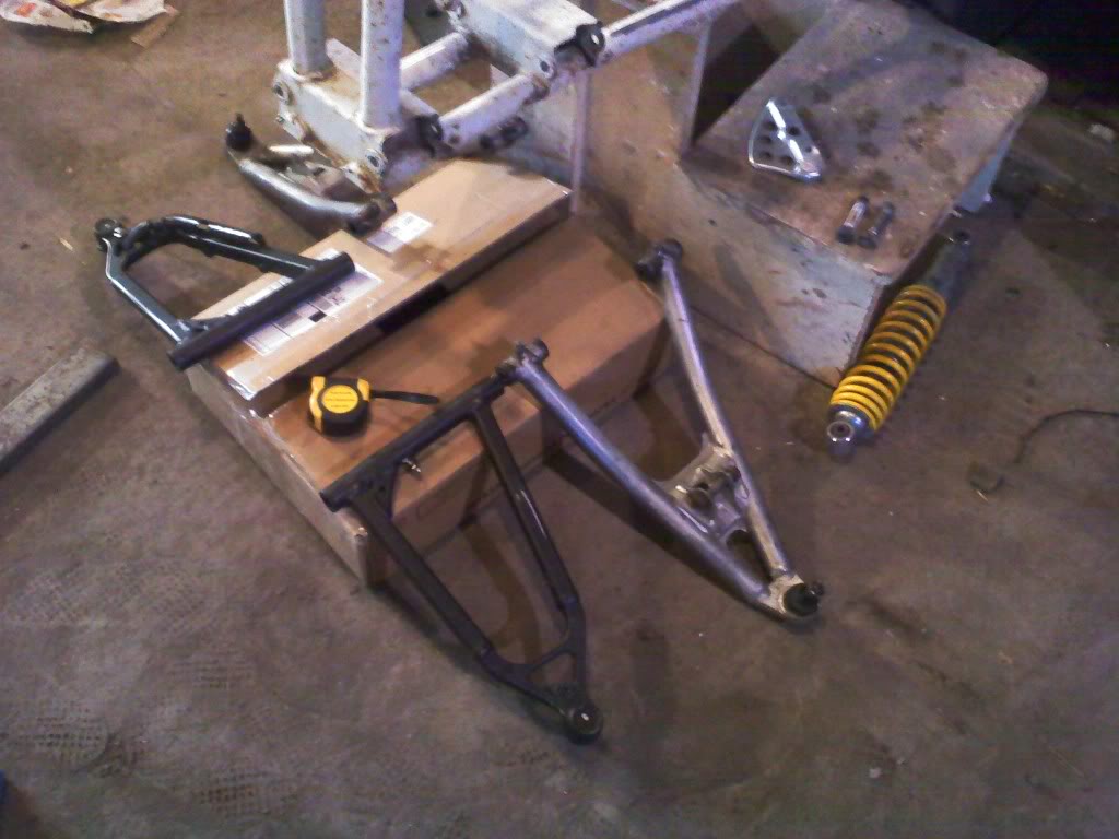

Pics as promised:

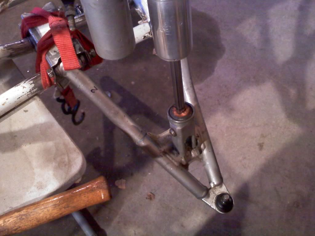

YFZ 450 arms :P
What i need to do to make them fit

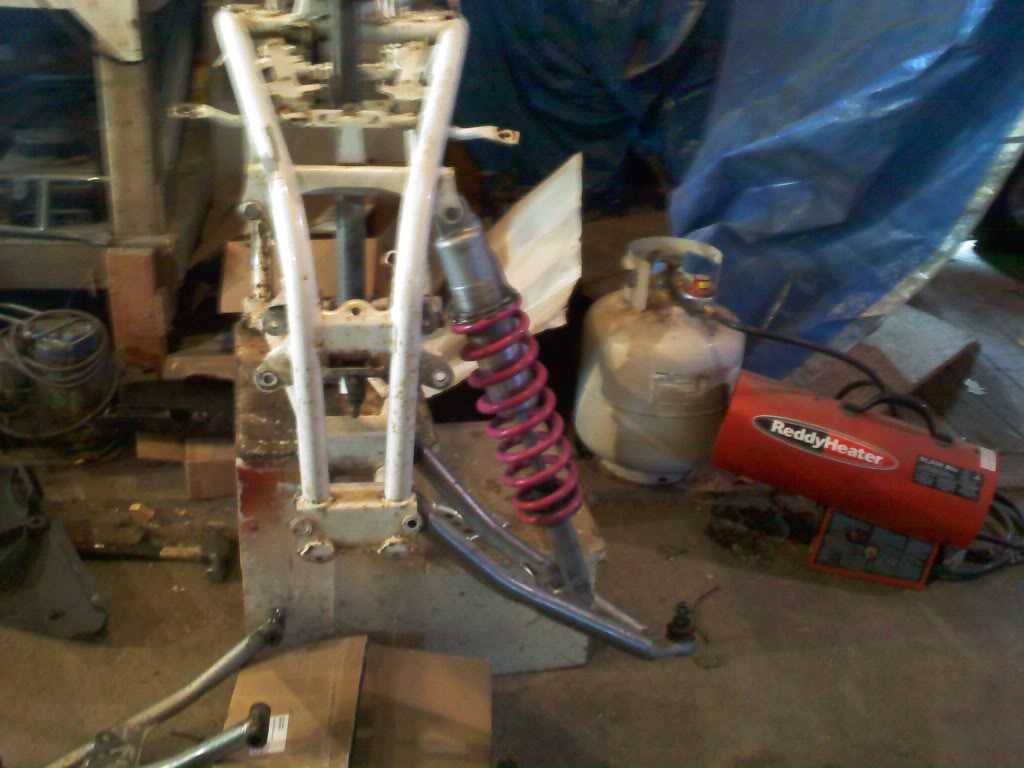

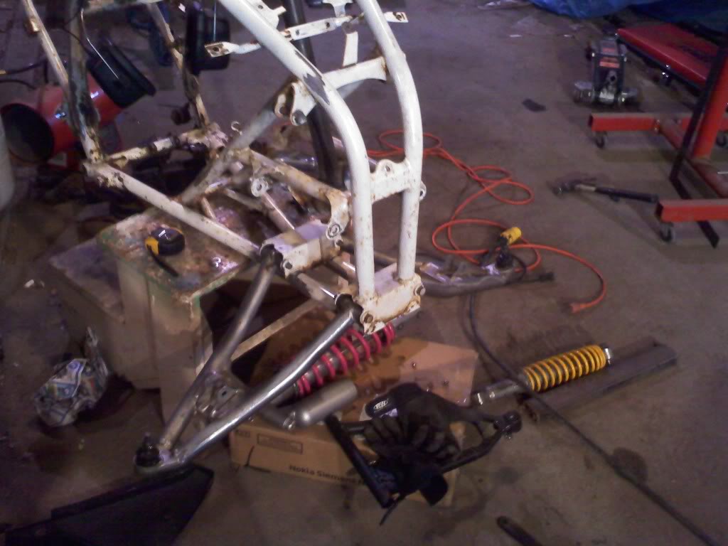

A little test fit using my 125's rear shock (18.75" from eye to eye)
I am probably going to need to lower the shock mounts a bit, but we'll see :P
Just make sure when you mount them you don't move them foreward or backward, you want the ball joints to be in the same postion that there were with the blaster a-arms. I'm sure phargle can tell you more and point you in the right direction.
moving the arms fore or aft will change the caster, and depending on what i want to do with the machine will determine my caster (gonna run it the same as the YFZ 450's so i just need to make the front arm back as far as they are stock in relation to the lower arms).

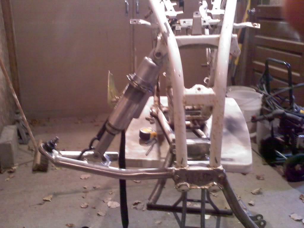

on another note, i got a touch of progress today :D Pics coming up!

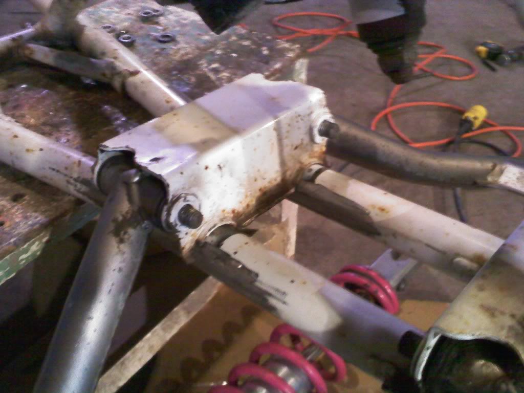

Pics!

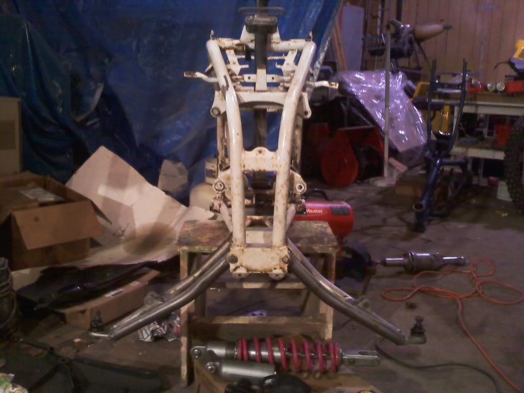

the arms will droop more than that, at the droop that i want, i will need a shock that is 18" from eye to eye if i leave the upper shock mount as it is. I need to get some dust caps on the arms and tighten them down to get the mounts to sit like they need to, then i will clamp them down and tack them in to place for the time being.
things only get more difficult with this swap. The arms have a funky offset for the mounts and one of the arms is tweaked, so instead of trying to figure out how they go im just gonna cut off one of the mounts and make it go straight across from the other. Note: the point of this build was not to use YFZ450 arms, it was to use the geometry from the front (which it will be more or less).

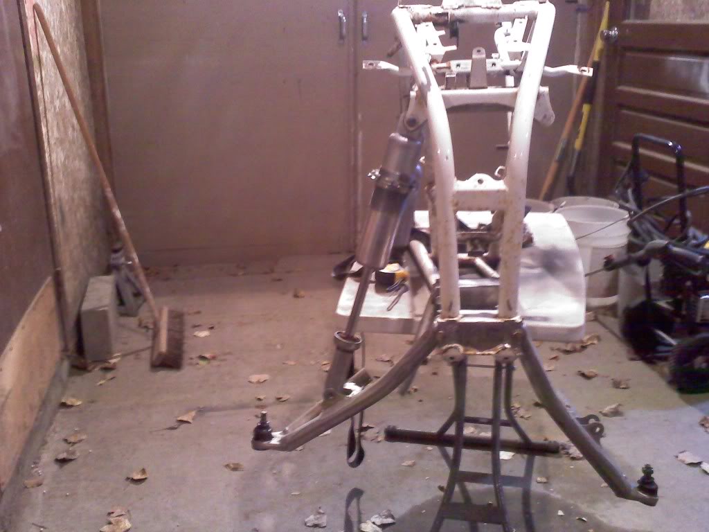

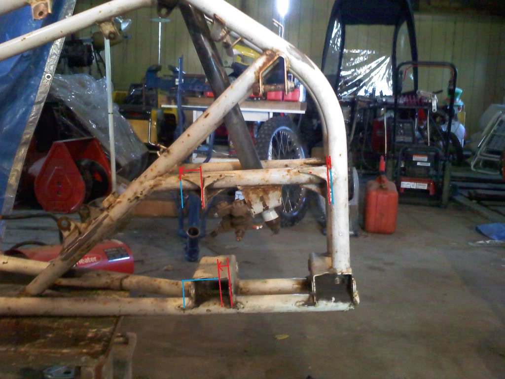

Was doing a little brainstorming today:
I measured out 10.75" of travel with that shock, so its looking about where i want the travel to be. now i just gotta track down some shocks that will work. Pretty soon i will have some spindles in my hands so i can continue to tweak my setup until i get it to where i want it.

Got a temp fix to the arms until i can find some steel tubing of the same size (aluminum tubing is in there now) just so i can see how they swivel in the mounts. So far so good!
