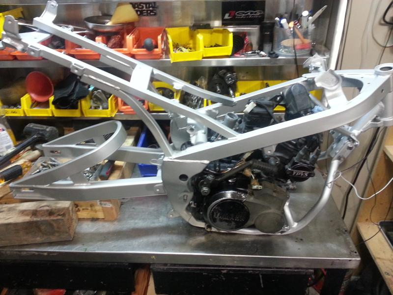

So I finally dragged the ysr stuff off the shelves and back onto my workbench. I've decided to run the DT200 and probably sell off the blaster engine I spent so much time rebuilding/restoring. Now i've got to find a rad that'll fit nice and tig up some brackets for it and the power valve motor. This is just the first mockup and i'm sure it'll be in and out of there a bunch more before it's torqued up. But it looks good in there...
