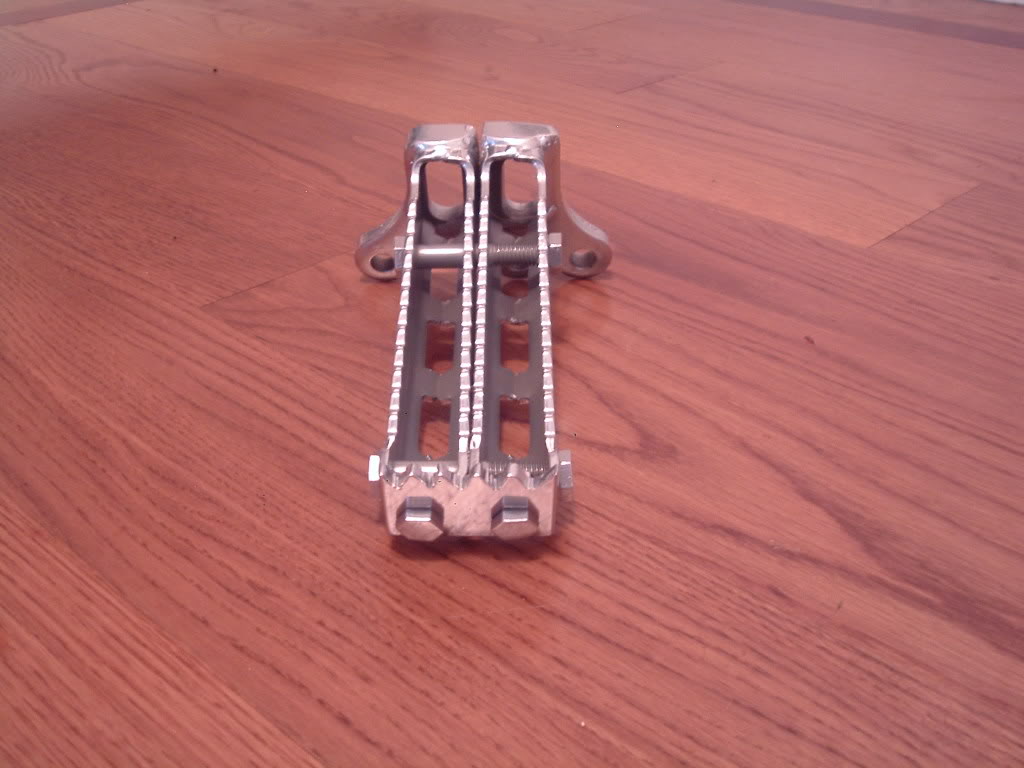

just follow these simple steps to have double the foot peg size
1.cut right at where the peg bolts up to the frame keep it as long as you can
2.use a saw or sawasall with the peg in a vice to keep it from falling
3.use the stock bolts given you you and bolt it up tight or ir you dont have them use any bolt that fits
well take another pair of stock pegs cut the ends off them so its just a long peg keep them as long as possible then bolt them up to the holes and sience they are the same peg the holes are the same so bolt them up and wala!!!! you have bigger pegs
lol thanks alot. In hind sight I should have sanded off the threads on the bolts inside but I'm just knit picking myself.
They will go with the quad if I ever sell it :-D
