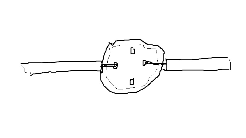

An old trick to run a motor with a weak spark, especially useful if a motor is continually fouling plugs. Works great on a 4 poke that is burning lots of oil.
Use a stranded copper HT lead and insert a small button as depicted with about 1/8" between the holes.
Of course it is no substitute for a healthy ignition system, but it has filled a gap for me a few times.

I don't blame you, I only posted the button idea as a stop gap method when all else fails.
