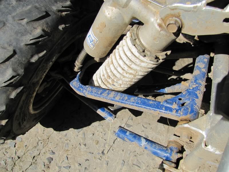

yeah it is a good thing your ok, thats the important thing, but i know when i wreck and people ask me if im ok, im only ok if my bike is! Lol and nice damage man, thats worse than when we split the frame of the 420 !
