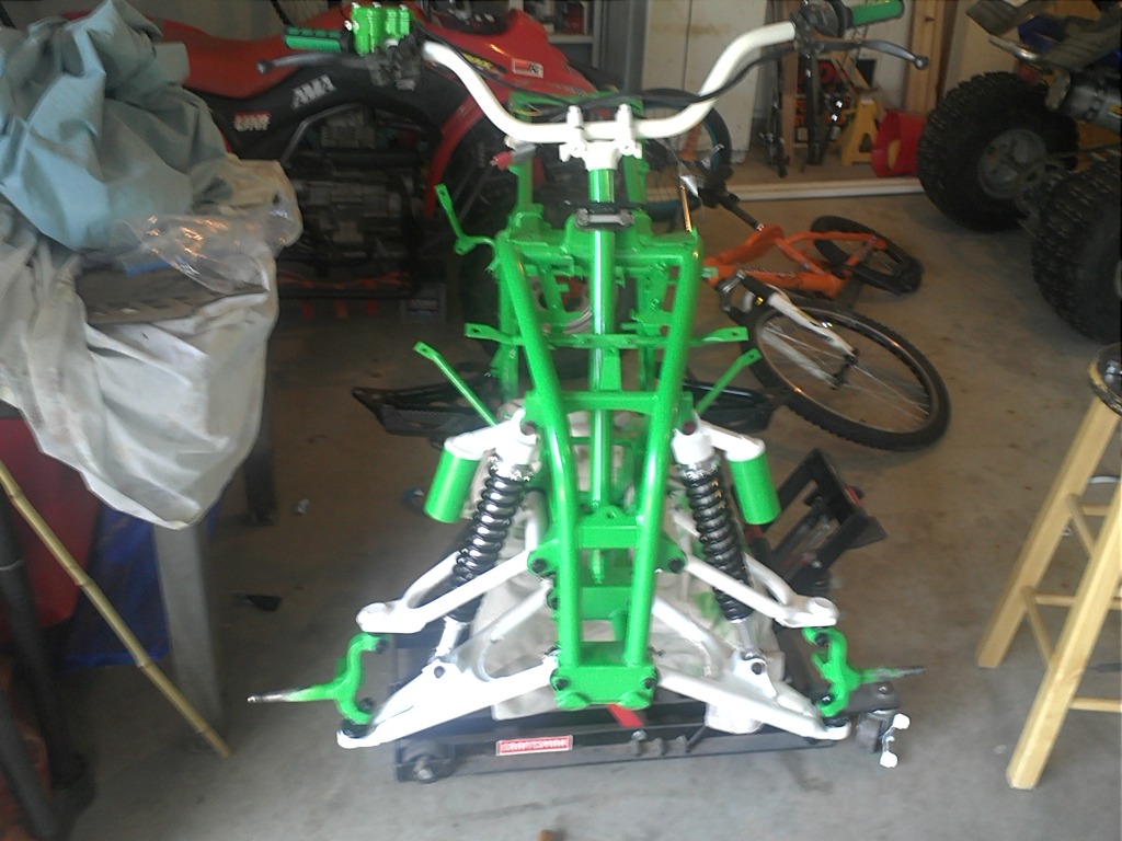

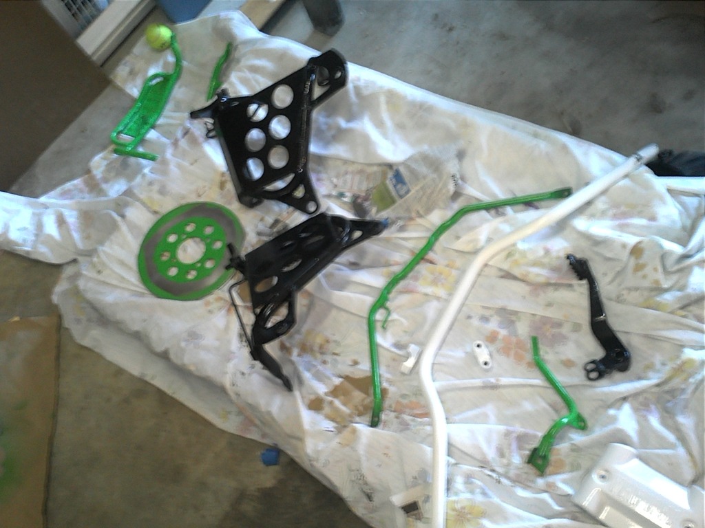

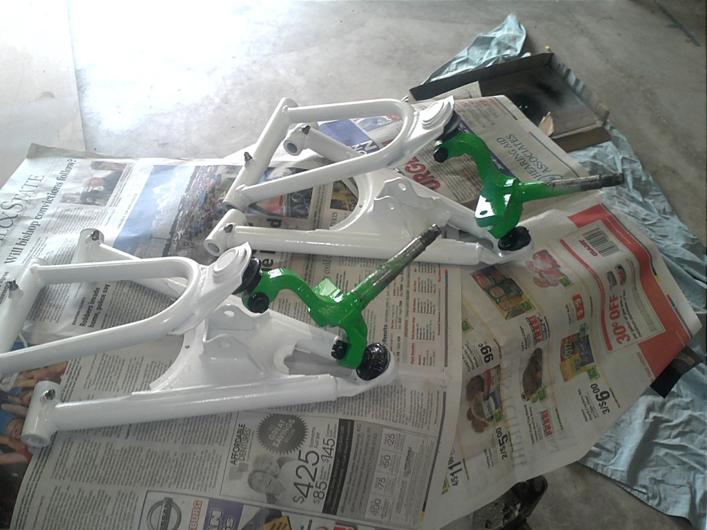

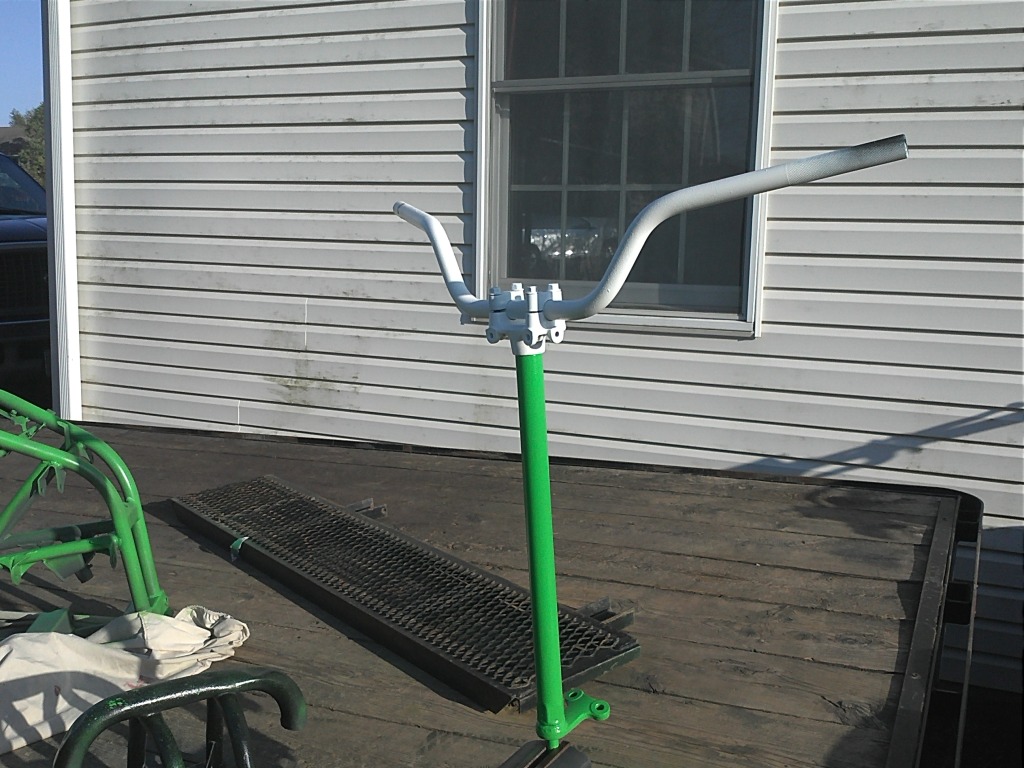

Well I haven't updated this for awhile so I thought I would. I have all the parts painted almost. Just have to paint tie rods,carrier and wheels and hubs. I started reassembly today. I have the a arms and spindle put together and should have them on the frame by the end of the day. I also have the stem bars and controls installed and I also got the foot pegs put on. Hers pics of it with the stem and a pic of the a arms and spindles. When I get the a arms on it ill get a pic so it shows the foot pegs,bars and a arms all on the frame.
What color plastics do you guys think I should go with? Right now I have blue but I think they would look stupid on there and they're not in very good shape. I was thinking either black or white plastics. I didntreally want to paint a set of plastics then have to worry about scratching them. So I need to decide if I should keep it just two colors green and white with the white plastics or bring in a 3rd color and do green and white with black plastics? What's your opinions
i put the blue on today just to see how they look and they just dont go with it at all. i think im gonna go with black but im gonna wait until more of its put together before i decide if im definatly going with black. i put the swingarm,axle,carrier,rear shock, tires and wheels on today and tie rods. the carrier and axle arent painted yet but im trying to get it into a roller so ican convince my dad to let me buy a pitbike. he said it had to be put back together before i got one but he hasnt taken me to get the cylinder measured and bored and honed yet so i figured if i have most of it together besides the motor maybe he'll let me get a pit bike.
