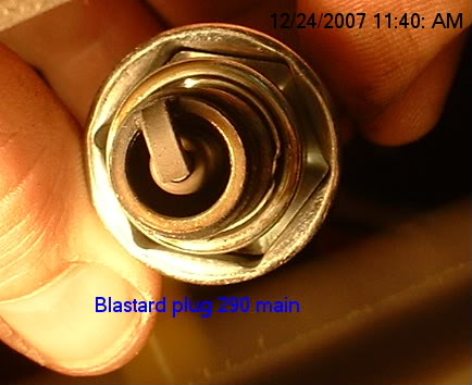

Here's a pic after a good plug chop on the newly broken in Blastard :
290 main needle in the middle airscrew 1.5 turns out .I never even checked the pilot but it's jetted right. FMF Fatty Gold with Power Core II silencer stock gearing and K&N airfilter in the stock air box with the lid removed. 2nd gear power wheelies are effortlessI:II:II:II:I
Oil Klotz R-50 at 32:1
