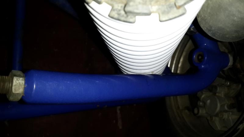

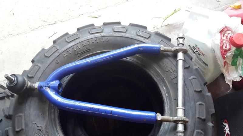

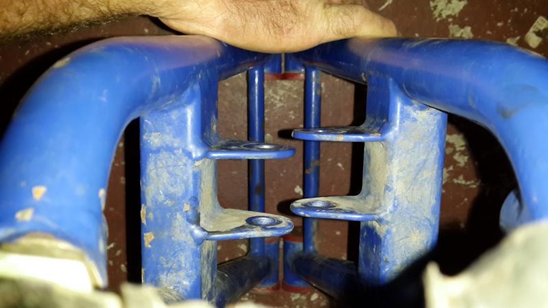

Having identified a problem with my spring being VERY close to the left hand A-arm, as such:

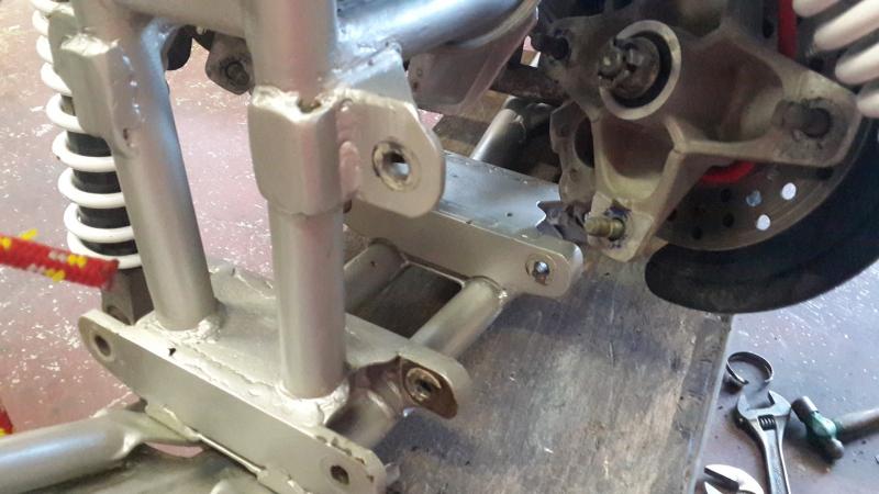

I finally found that the cause was not my frame of any of my my 450 weld mods, but rather the a-arms themselves! I identifed that the bottom shock mounts of the a-arms were 10mm different between the 2 arms, meaning the right hand shock was positioned further forwards than the left!! NOT COOL!! Im going to have to cut off the mounts an make new ones in the correct position.

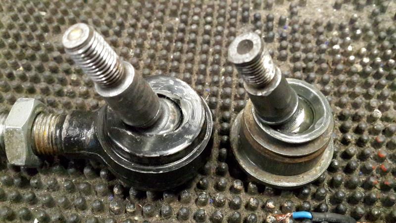

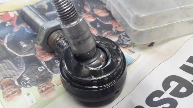

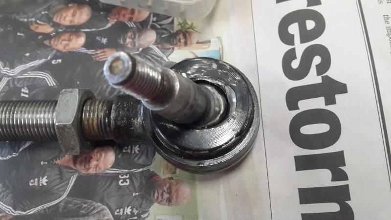

While I was at it, I ripped off the balljoint boots to see what the problem was, my new ones have just arrived so I can rest at ease. What I found was interesting, its obviously a bad quality balljoint and has limited angles of movement, so with suspension travel, the shaft has hammered into the aluminium housing and burred over the edges inside and out, this burring on the inside has tightened up the balljoint and restricted its movement.

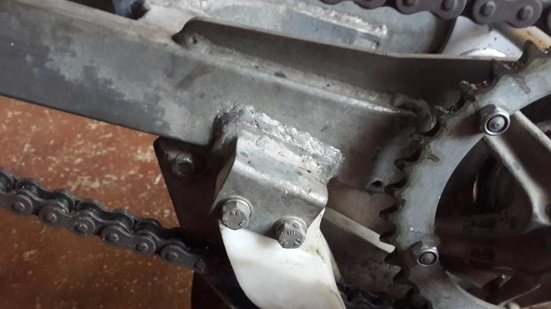

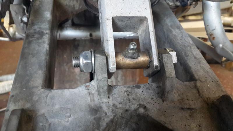

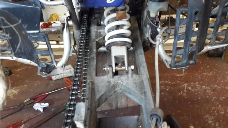

In other news, my swinger is doing well, although it needs a polish, im not going to worry about that right now, otherwise, its holding out beautifully!
On the front suspension front, all YFZ450 welds are doing well no cracks at all,
The one thing I did notice, is that the tubes that run through the bushes on the bottom arms were obviously too short and have worn as they have rotated with the travel of the arms, the idea is that the tubes are clamped by the bolt between the frame and the bushes move on the tubes, this hasnt been happening and made my suspension rather hard as I have been tightening up against the bushes instead of the tubes! I am having new ones made to correct this problem.
All seems good on the upper arm department!

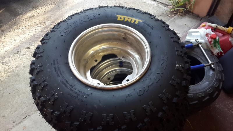

In other news, my new 23x7x10's have arrived, they are going to climb like a boss!

those RS ball joints are supposed to be good
finally we get to see the effects long travel suspension has on limited travel ball joints, hence why some use heim joints.

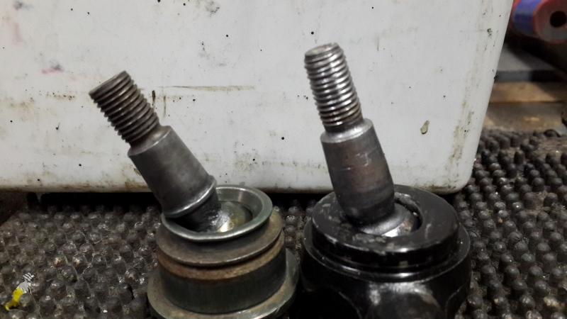

Hi Awk, been a while. Indeed long travel on B-Grade ball joints! I must just add that I have checked the standing angles of the ball joints and they are sitting nicely in the middle. In other words, they are not stressed when the bike unloaded and in a neutral position. So this is definatey a case of travel exceeding the capacity of the joint.
It was interesting to compare my worn ones with that of a standard yamaha 450 ball joint. Standards ones have FAR more angle of movement than these thing. Il post a pic soon!

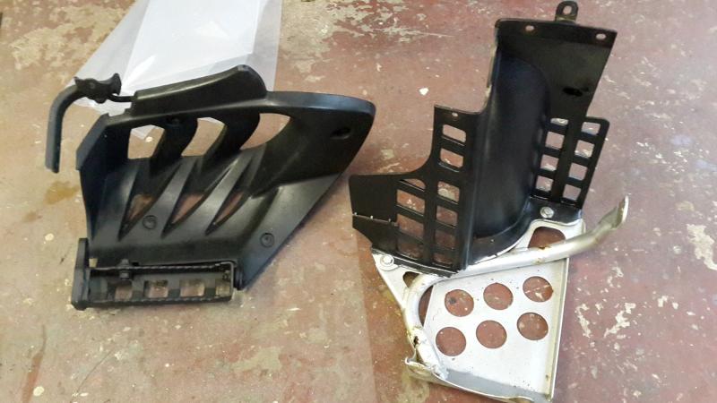

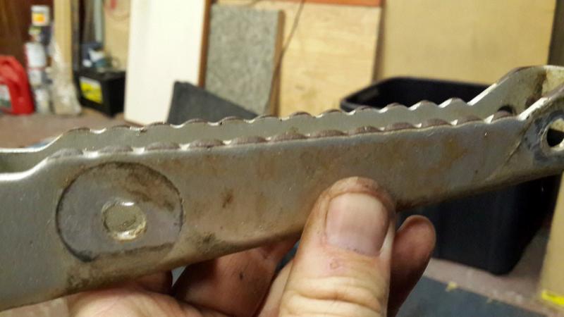

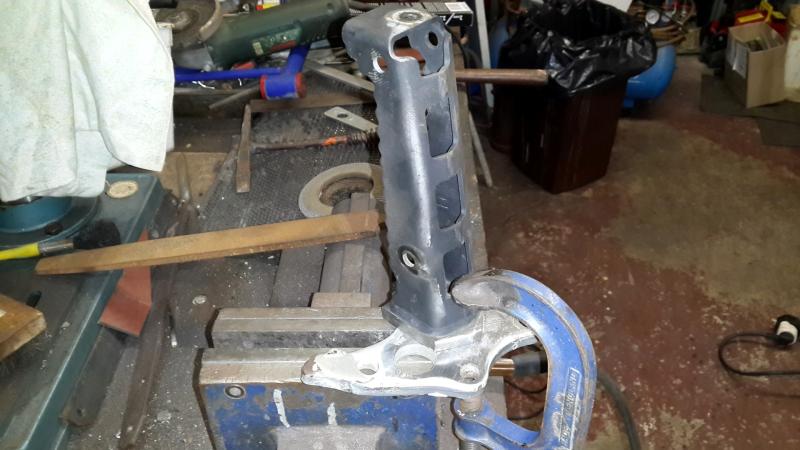

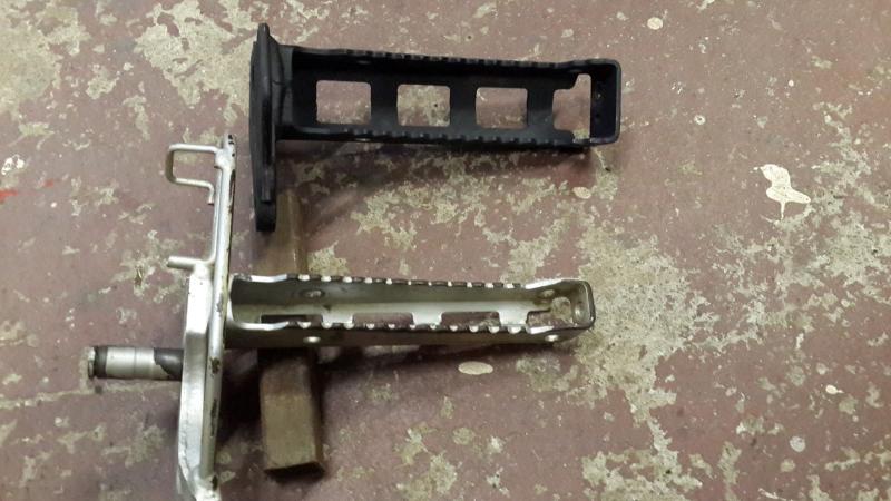

Well Yesterday my new YFZ footpegs and heelgaurds arrived, so while im waiting for tie rods and new a-arm bush tubes, I decided to get stuck in with fitting them. Now I often see guys fitting heel guards, and other custom foot pegs but I decided to cut off the old blaster pegs and and 450 pegs and weld the 450 pegs onto the blaster mounting brackets. Now I didnt get around to finishing the job, but I made some good progress!

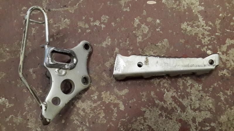

Here is the new and the old:

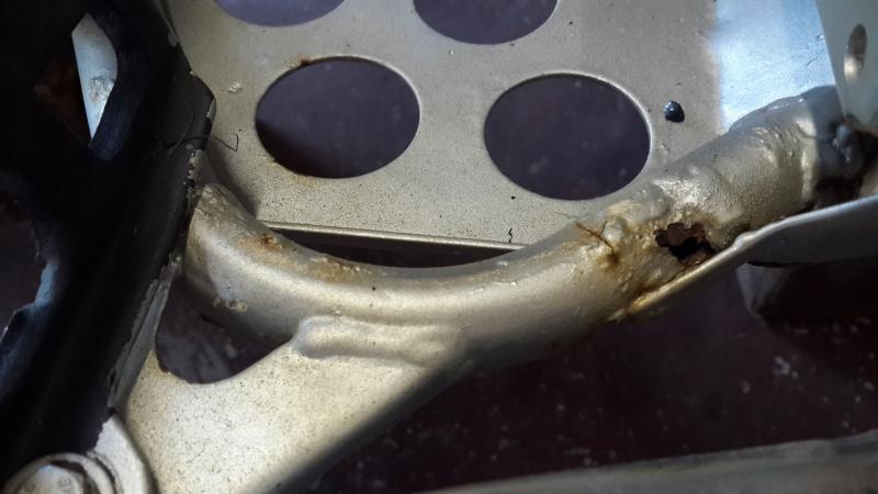

Check out how smooth my old pegs were!

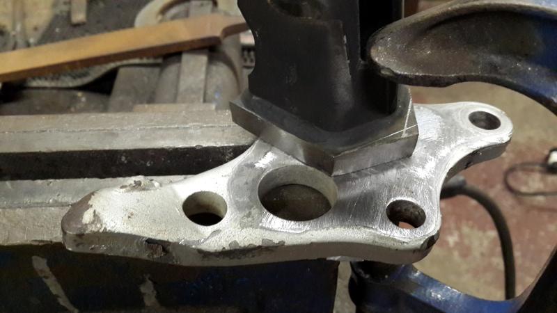

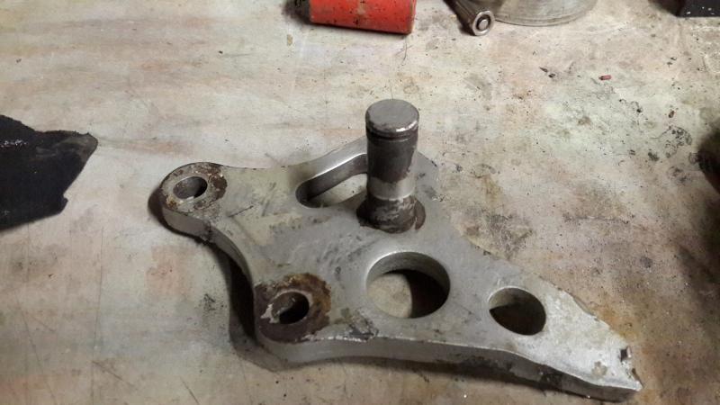

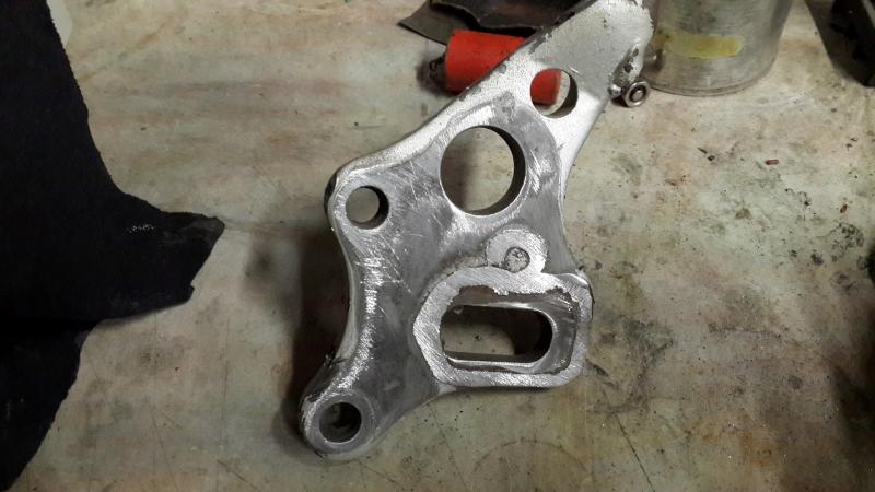

I then went and cut my old pegs off their brackets:
Then I cut the YFZ pegs and filed both to fit smoothly before welding:

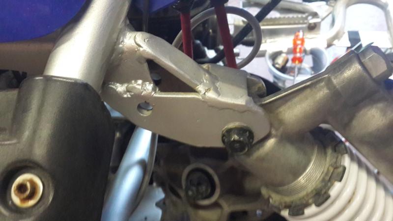

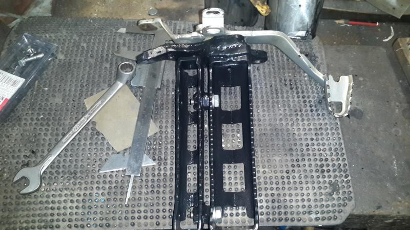

I then tacked them together and did a test fit, this is where I left it, although I have cut and prepared the other side as well. I used my nerf bars as a guide to ensure the peg is welded in the right place, because the nerfs mount onto the pegs and are fixed at the front, so they have to meet the pegs or else they wont fit. this ensures both sides will be equally positioned (as well as measuring of course!!)
Should be finished soon and is actually one of the easiest mods Ive done! very straight forward. I still have to deal with the heel guards as I have Blaster Nerf Bars on, with interfere somewhat, but I have a plan to get it right, il keep ya posted.

In other news, I mentioned I would be showing you the stock Yamaha replaceable balljoints off a 450 and that they have more travel, note the "bowl" design around the shaft that allows for maximum travel, then notice how these non-replaceable ones dont have that and how little space for movement they have!
Check out the extra angle of movement the Yamaha joints have. Yamaha For The Win!
The bad news is that the new Ricky Stator Ball joints dont seem to have as much movement as the Yamaha ones. In fact they seem to resemble the old ones...I will just have to see how long they last!!!

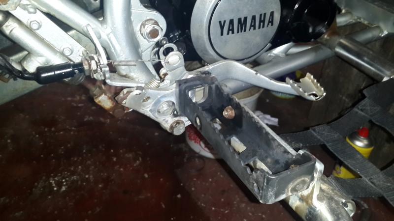

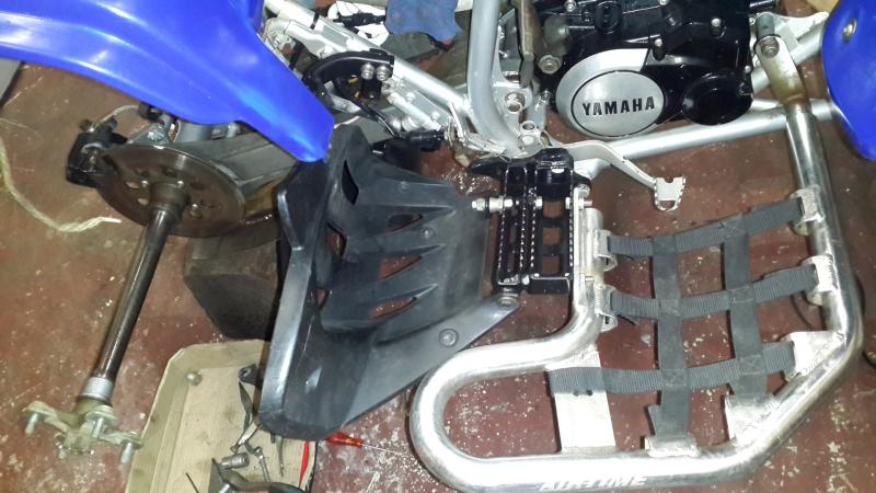

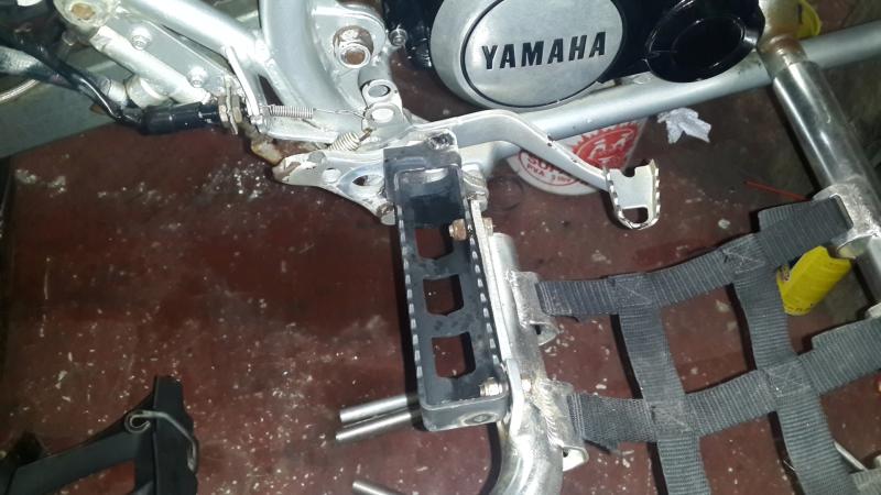

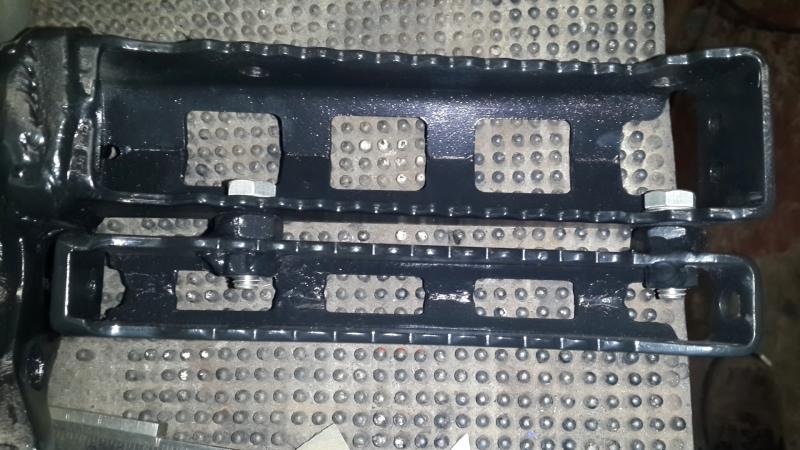

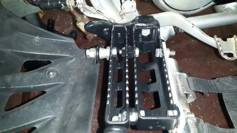

Well, made some headway on the footpeg/heel guard story, my dad has been fiddling with brackets etc while im busy and unable to work on the bike so its been great to get some help and keep things ticking over!
I ended up deciding that it would best to use the blaster footpegs as well as the 450 ones, I bolted the cut off blaster pegs onto the 450 pegs using nuts I tacked onto the blaster pegs to act as spacers between the pegs. I Chose this route because of the nerf bars which got in the way of the heel guards, so it was either I make a spacer bracket or double up on foor pegs, I thought more stability is never a bad thing!
Right hand side is almost done, the left is still in infancy stage but will be easier than the right. Im still waiting for my new tie rods and a-arms spacer tubes, then im good to go!
