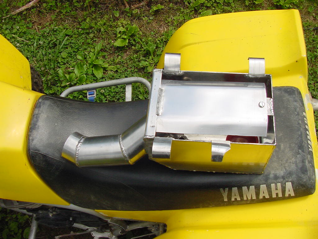

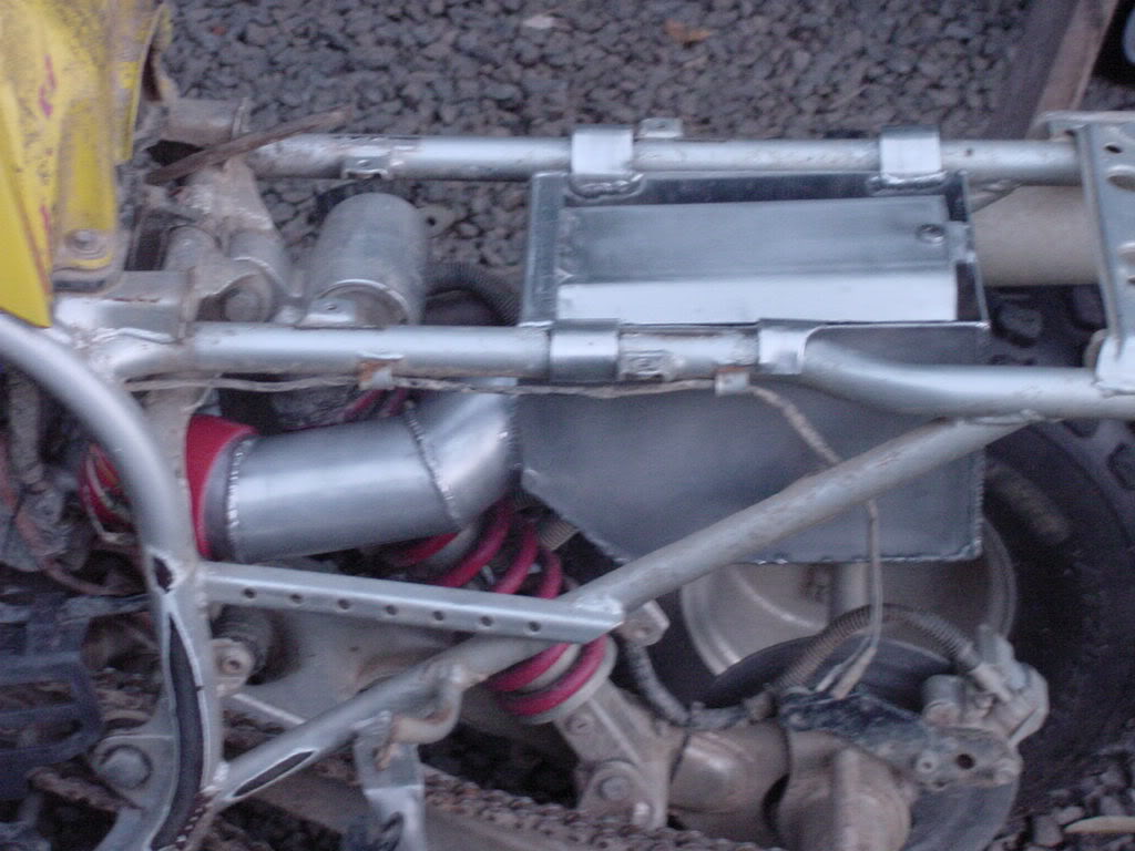

Not just weld....
Buy the material $120 for a 4'x8' sheet
Cut the material to shape (plasma cutter or friction wheel for those of us who aren't blessed enough to know an inexpensive laser cutter)
Form the box ( I don't have a press break, I actually do it in a vise)
Weld the sides on (A/C tig welder..... nuff said)
Buy a slip roller
Roll the tube (yes, that's hand rolled in a slip roll)
Finally, fit it into the frame, around the shock, and lined up with the carb.
Really....... easy stuff.

This is the one I was looking at Air Box Cover by Outerwears Blaster 200 New Allows More Air Into Air Box QPS | eBay After some more research I realize that it just velcros on. I dont really like that solution since I'll be riding sand. I'm going to take another look at my box and figure out how to rivet this one in place or spring the money for the EHS lid. I also need to find a new hose or plug for the bottom of the box because it has been missing since I bought it.
