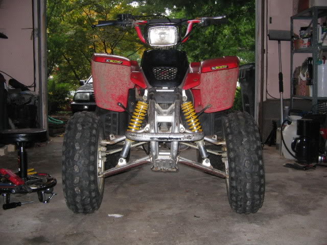

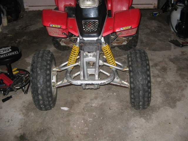

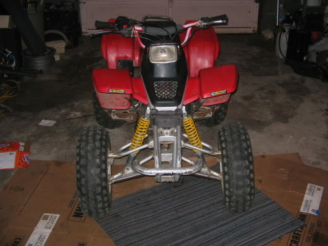

Well from looking head on at my blaster..my right front wheel is bent..I thought it was the wheel bearings, So i replaced them..and it did help some..it did not fix it as you can see..Heres what it looks like
From the pics you can see the wheel is bent in a little bit on an angle..I could use new upper control arm bushing\bearings but i dont think that they will fulyl straighten out the wheel..I am going to do them because the do need to be done..but im wondering what would cause the wheel to sit like this? Hopfully you guys can help..thanks
-Jon
oh yea we can help.
so your wheel is not bent, it is completly natural to be sitting that way.
However they may be out of adjustment.
there are two ways the wheels adjust, Camber and toe in
Camber will look like / \ from looking at your quad from the font (this pic is exagurated of course) the slashes representing your wheels and tires.
Toe in would also look like that but from sitting on your quad, standing up and looking stright down at the tops of your wheels.
You want some degree of camber, b/c when your suspension compresses (specifically when turning) the camber will in a sense be gone. Camber is adjusted by moving your top ball joints in or out accordingly, and sometimes adjusting the bottam ball joints is necessary also.
toe in can be very very slight - you dont want toe in to be over exagurated.
toe in is adjusted via your tie rods and the length you have moved the ajusting nuts out or in.
hope this helps -
(you might want to pick up a clymer shop manual for the blaster)
I just realized that Stock a-arms dont have adjustable ball joints. If your camber is equal on both sides of your quad your ok.
Thanks..I guess saying the wheel is bent was missleading, I know its not bent but like you said my camber is way off..The right wheel is definatly "toe in" and the left wheel looks to perfectly straight.. I do need to pick up a manual..I will look in to the one you suggested.
So with a stock suspension..what is my best bet to straighting the wheel out, adjusting the tie rods? I plan on re-doing all the bushing and bearings on my A-arms as most of the bearing\bushings on the quad are shot..but this is my main focus rite now becuase the quad dosnt feel stable from 3rd gear and up..

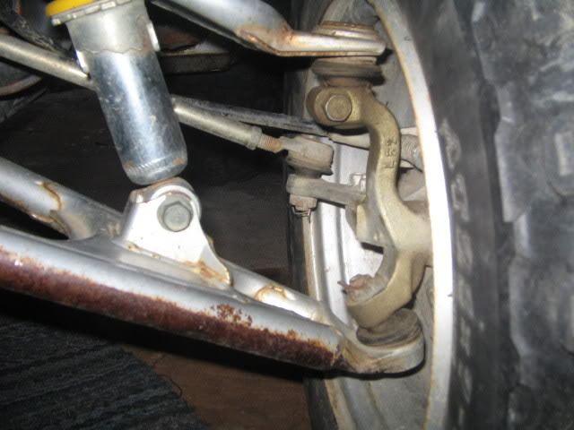

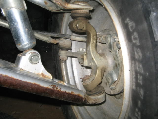

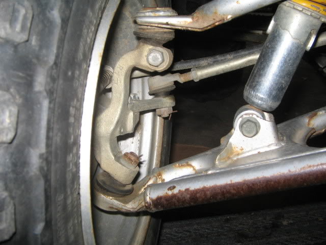

Ok i took a pic of both spindles so maybe you guys can help me..The right one (clutch side ) which is the one in question kinda looks a little off..but i want your guys opinions as well..so here it goes
This is the Brake side and what I beleave is the "Good side"
Pic 1.
This is the clutch side and the side that I beleave something is wrong with:
Pic 1.
Pic 2.
What do you guys think..
If your sure you seated the bearings completly and when you shake the wheel the wobbling is not occuring at the frame end of the a-ams. And your wheel lug nuts and the large spindle nut are all torqued to specifications I would have to say its a bad ball joint.
You would have known it was a bad spindle when you were replacing the bearings.
Does the wheel wobble when you jack the quad off of the ground and spin the wheel freely?
Yes the wheel wobbles when i lift the quad off the ground, I am npt postive its the spindle becuase I did not take it off..I just took the drum apart and put the new bearings in..and yes all the bolts are tight..Can a ball joint be easily replaced? or is connected to the spindle?
Alright, I think were close.
Since it wobbles when lifted, check to see if the end of the ball joint (closest to the a-arm, where the rubber boot is) wobbles as your "spining" the wheel then its the ball joint. If the ball joint doesnt wobble, then you have a bent spindle.
I think they can be replaced, not sure on stock a-arm though. I know I can easily replace my ball joints on my burgard a-arms. Its not connected to the spindle (except with a nut) it is however connected to the stock a-arm. If its your ball joint and you cant replace them you will need a new lower or upper a-arm, which ever ball joint wobbles.
