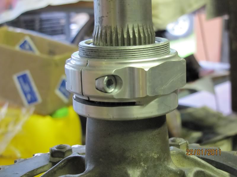

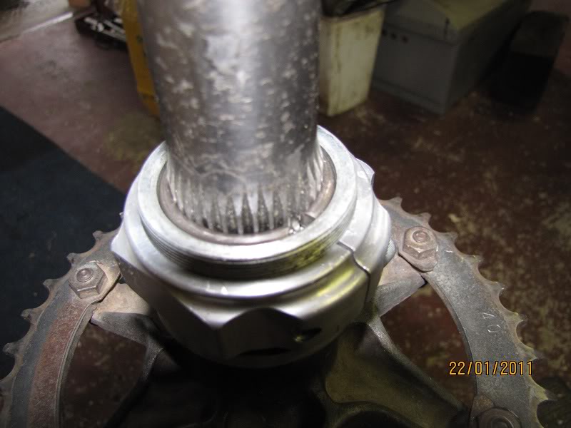

Here is the locknut gadget. make sure you put it on the right way, i waas a bit confused but checked it up on the durablue site. this is correct.

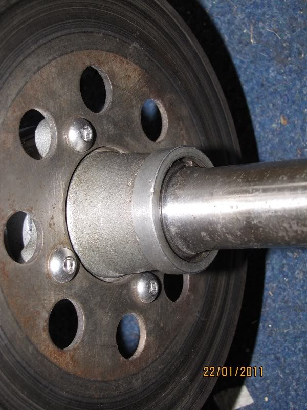

This is the c clip. you can see it down in the recess.

The hubs both have a section which goes through the seals and sits against the bearing. If that section is shorter than normal then it would allow the hubs to slide up against the carrier before the inside section contacts the bearings.

Well I just checked it all out and got everything figured out. The binding is just due to the 88-02 seal on the brake side being really tight on the hub. I thought something might have been warn due to the threads on the axle nut sticking out so far but i see blaner's is the same. I measured the axle and it seems to be slightly off center so I'm using a spacer to get it centered and also move the threaded inside piece farther into the locknut so no threads are exposed. I can post some pics if others want to see what I'm talking about.

I did some more measuring and I don't believe the axle is off center much if at all. Its hard to tell exactly because of the swingarm being off center itself but from what I could tell the axle is pretty close to centered. I just put the spacer between the sprocket hub and axle nut as you said to get the inner piece of the axle nut to be completely threaded inside.
mine is centered, that is a good idea about spacing the locknut to get the thread inside. i think il do that too!
If you have the old bearings from the axle, the inner ring of the bearing fits the axle perfect and works good as a spacer to move the locknut over. Worked great as a spacer on my axle.
