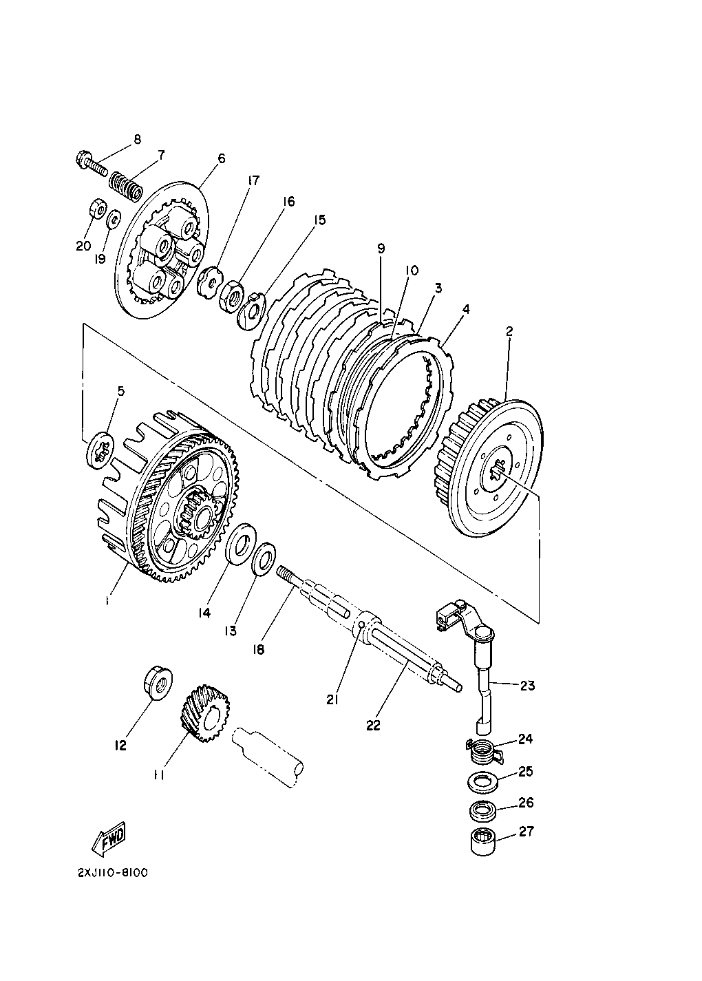

While watching kens videos. Putting together the engine. I have the cases closed, feel very confident that every piece is there that needs to be. I’m to the clutch basket. And I noticed this washer. Any ideas where this one came from?
Between my woman and the kids I’m not sure if they just found this on the floor in the shop and put it on the table but I’m at a loss for where this ones for. Haha blah, worst nightmare.
Took a stop for today, have the clutch plates in and it lined up the notch.
Have yet to do stator side and close up right side. Ideas?
Is that washer # 14 ?
I know there's 2 washers behind the basket and it won't turn if their both not there and correct
Reactions: lucknuts
i checked that one I believe. I will have to check again. I’m almost positive 14 was the spacer and 13 was the actual washer. Or vice Versa. I accidentally snapped #8 on that list so waiting on those to come so I can close the rest up. Thanks for the response!
