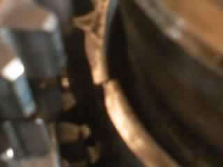

Well I split the cases today went reeeaaalll easy. Didn't have to even get a screwdriver out. just tapped it once and they split. Then my day went to sh*t. When I was inspecting the cases I found this little gem,
So What are my options? Im leaning towards getting a new left side case. Thats why it was burning oil like crazy!!

Well Im getting the case welded. I dropped it off today. I had a brain fart, the g/f grandparents own a welding shop. =)) Probably gonna have it done for free b/c they think Im great. HAHA My rebuild kit comes wed so most likely by this weekend or monday I'll be riding!!! Hope it goes back together as easy as it came apart.
