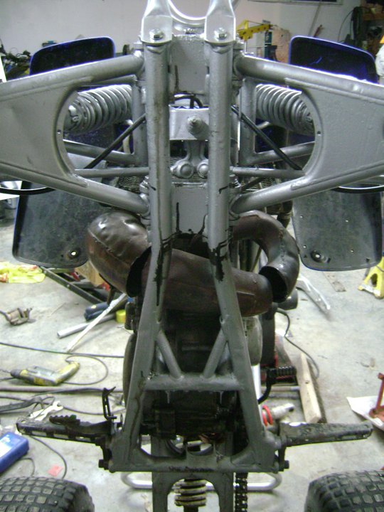

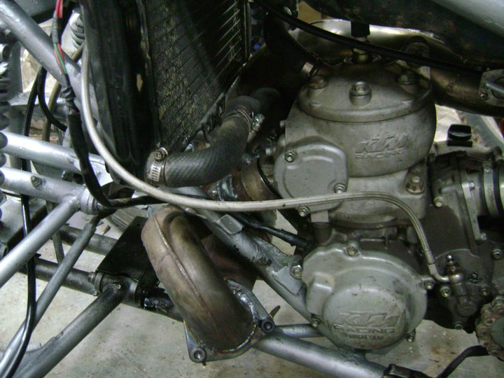

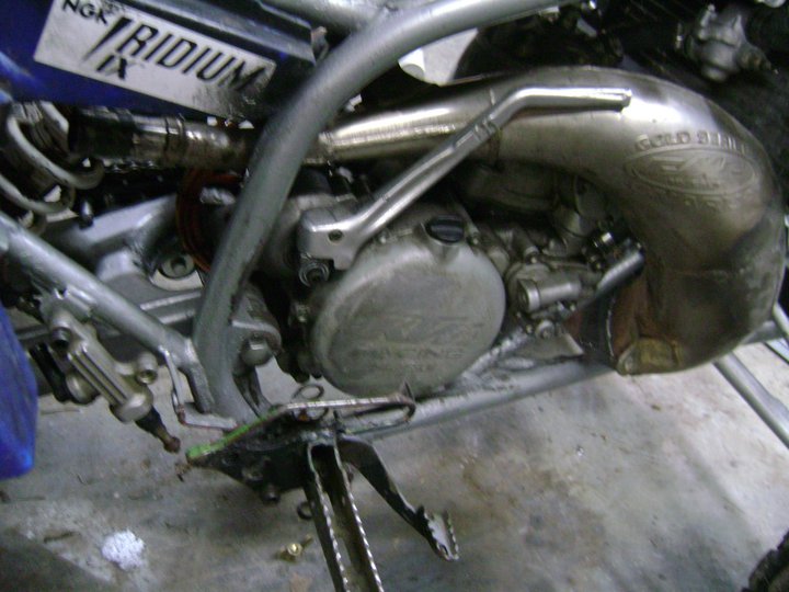

Some picts that might help. I added wedges to lower the powerband a bit.Like the guy said, 1" = 1000rpm lower, about the most you'd ever want to drop the powerband.
Steve
Several wedge type bends within the area that you can get by with just one would be better. Time spent here will not disappoint. Don't hack it, whatever you do.
