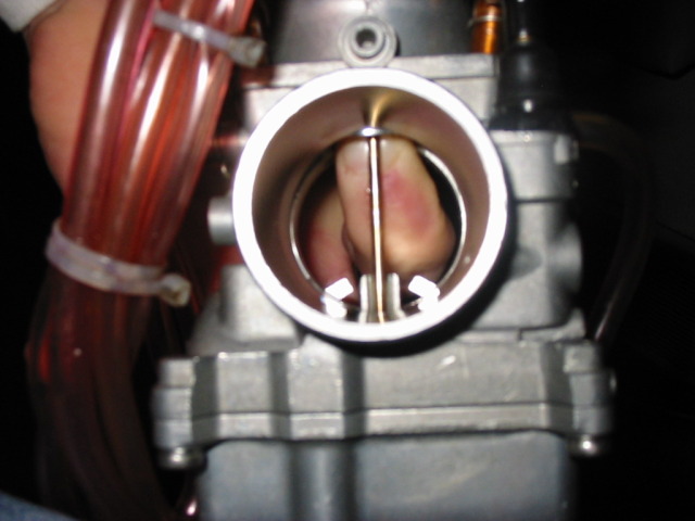

I was having a high idle problem when my blaster is cold so i decided to pull my carb apart and clean it today see if i could find anything wrong. And get the busco off of it. I also lubed the cable and went through the thumb throttle too just for chits and giggles. when i put it back together i tested to make sure the cable was adjusted properly to get the slide out of the throat of the carb but even though the cable was pulling the slide as far as it would go it still hangs in the throat about 1/16 of an inch. Is this normal? most carbs i have dealt with the slide leaves the throat completely at wot

I had the thumb throttle cover off so i could see if the cable was pulling the slide as far as it would go and I tried to push it up further with my finger. wouldn't budge. maybe i'll get a second cap gasket to help space it up. it's not far at all. just bugged me

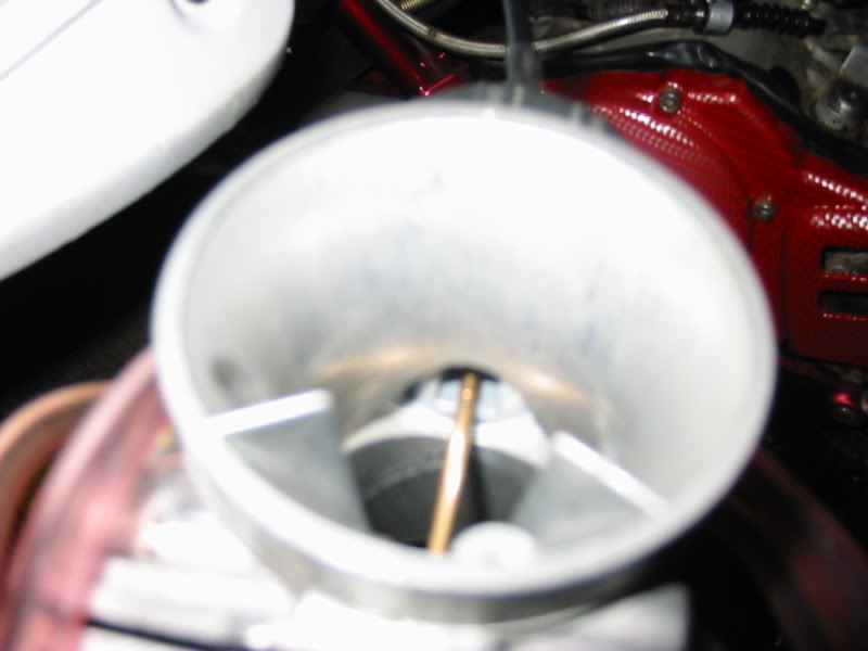

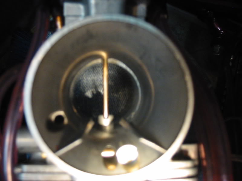

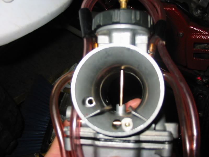

Going to get check my 35mm a/s right now so you say that you cant even pull the slide up manually ?
I just checked mine manually had no problem with the slide going all the way up so it's not visible- pic belowV
Slick I can see the slide just a bit in the throat of the carb. exactly where mine stops
