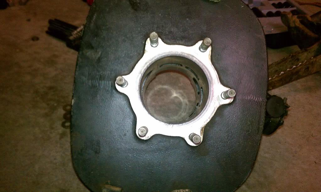

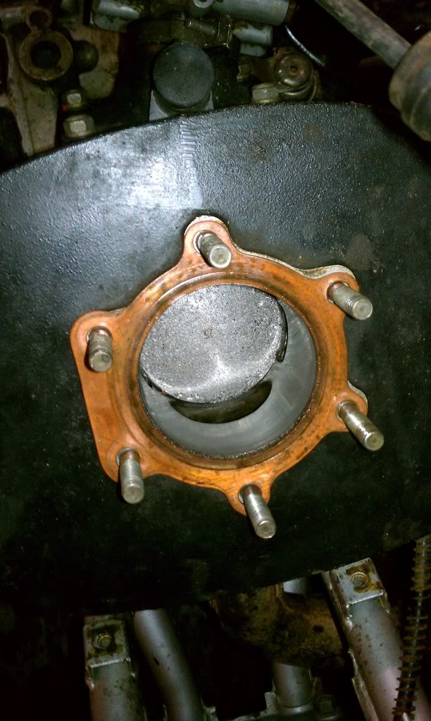

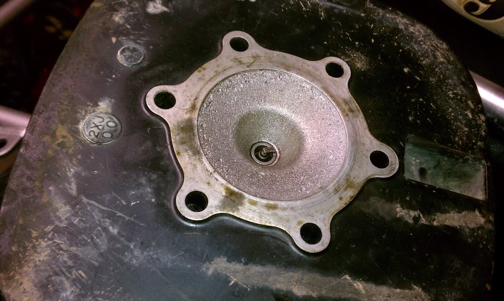

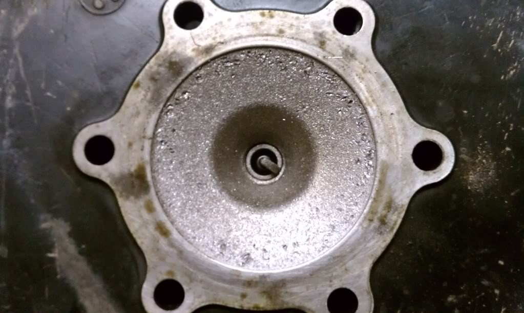

Here is what the Head looks like
Had to work til 2:15am so decided I would have to start again on her tomorrow night, hopefully I can get the jug off with some help!!
looks good, the nicks on the head and top of piston are NOT normal wear and tear and are probably the result of a piston skirt failure, you will see that when the jug comes off, if so, you probably are going to need to split the cases to get it clean...lots of work awaits!!:)
sorry posted before i saw the pics...did you clean off the piston top and the head? it shouldnt be that clean. maybe previous guy cleaned it.
barrel looks ok still, so perhaps it has been runing very very lean and preigniting, hence the pickled surfaces!
Nope pulled it off and thats what it looked like! Maybe other guy did mess with it not sure...... and the piston does not move from that position at all!! So the nicks and gouges are NOT normal then?? And what are the chances the crank is busted?? Not that big a deal got another bottom end Im swapping out anyway, also will the jug need replaced?
shouldne need to replace the cylinder. bottom end may be stuffed, best to build up one good one from the bottom up. more pics when its apart will help

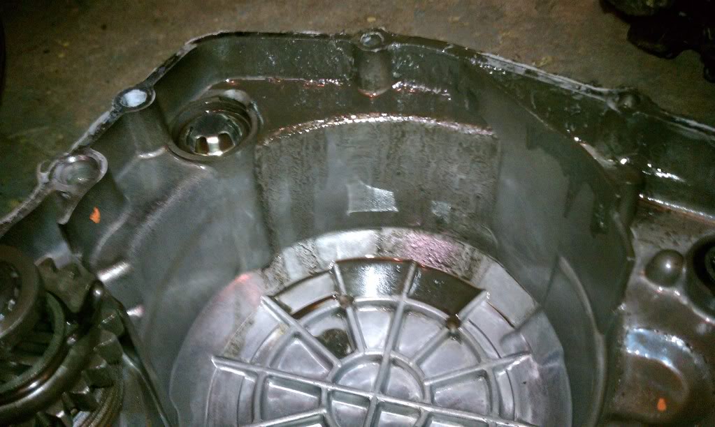

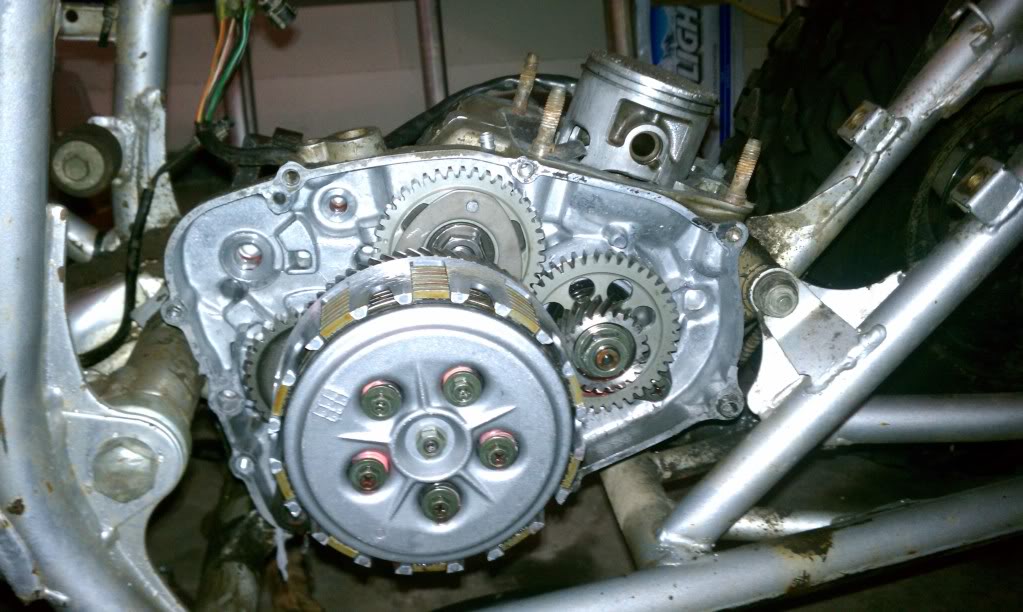

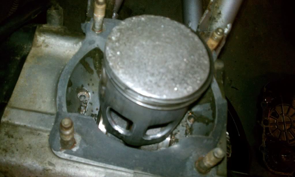

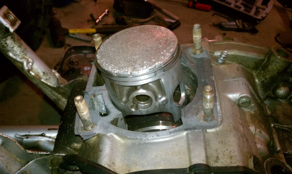

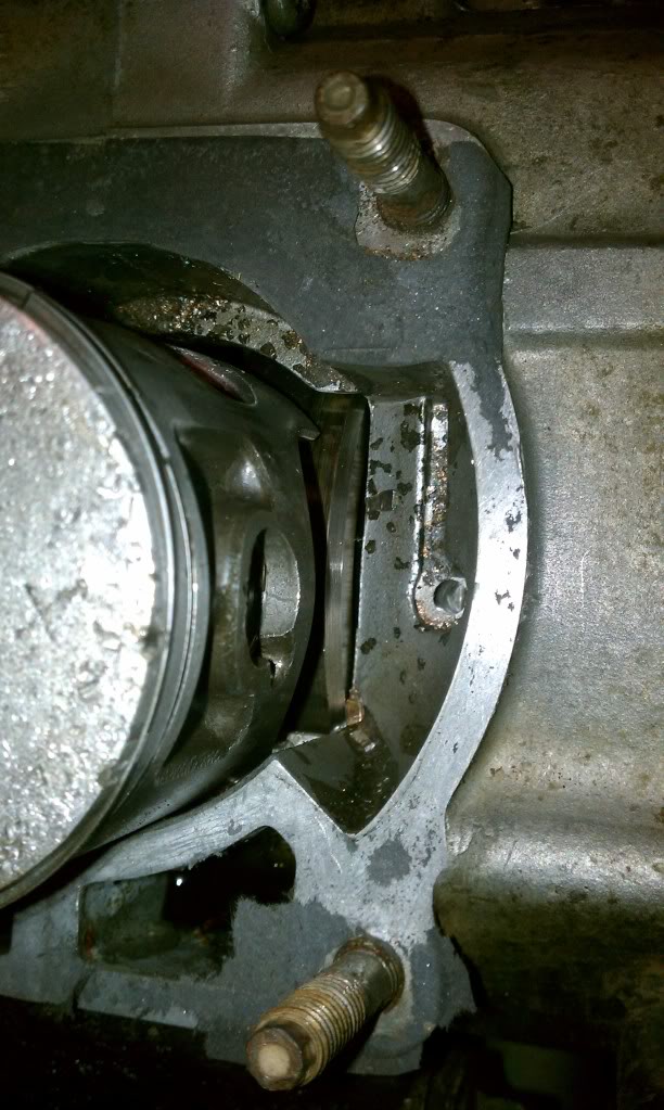

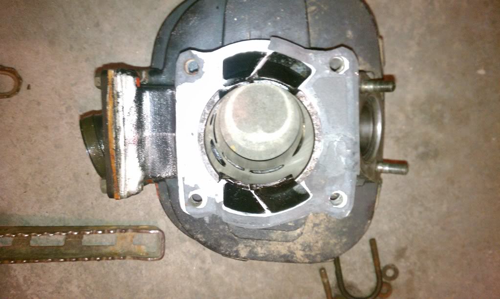

Alright so I finally got around to getting the jug off!! Wasnt too difficult, though Im thinkin its not the piston rings that went bad with it. The rings were still in and didnt seem to be too bad a shape though it is impossible to move crank and piston at all! Also there are copper/steel chunks, slivers, shavings and whatnot around the piston hole! No idea what it could be! Maybe crank busted?? Also when I drain the oil and took off clutch cover it seemed to me that it was watery oil and inside the cover seemed to be muddy sandy stuff?? So maybe they took it for a swim?? I have no idea bjt thats what Im guessing, unless it could have been something else?? Also will my head need replaced? Cuz it has all those nicks, and gouges??
pics??? probably you bottom bearing/s that are gone. dont replace the head, you can have it rechambered by ken Oconnor or just leave it like it is.

Ok so here are current pics of what I got
Clutch Cover off
Clutch cover with nastiness in it
Piston with the shaving down inside
Inside of jug
Whatcha think???
jug seems ok. looks like it ran seriously lean to do that to your piston. or perhaps all that stuff got ontop of the piston and chowed it up. looks like a bottom end bearing that disintergrated.
yoi need to split cases,
Thats the next step, I have another bottom end Im gonna use but theres a hole in its case so Im swapping out the case from this one to that one cuz the insides in the other one are good! My buddy has done splitting of cases a few time which is way more than me lol so he is gonna help me out and make sure I keep it all in order and whatnot, plus hes a mechanic pretty much and has all the right tools and pulley for the job!! so while thats getting done Il have the jug bored and order the new piston and rings!!!
feel on the exhaust side of the jug for any wear, sometimes you can feel a 'bump' as you slide your finger around near the end of the piston stroke, also you may find a ridge at the top where the rings stop their travel. that should give you an indication of wear, which helps when ordering new pistons etc
