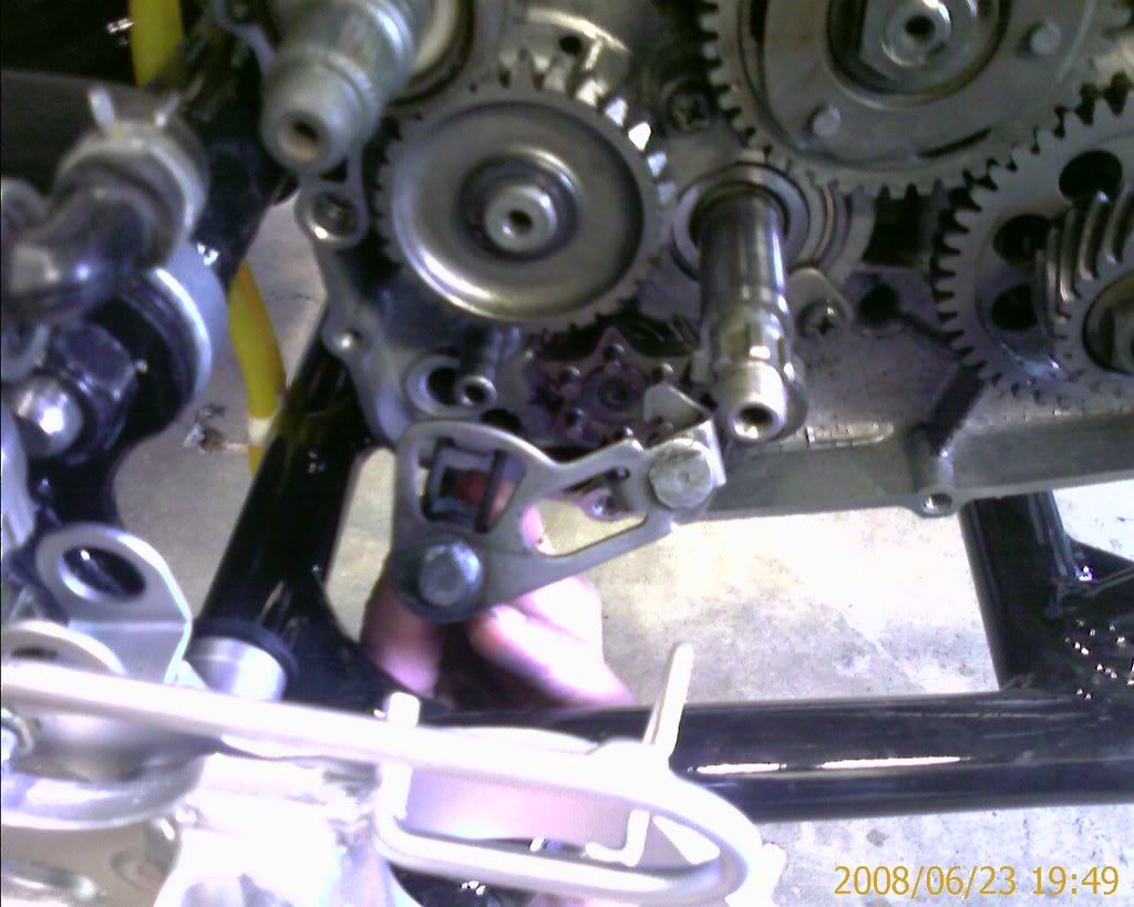

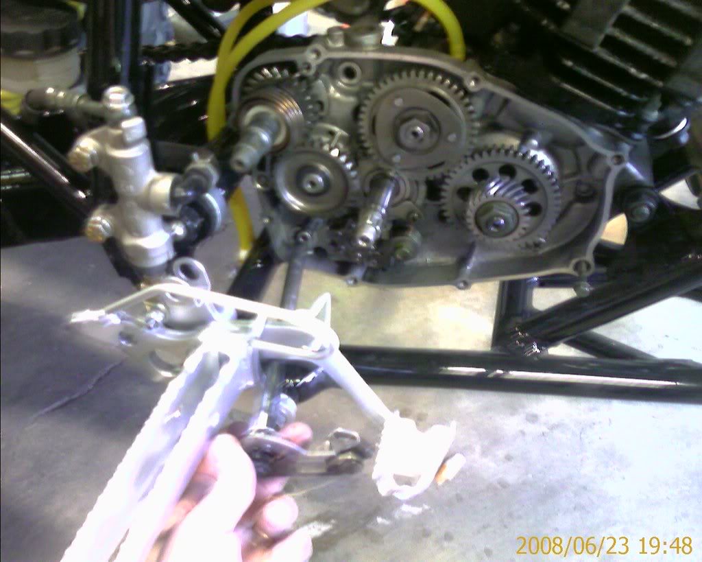

When wolfe gets off work, I'll have him take a pic of his with the side cover off.
Blasterboy, here you go, two pics of the right side of the motor were the shift shaft comes out. You will have to take the foot peg off too, (i didn't want to take mine off to take the pics. Just pull the clutch cover, then the clutch, then the shaft. You can see the peg that the spring ends need to stradle, and the star gear that it grabs to shift. Pretty straightforward when you get into it.
Good luck
