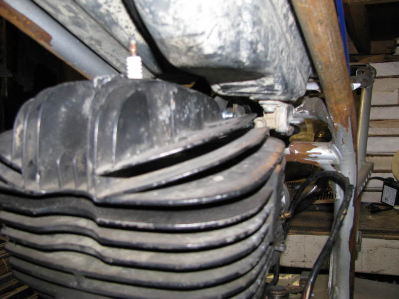

oh an i forgot to add but the motor barely clears the tank by about an inch it is a tight fit, but hopefully it will produce the power i am looking for

You might want to space your tank up a bit. I heard of some people that had their tank melt when they put the yz490 in.
yeah im spacing mine and also building a heat sheild an wraping the tank in heat tape.

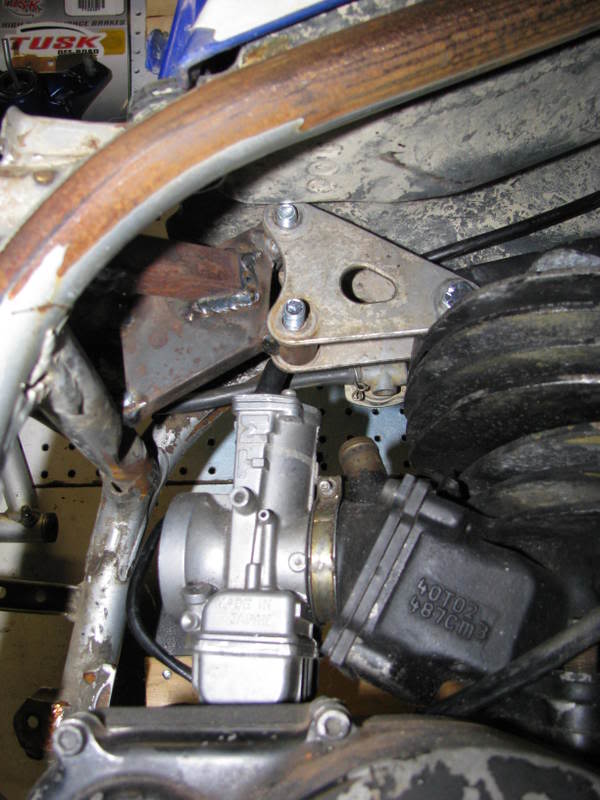

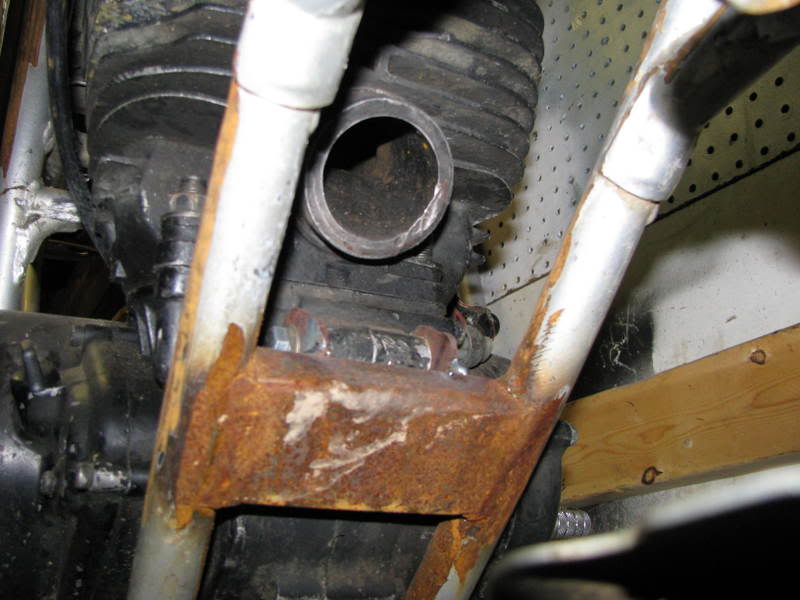

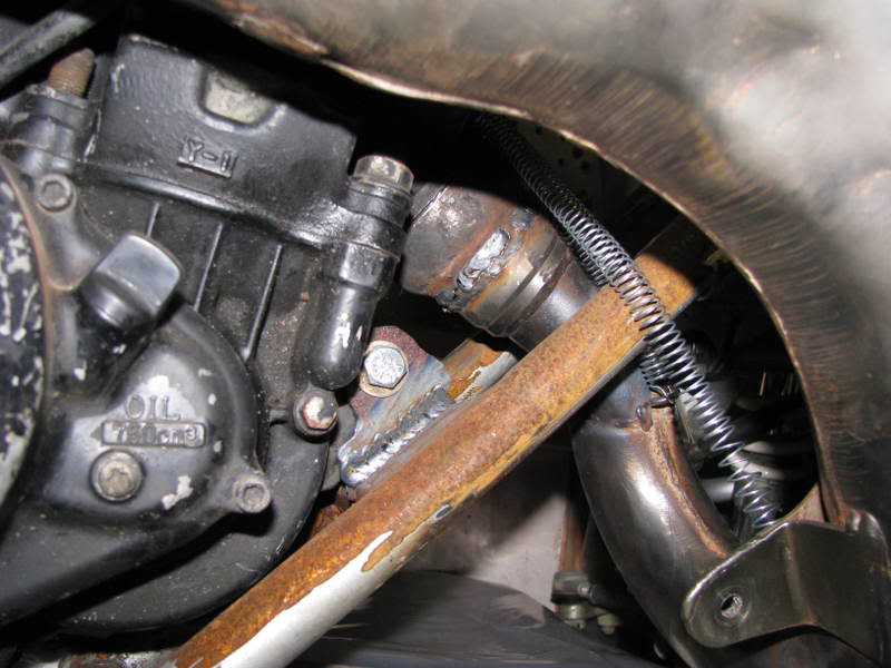

haha aiight guys i'll start a new post with all the pics i have of the mounts an everything an yeah.. i'll keep you posted. its not something you can do in a day im spending alot of time to get it right..
The yz490 from what i understand are a very strong motor they have a denation problem but can be solved by running a thicker head gasket, full race port an polish, and a good fuel. here are some of the pics that i have of the motor mounts i built for my quad. these are only the start every factory weld is gonna be gone over, there is gonna be alot of guessting done to the frame as well.
