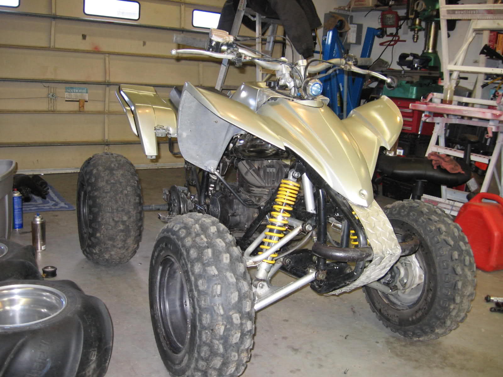

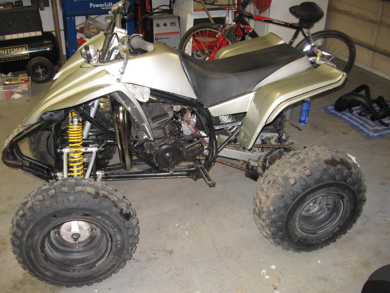

well the z400 shock needs light mods, just like 400ex. drill bottom hole larger in the shock and add washers as spacers and for the top, add washers and sleves that fit over the bolt and inside original mount hole. took maybe 20 minutes for me.

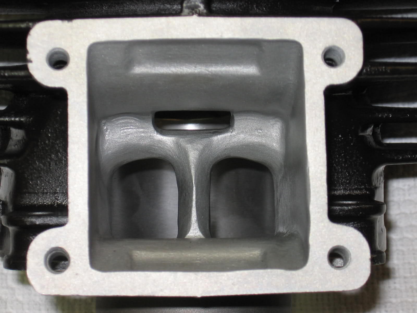

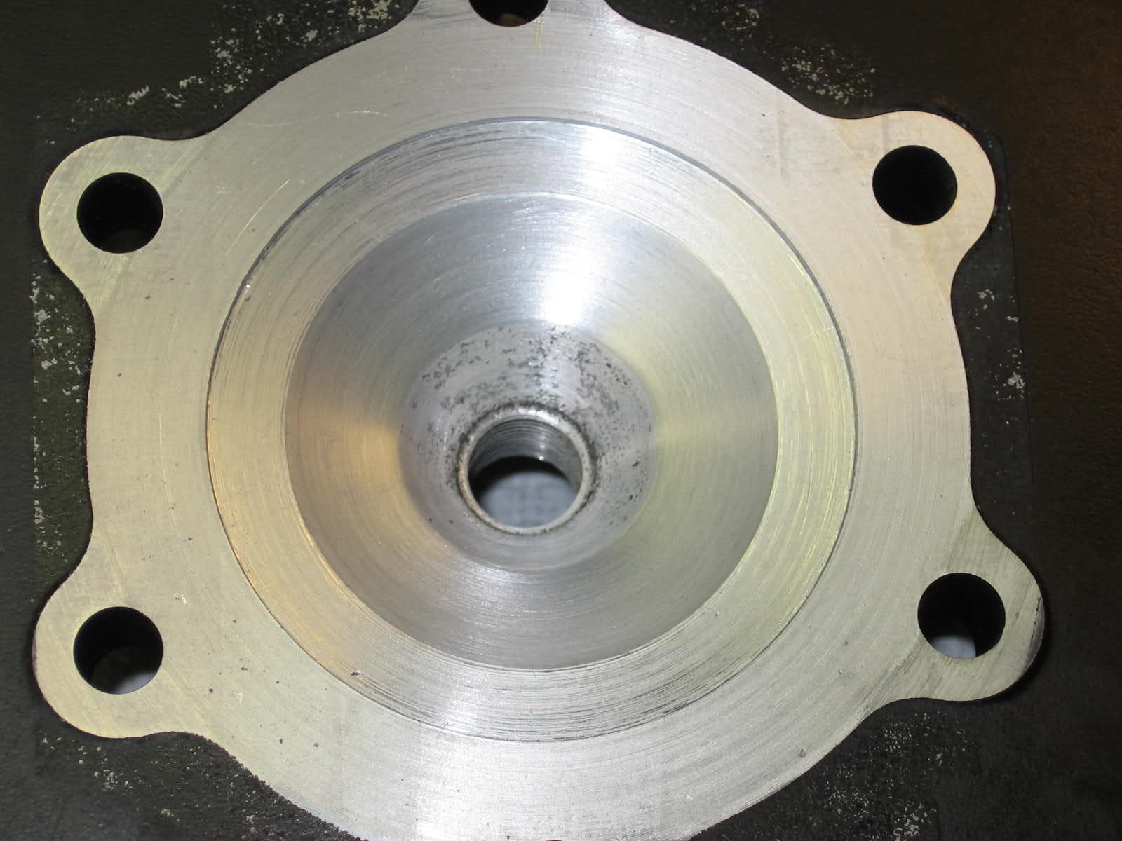

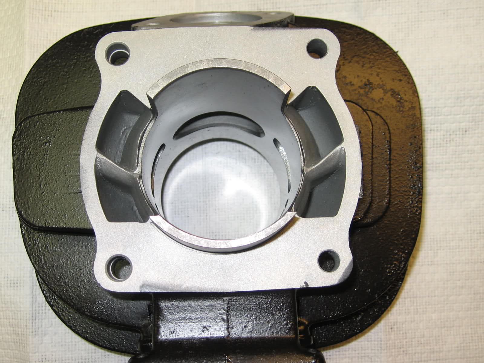

any how, today i took my blaster out for it's first run after putting my ported topend with all the goodies on. oh my god what a hell of a difference!!! this thing halls a$$ now. i raced my friends with modded 400ex and i waisted them. not even a close one. if you want BIG POWER i highly recommend having angus kennedy (kennedy_power) doing the work for you. even the carb was jetted just right. (for today) as for the shearer pipe....... i couldn't be happier. this thing sounds awesome and performs even better!!! so i now have a fmf fatty and power core 2 silencer for sale with flange. it will need a new rubber clamp and it is painted black however. $110 shipped obo LOWER 48 STATES ONLY. THANK YOU ANGUS FOR ALL THE GREAT WORK!
