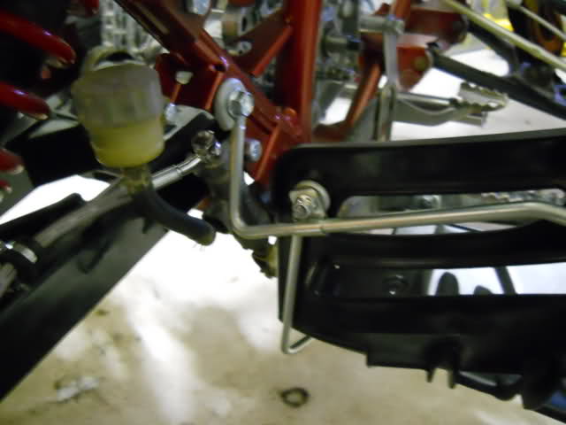

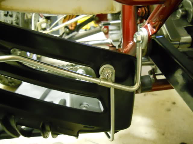

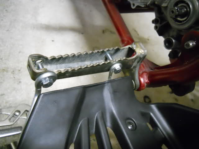

I've kinda been dreading doing these bc i thought it would be a total pain in the butt. but it only took me 30 min. I don't know why people make brackets for these you can just flip some of the brackets on the healguard over and bend the mounting rods a little and it bolts right up. i did this whole thing with two pairs of channle locks a screwdriver and a 13mm wrench.
if you have a set of yfz heal guards you can compare the pics. In this one you can see the top right bracket on the guard has been flipped upsidedown and the rod tweeked alitte
In this one you can see the mounts on the guard have been bent away from the quad to line up with the holes on the foot pegs. i also flipped the bracket on the outside mounting rod on the guard
In this one you can see i cut the plastic on the guard alittle to clear the brake and did the same thing as the other side on the mounting stuff
