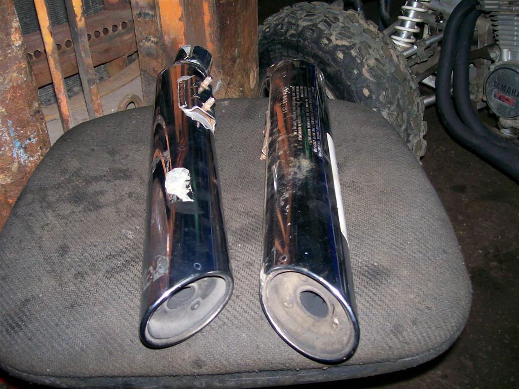

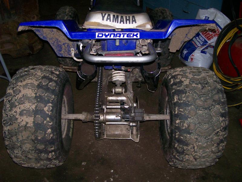

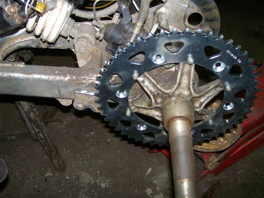

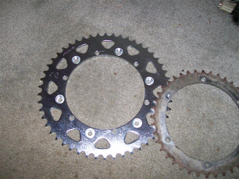

I did some more work over the weekend. Got the 15 tooth front sprocket installed. I also have the option of running trail legal pipes now. The pipes REALLY quiet it down. I have both before and after videos of the sound.
D&D pipes with the new header design:
Trail legal pipes:

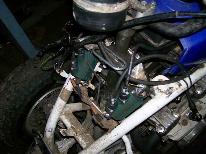

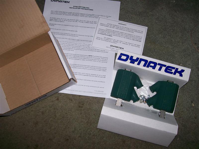

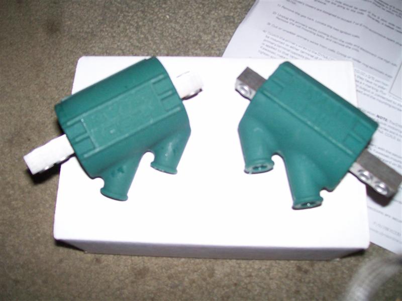

I found out that my stock coils had cracks in them. My new replacement coils showed up today. Dynatek DC1-1s. I'll post some install pictures this weekend.
Got the new coils installed. I went for the easy mockup/install. I Used two nuts to lock bolts onto each end of the coil. I then held the coil up to the frame and tacked them on. Last. I unbolted the coils and finished welding the bolts to the frame.

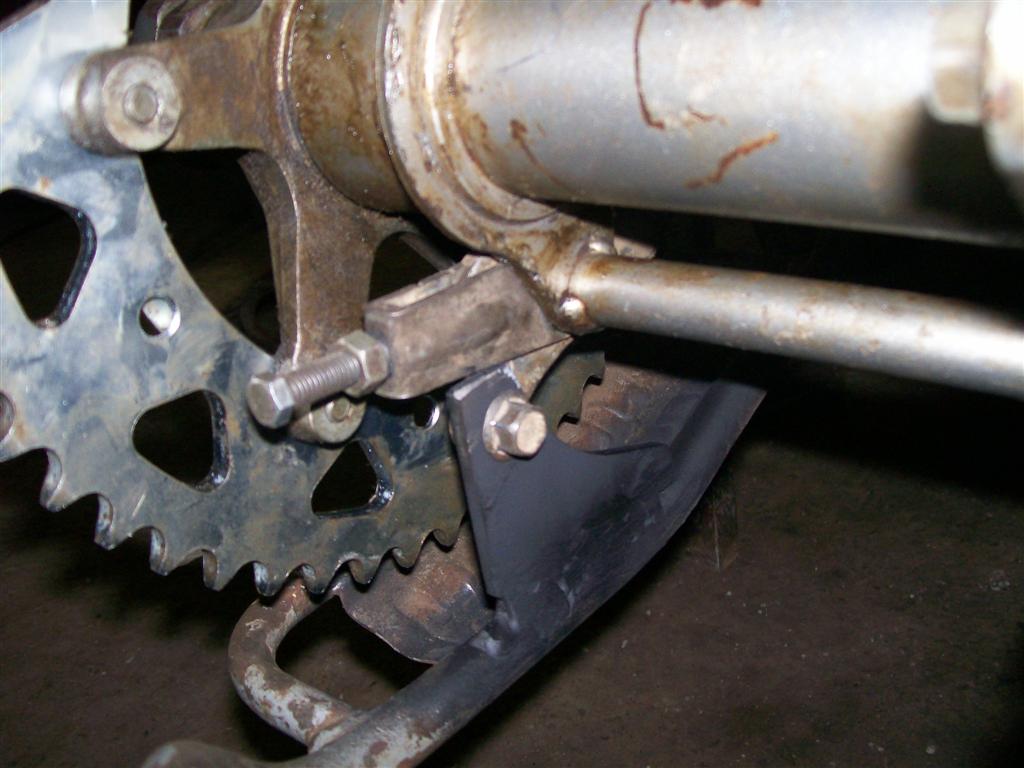

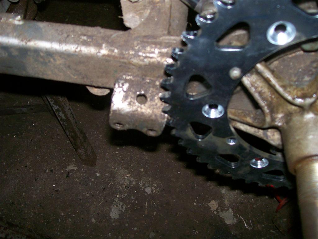

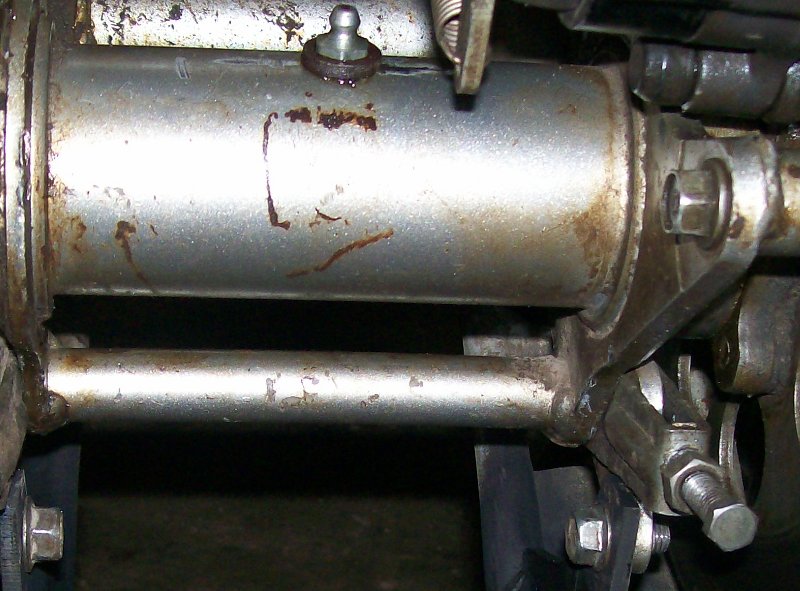

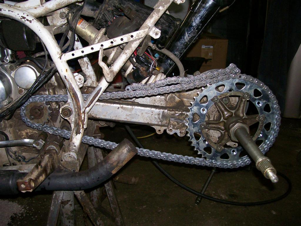

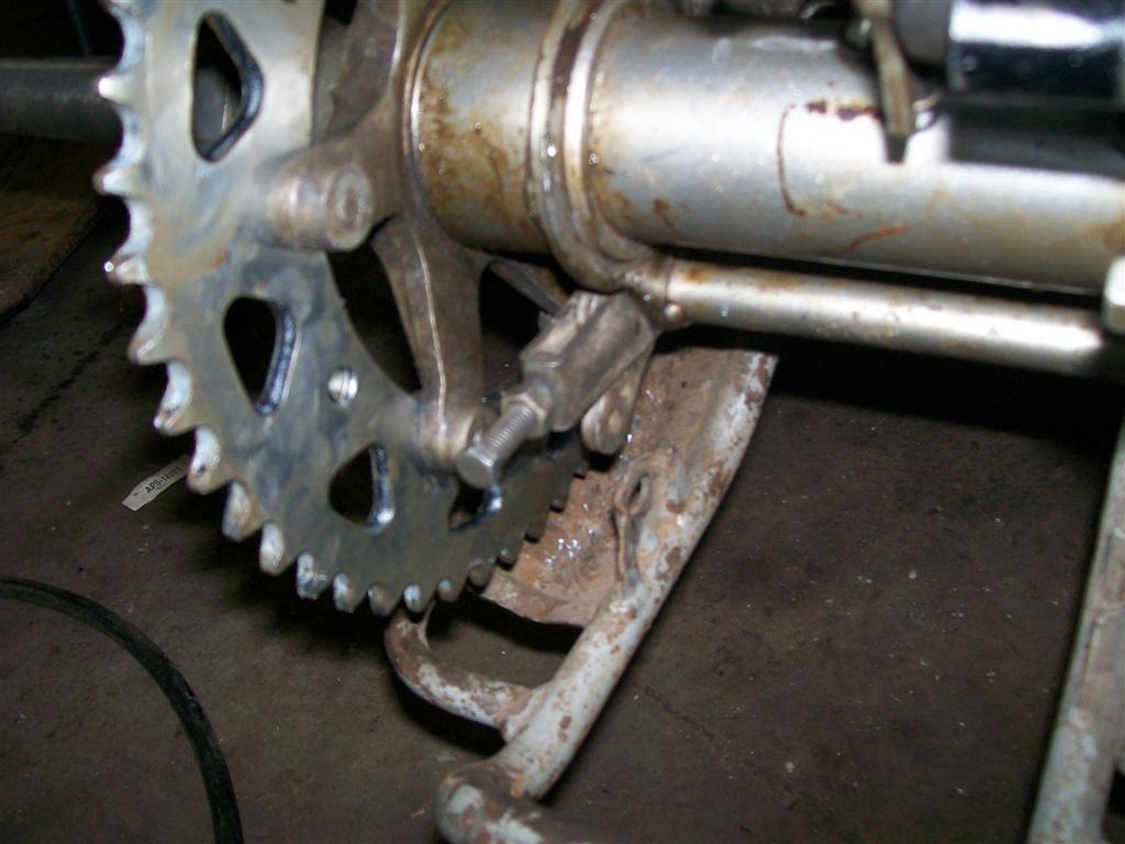

I got the rear skid plate fixed up this afternoon. I started with a stock skid plate.

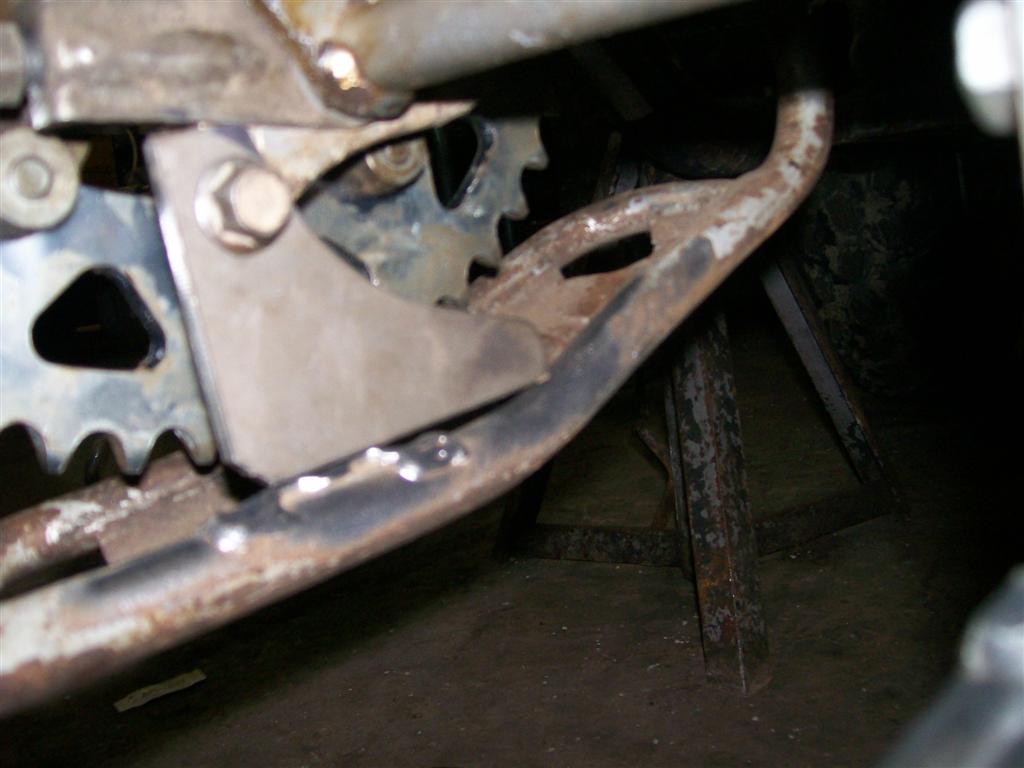

As you can see, it did not clear the new sprocket:
Here is the amount of space I would need to clear the sprocket+chain:

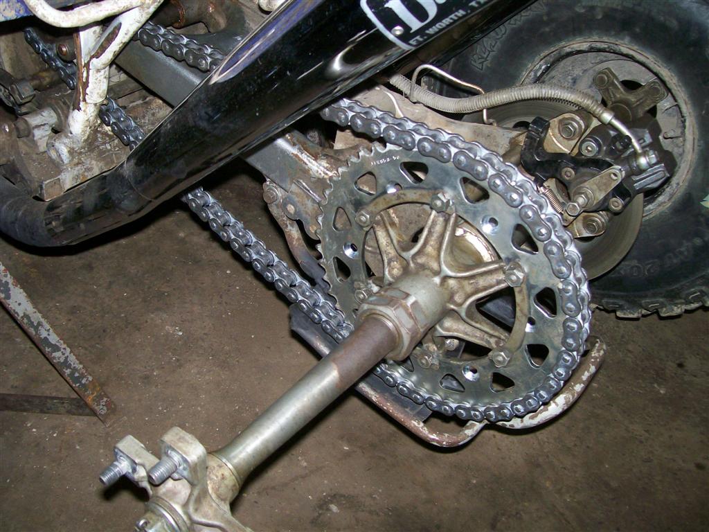

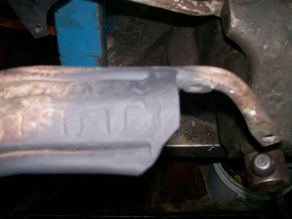

I keep a selection of gussets around just for quick little projects like this. I used one on each side:
Welded it all up:

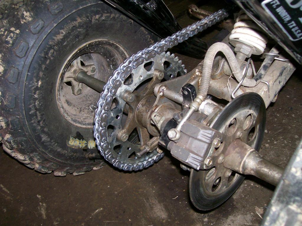

Now lets install the chain.......opps

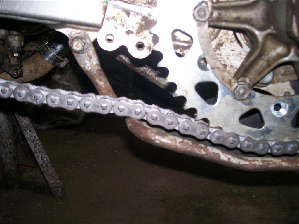

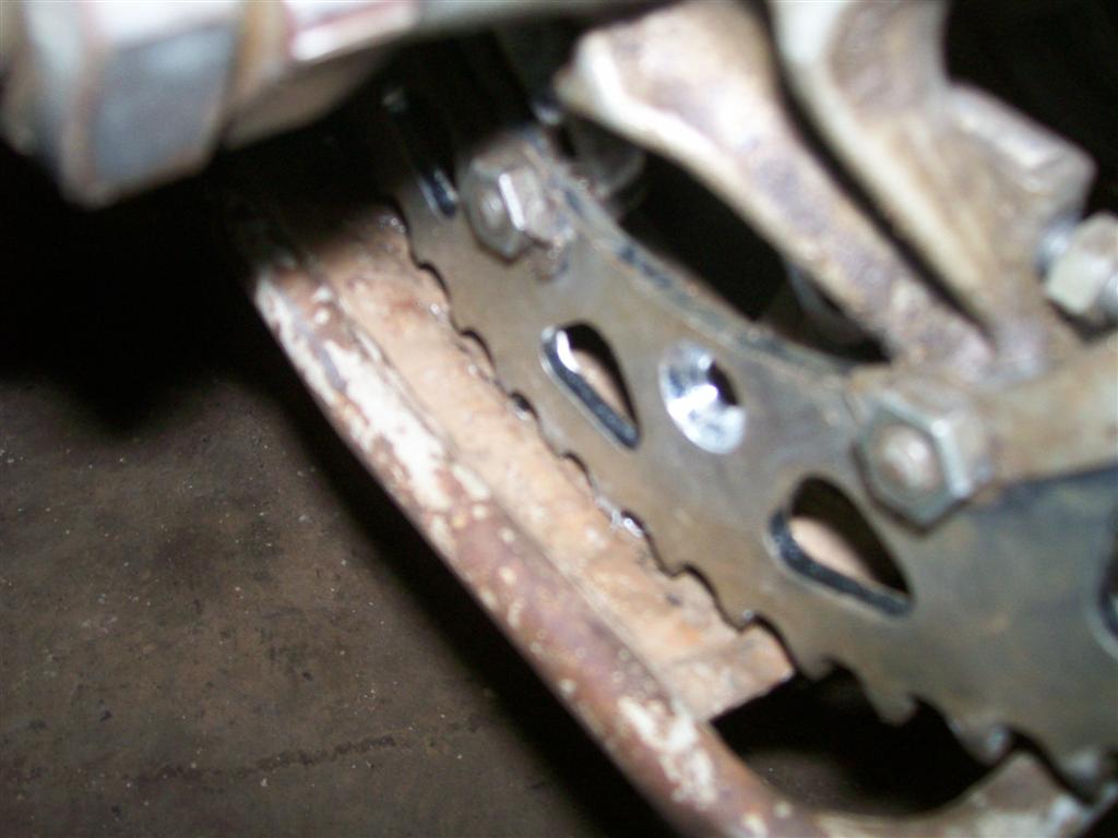

I cut the round bar out. Added a section of plate to help keep it strong:
Clears the chain now:
