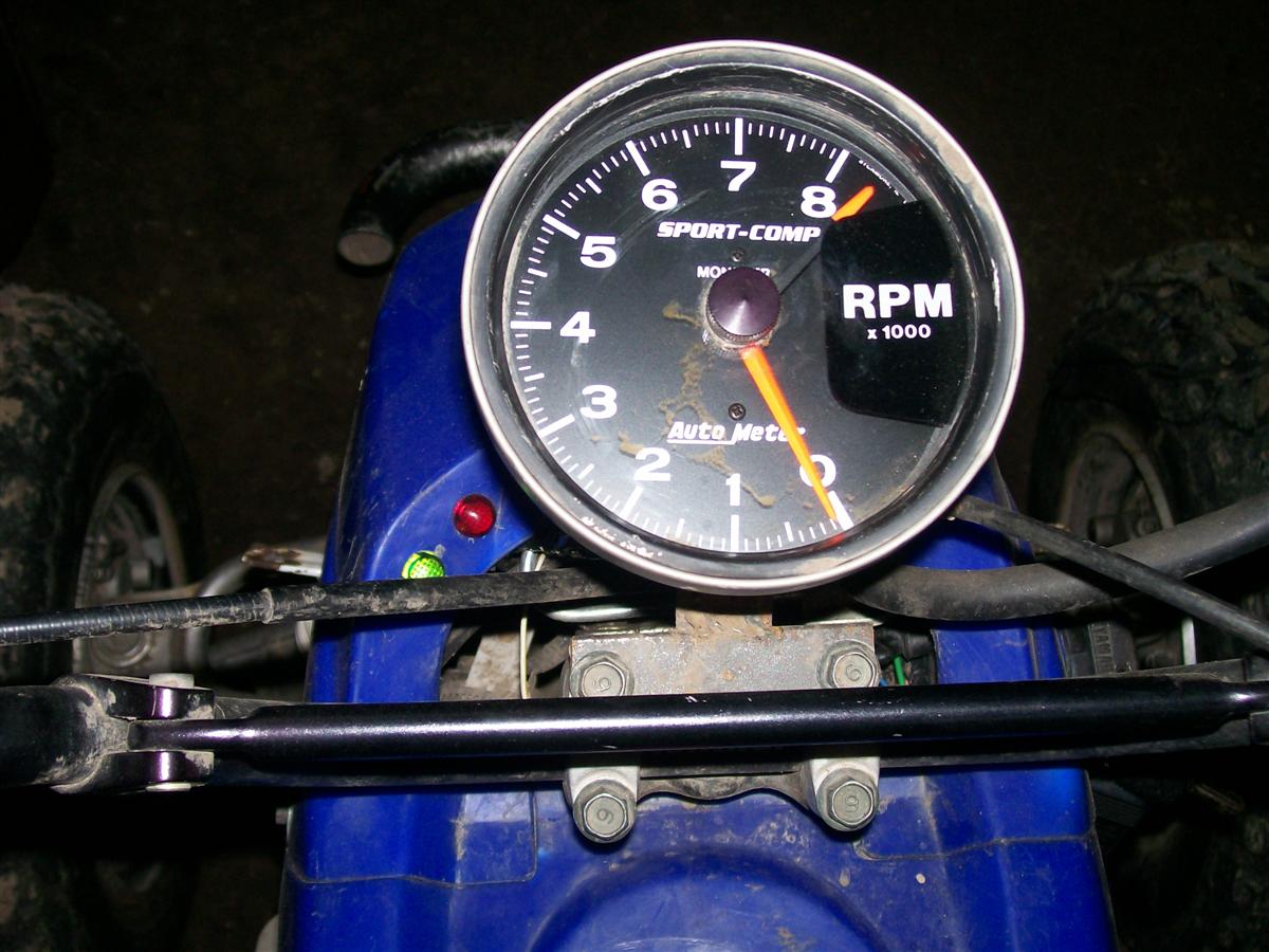

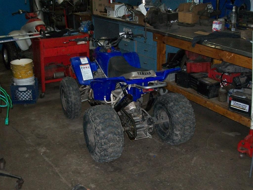

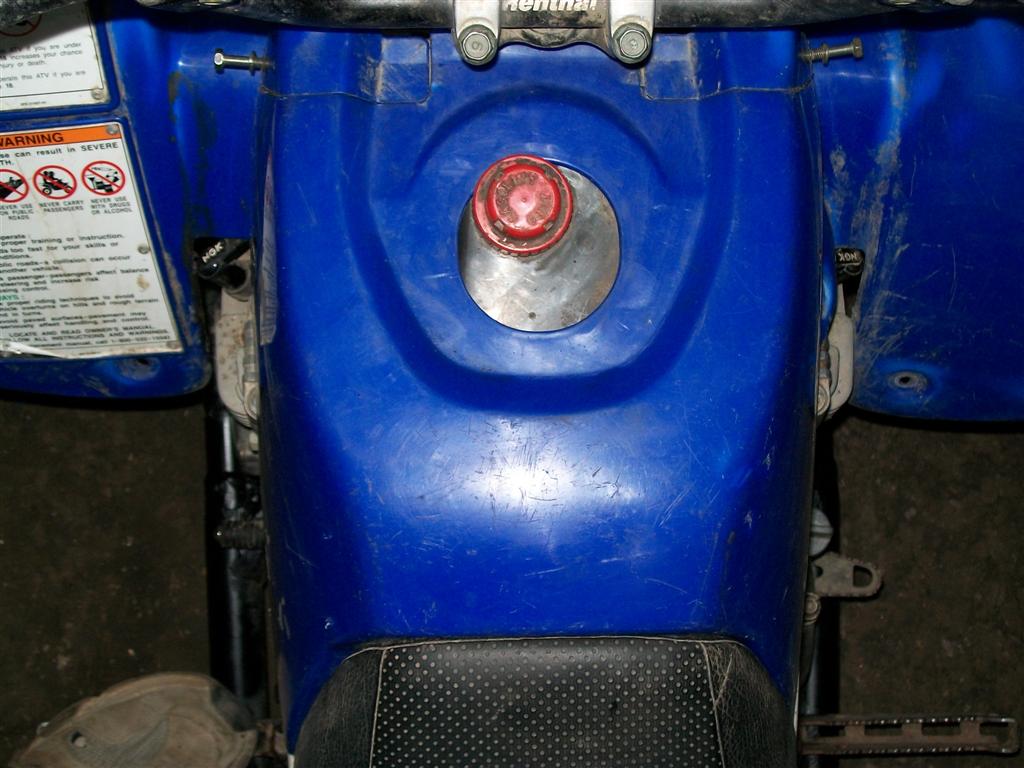

I found a tank to mount under the plastics. It will work perfect until I can finish making the real tank. I also switched to a igniton key off a Yamaha snowmbile. It works just like a key on a car.. one click forward for on.. hold forward to start. I'll have to come up with a plan for the tach and dash lights tomorrow. I have a top view picture that shows just how well that 550 fits in the frame..

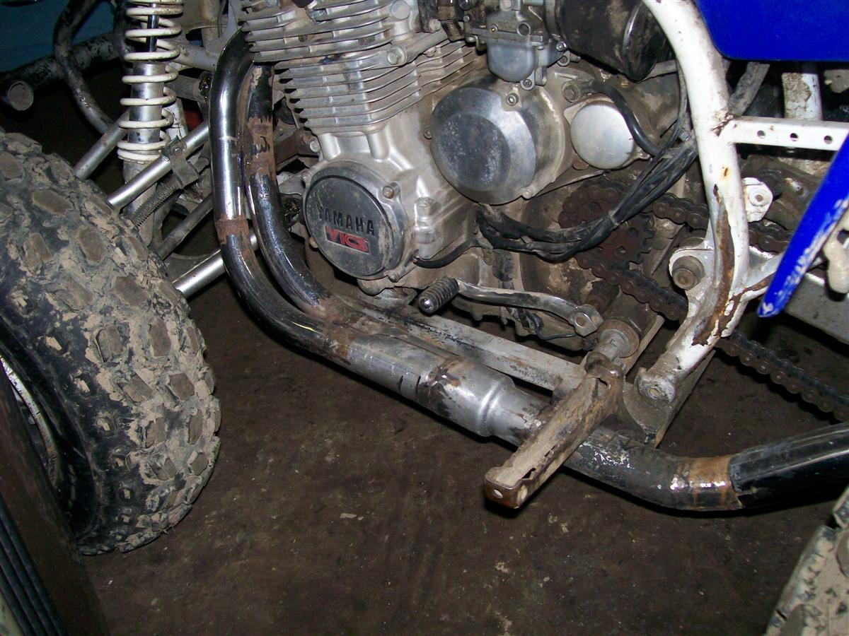

Pipes are bolted up to the frame. No more wire holding them on.

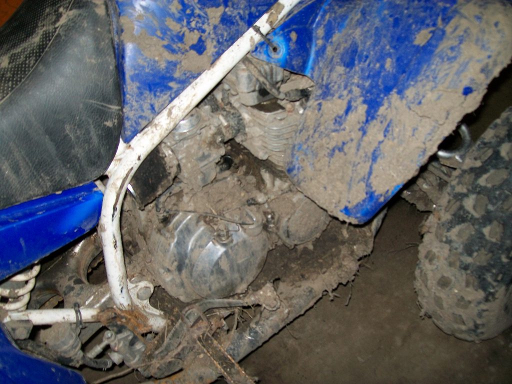

Under $700 total. I was traded a blown 2004 blaster for some motorcycle repair.. After some inspection I knew it would need a crank, piston, and a re-bore. I also found a small crack in the crank case. With that in mind I called up a buddy of mine that had an old 1989 blaster frame sitting in his back yard... so I had nothing to lose. I kept the 2004 frame as-in and used the 89 frame for my motor swap.

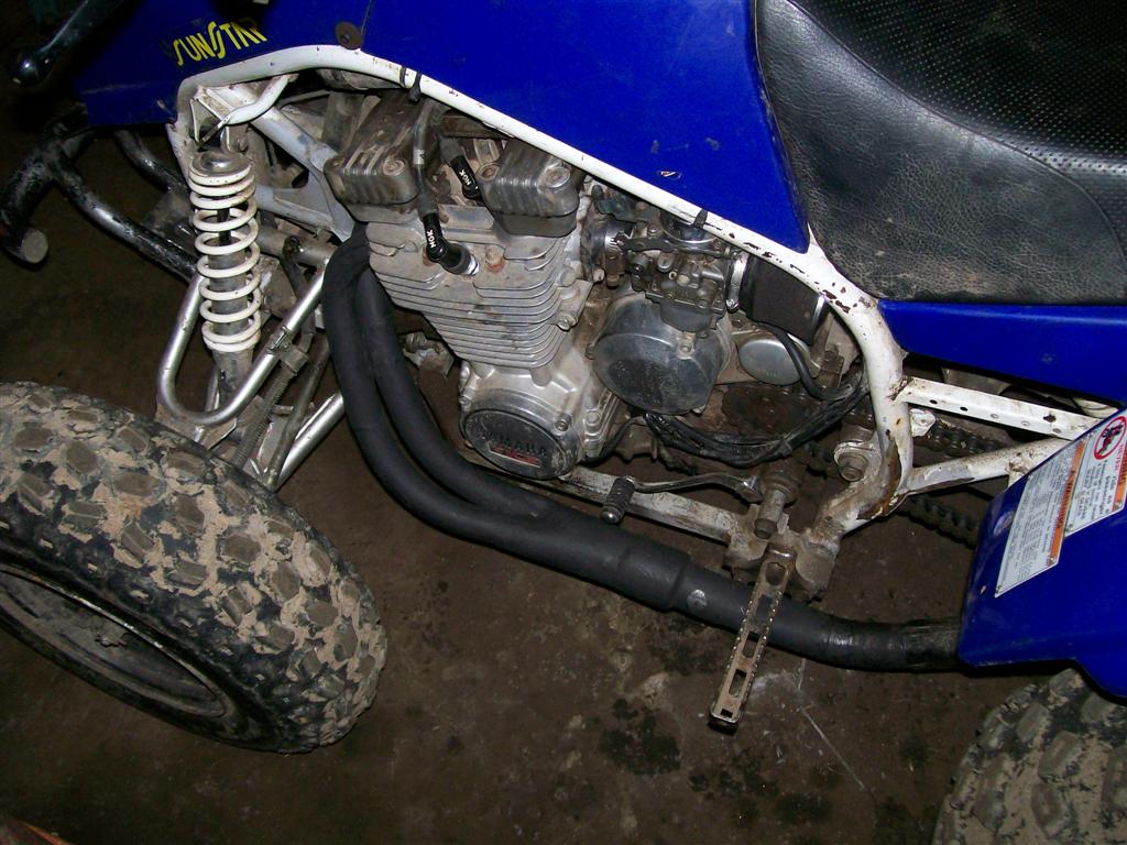

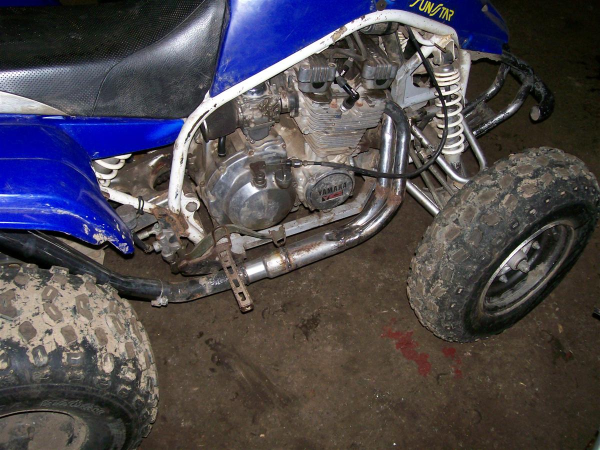

Okay.. its been a few months since I made any real build updates. Over winter I started making new collectors for the exhaust pipes.
My old setup was kind of restrictive for the inside cylinders: The outside cylinders had stright pipes that went to the rear of the ATV. (One on each side of the ATV Cyl 1-2 3-4) The inside headers flowed into this pipe via a 60-80 degree angle (not the best).

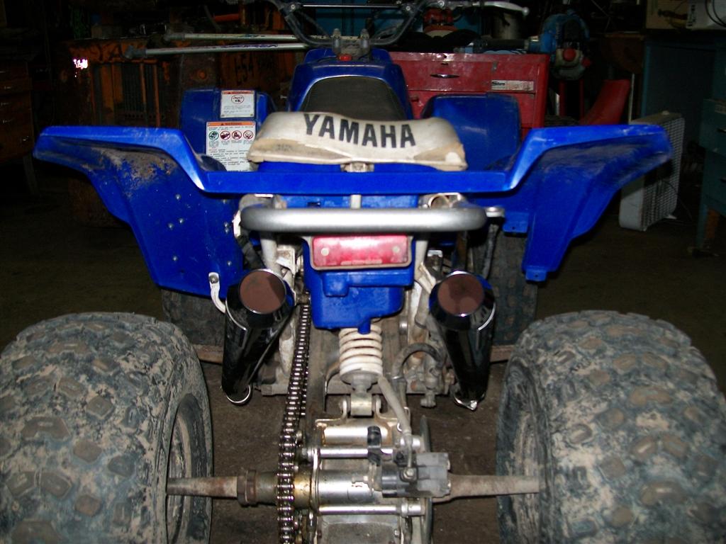

With the new setup both the inside and outside headers flow directly into 3 inch pipes that were crushed into an oval shape to take the headers. That pipe is then is reduced down. I'm still using the D&D megaphones for (un)mufflers I'll take a few pictures of them tonight. Also, the new collectors gave it a deeper sounding idle.
In the theme of keeping the blaster looking simple, I also added new natural and oil lights. (they are below the tach at around 3k rpm)
Here are some pictures of the new pipe setup.

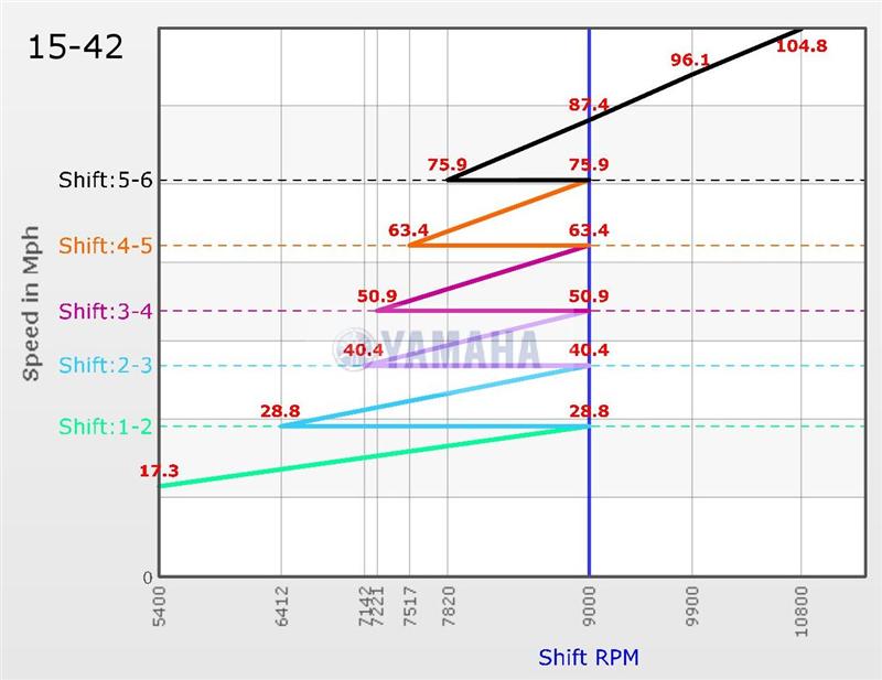

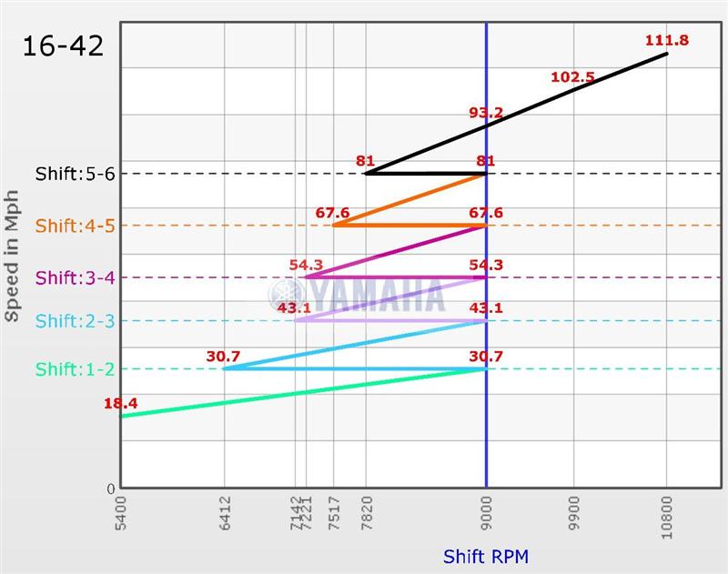

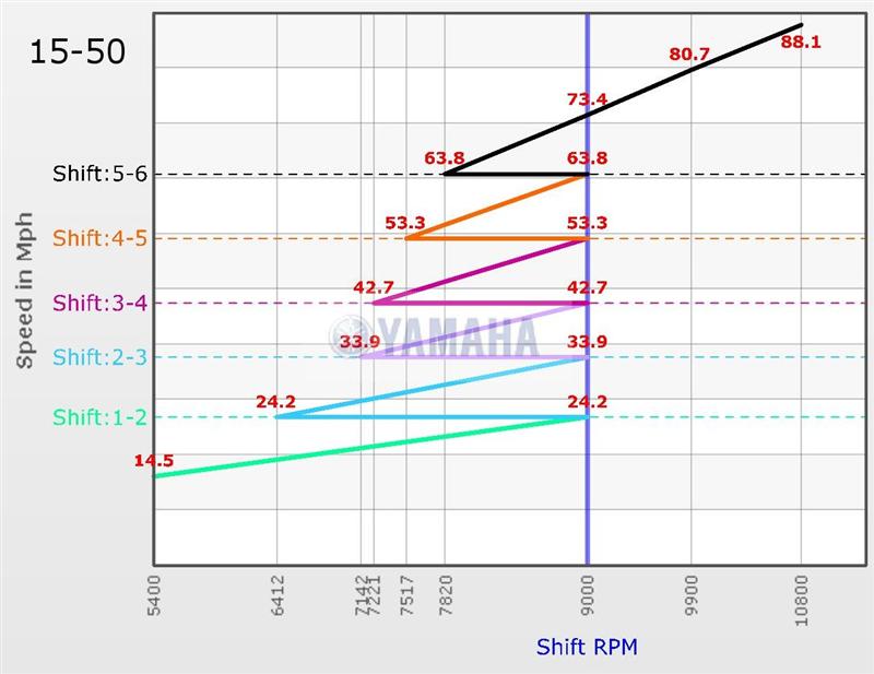

Time for some new gearing.

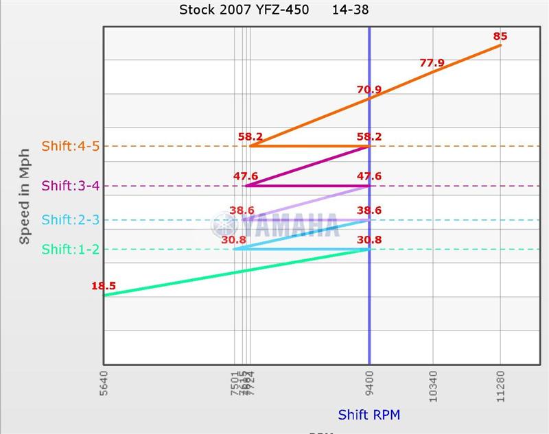

The gearing I used for the first few weeks was a 16 tooth front and 40 rear. I switched to 16-42 late last year. The gearing is still way too high. It took a while but I was able to source a 15 tooth front sprocket for my motor. It should be here by Friday. Below are some graphs of my gearing. 16-42, 15-42, 15-50. The last graph is of a stock YFZ 450. Let me know what you think.

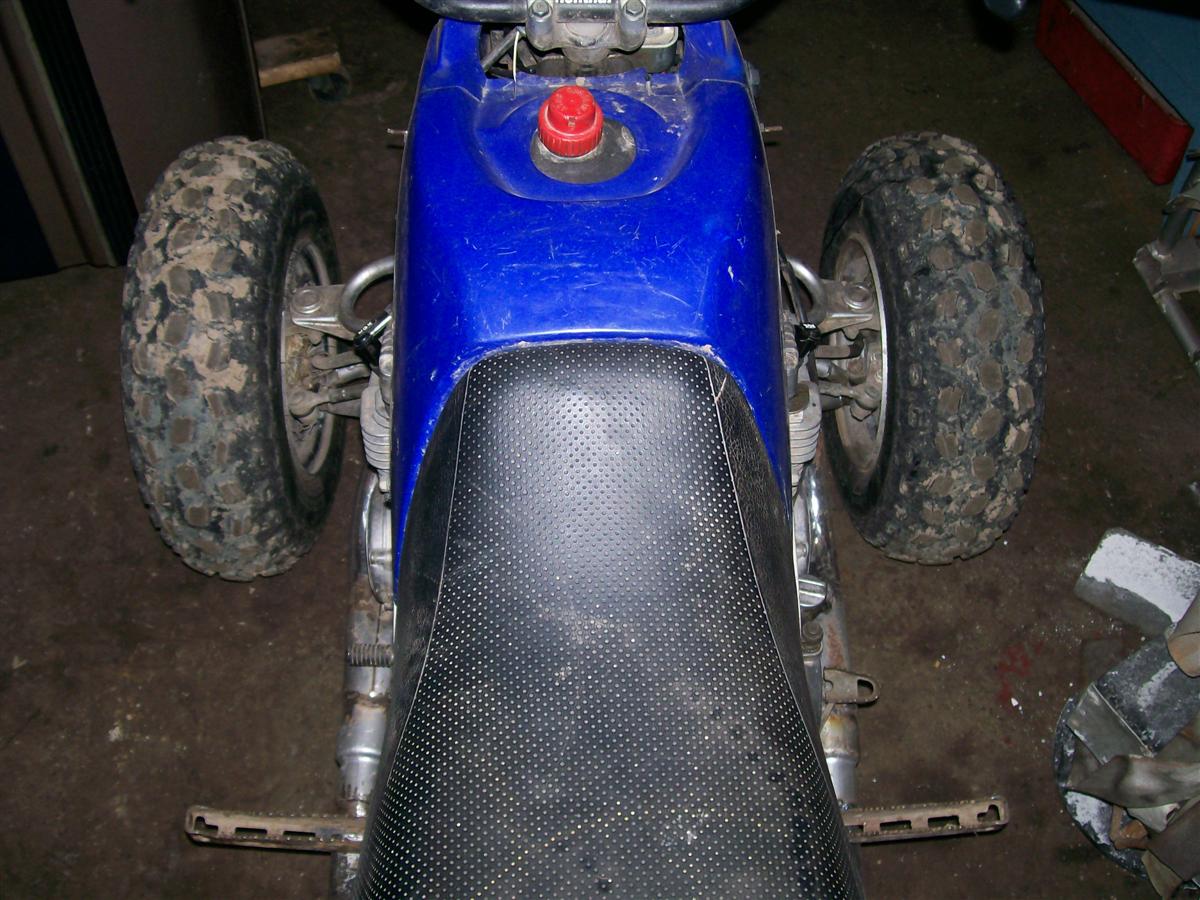

as for the seat.. the quad was sitting in a yard for 3 years when I saved it. I might buy a seat cover for it soon.
